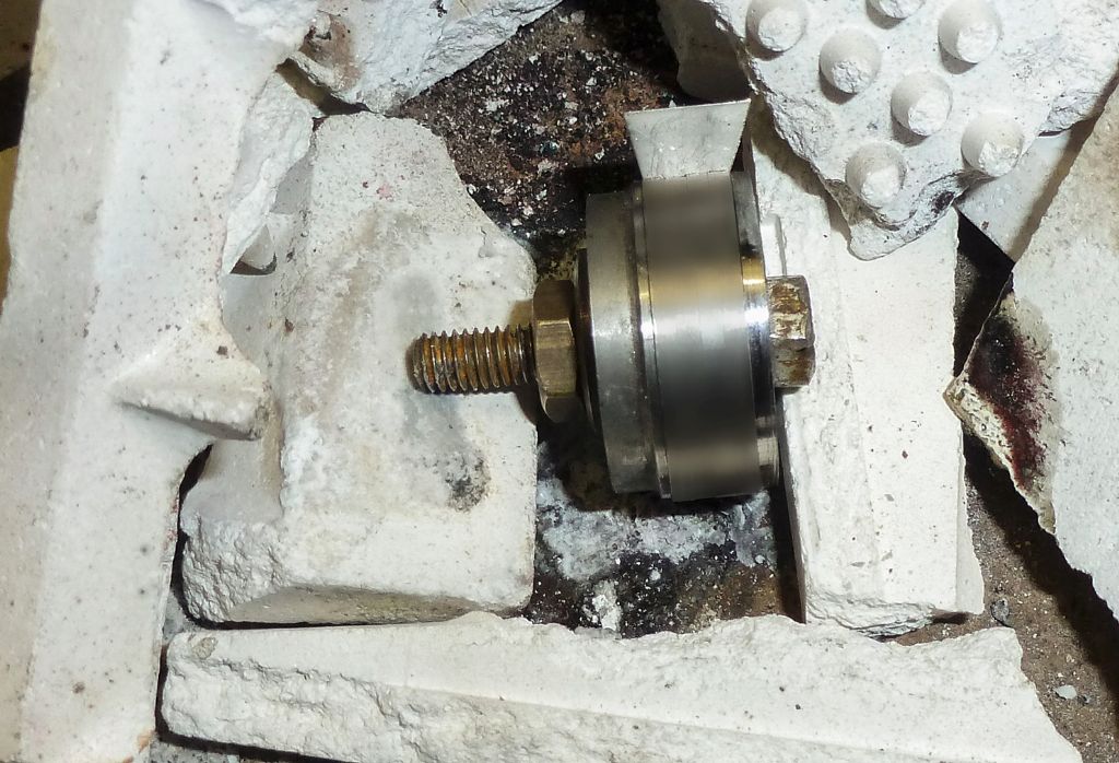

                                  Fowlers Fury
                                    @fowlersfury
                                    Emgee ~ thanks for posting that link, it is to the article I referred to above – but couldn't now locate its source.
                                    My latest rings were made for the HP valve chamber and thus smaller in size than those for the main (5" scale) cylinders. As, NDIY comments, the rings take a set at the "right" temp. I over-heated the first batch and half snapped as they were gently spread over the valve bobbin. With the pyrometer, the 2nd batch were gently raised to about 500C and allowed to cool amongst the fire bricks. The pre-cut gaps of 2 thou were held apart in the clamp – as below before being covered with the 'fire bricks'. The 4 rings were then sprung over the bobbin without a problem.
