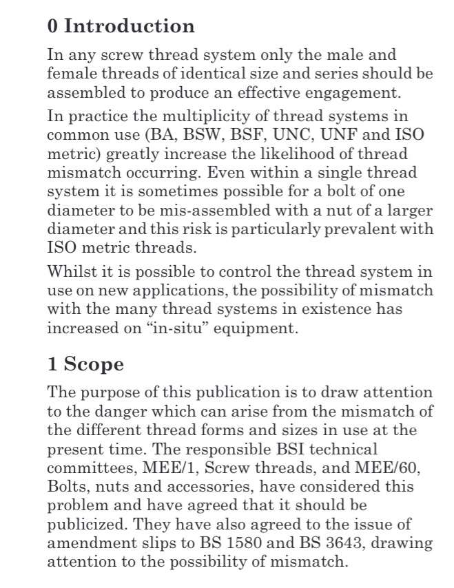

                                  I am truly sorry, Bill … but I am not at liberty to share PD 6494
                                  … I will however quote the introductory text, on the principle of ‘fair use’
                                  source Right
