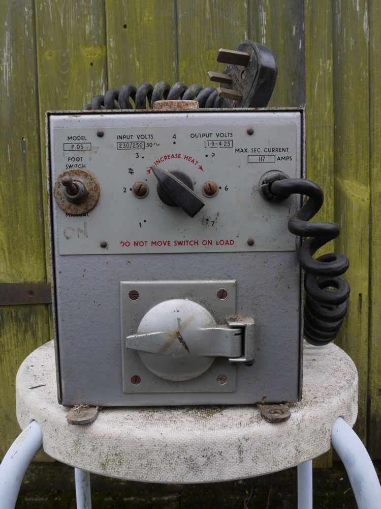

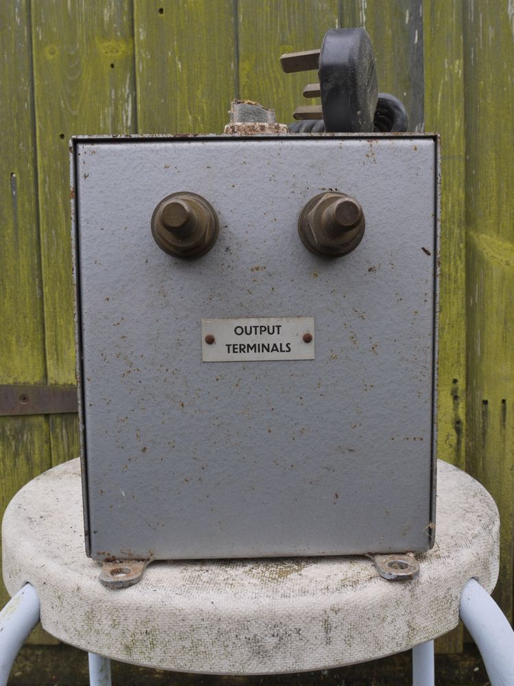

                                        #175043
                                          Just dug my transformer out of the garden shed blush
                                          … they both need a bit of cosmetic attention.
                                          Note the current rating, and the 7/16" diameter output terminals.
                                          Model Number is P.05 … but I can't find a Manufacturer's name.

                                            #175083
                                              Cripes Michael,
                                              You could probably use that as an arc welder on 25V…
                                              #175086
                                              michael howarth 1
                                                @michaelhowarth1
                                                MichaelG……that site is an excellent find and I have just printed it to read at leisure. Did you see the comment by a contributor regarding the use of carbon pads on the tweezers instead of stainless steel or whatever. I have seen a pair of tweezers made with carbon pads and for what I do ( small scale loco building) they would appear to be very useful.
                                                Mick
                                                #175089
                                                Versaboss
                                                  @versaboss
                                                  I read it as 4.25 Volts max. , but it would be ok for a spot welder I suppose…
                                                  Kind regards, HansR.
                                                  #175090
                                                    Ah! Missed that all-important decimal point.
