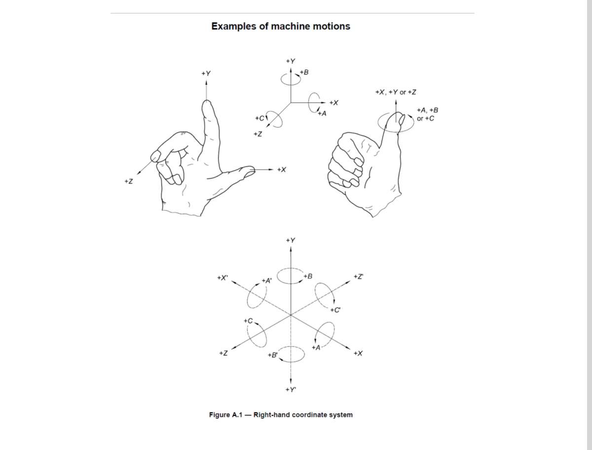

                1. Nigel answering your question regarding rotary axes, a rotary axis aligned along the x axis, as you would put a dividing head etc on your manual machine is designated A, swivel the machines vertical head clockwise and anticlockwise and this is B axis

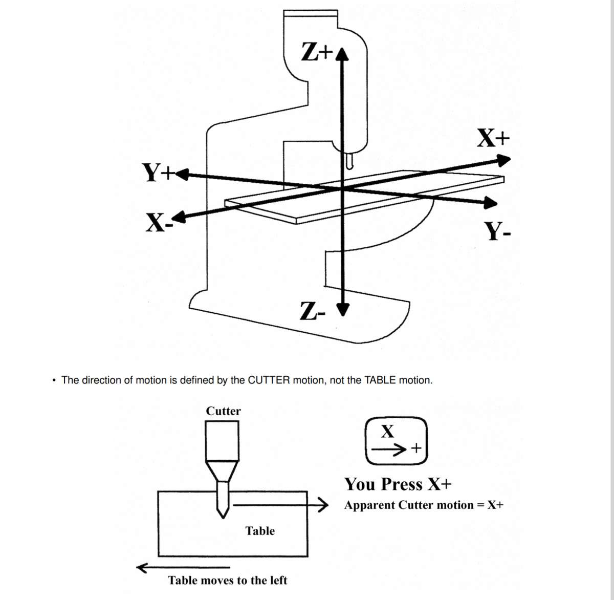

                        #773715
                          I’ve had this tucked-away for reference
                          Today is probably the time to share it
                          It doesn’t answer Nigel’s opening question … because the answer to that is
                          “it’s a matter of choice”
                          … but it does properly define the relationship of the six axes:
                          IMG_8697

                            Michael’s little picture also illustrates another common convention – when you see the little XYZ axis diagram on a CAD screen, they generally seem to be colour-coded so that RGB maps to XYZ. Useful to remember when the letters are too small to read!
                            Setting up a DRO for the first time can confuse – it’s the business of table moving left versus tool moving right. Get it wrong on a manual mill in your own workshop and you can probably live with it. Get it wrong setting up a CNC mill and you will be out of step with every CAD/CAM package on the planet!

                              Michael’s diagram is my starting point; same as SpeedyBuilder’s definition, except Speedy’s version is simplified and easier to remember, hurrah!

                                    Another couple of diagrams for you:-
                                    RH Rule
                                    Cutter Motion

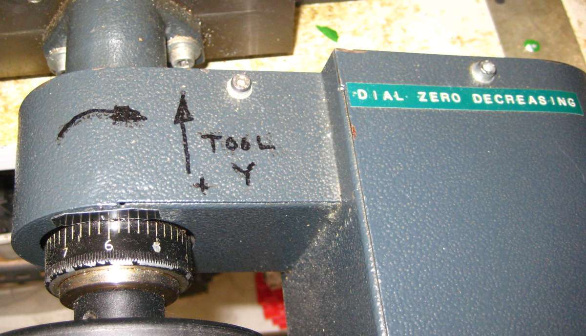

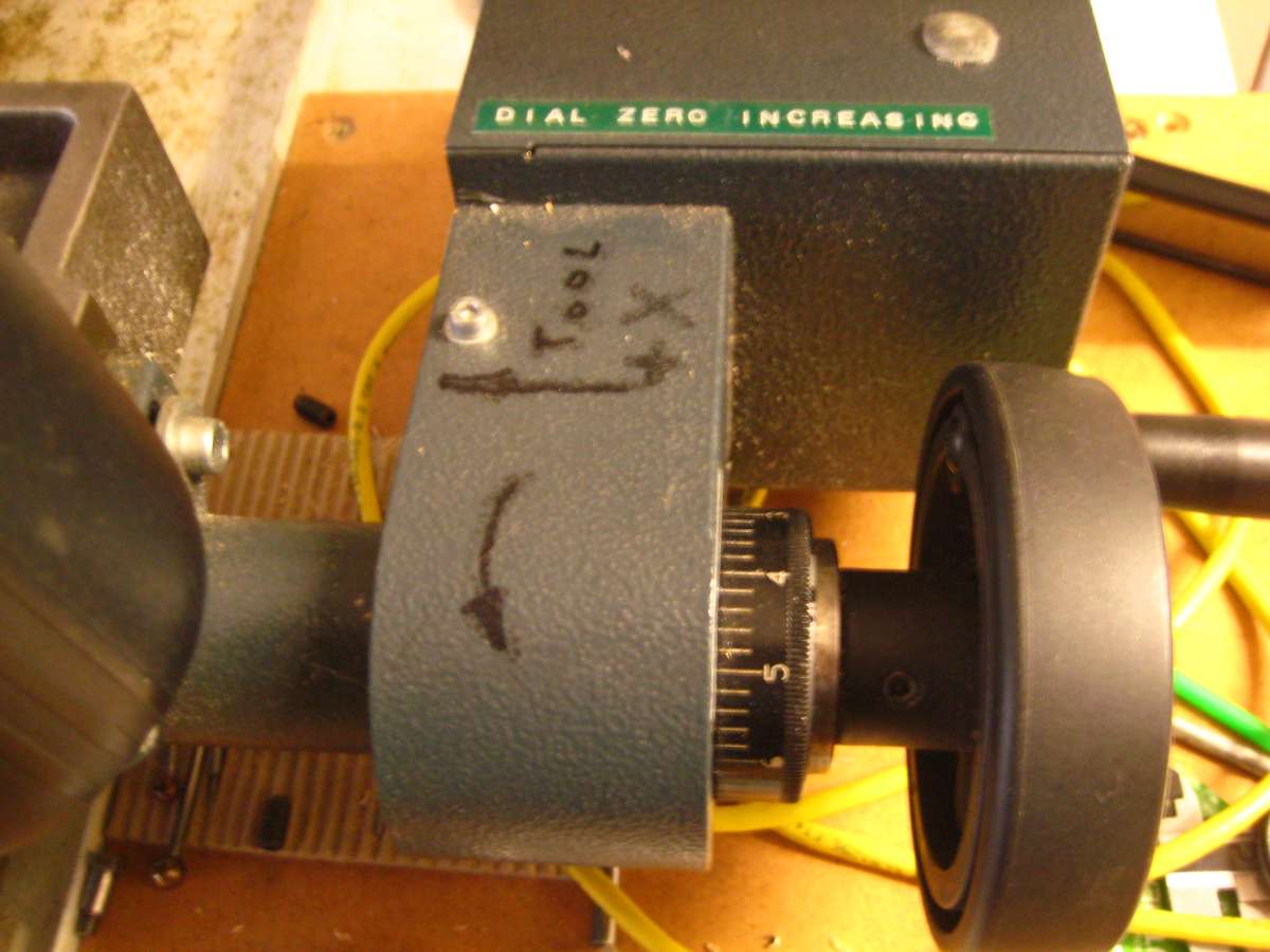

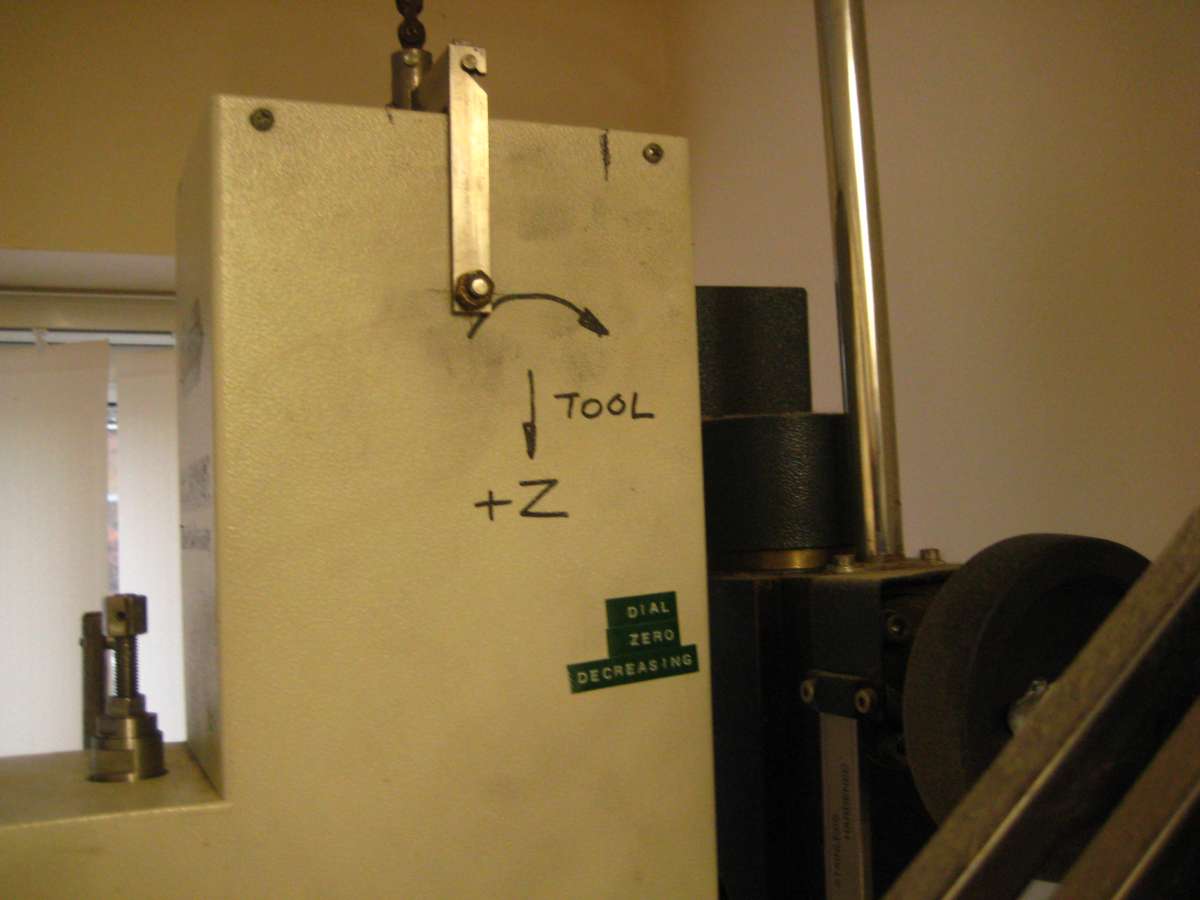

                                      I’m not only confused about which way is up, I can do it with left & right and away & towards. After several sticky moments not being sure which way to go I marked up my machine so that I could check twice and cut once. In my case not helped by my Y travel being opposite to that on most machines.
                                      This is the first time I have attempted posting photos on the new forum and it’s a case of being easy when you know how. But because I didn’t know how it’s taken me all afternoon to do it; surely something more that just “click the photo ikon” in the “how to” section could be risked. Just pointing out the presence of the little draggable squares in the corner of the image could have saved me hours of frustration.
