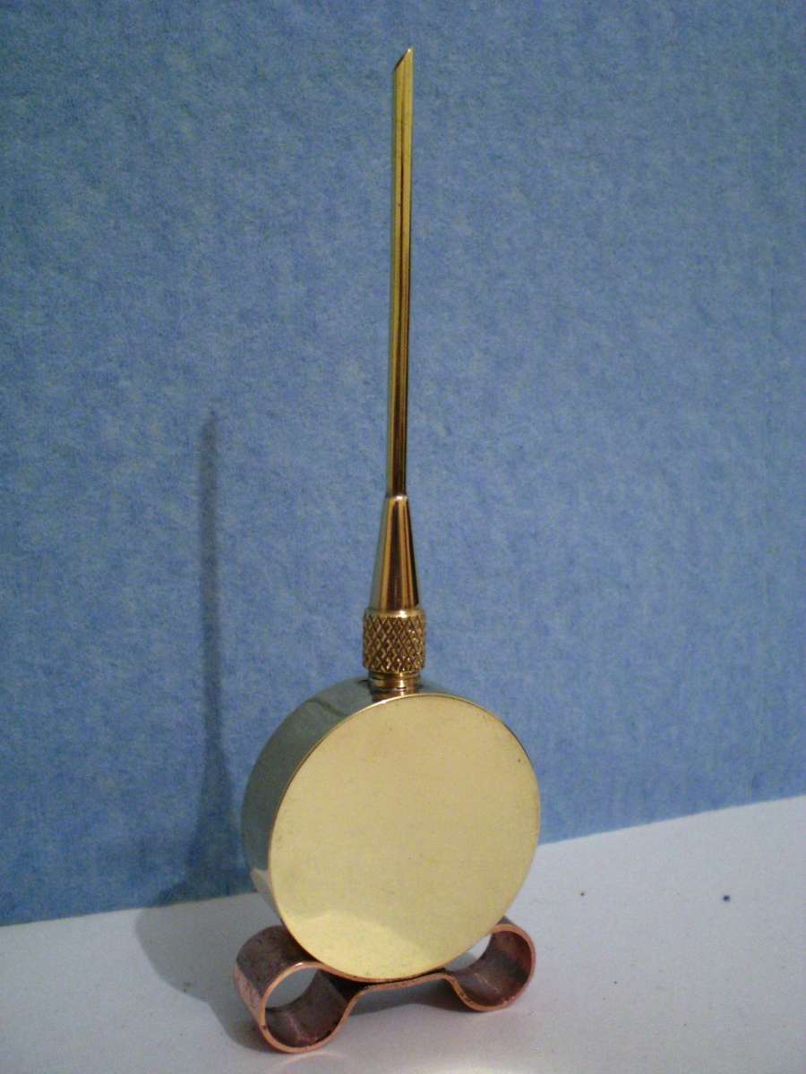

                  #738560
                  Nicholas Farr
                    @nicholasfarr14254
                    Hi, you can always make one to suite your needs, I made this one, which was along the lines of Morgens Klide’s design, which was published in MEW 220. You could make one a bit larger and even make different spouts to get to the awkward places.
                    Oiler
                    I actually made two, one of which is a show piece, and the other one I use.
                    Regards Nick.
