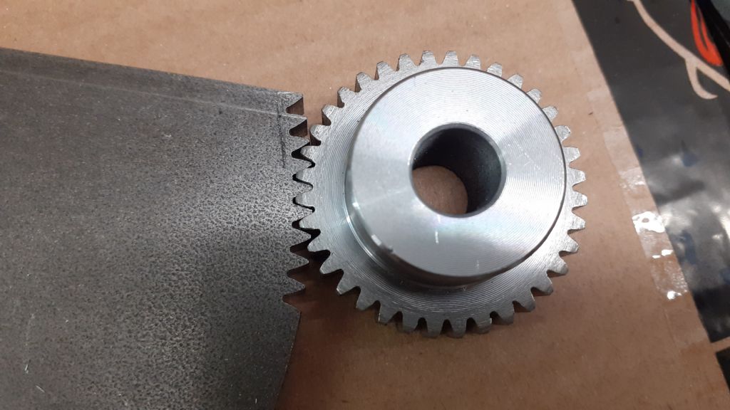

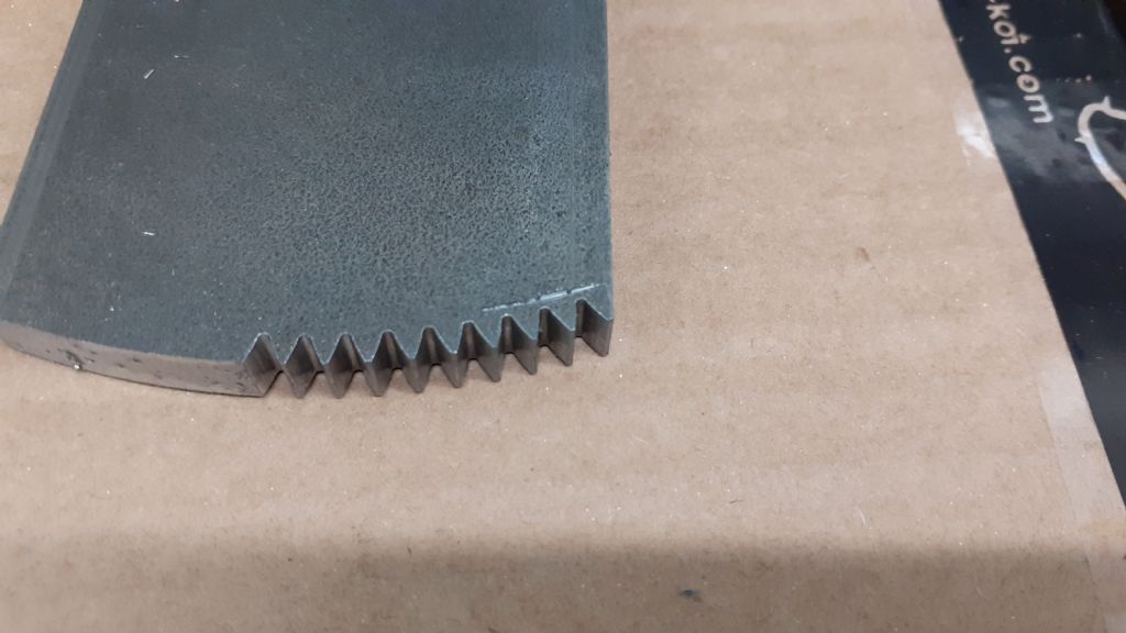

      Jason, the OP asked what tooth counts and materials I was using. If you profile the gears out of flat plate or on the end of a bar the limits are the usable width of the table (max diameter) and minimum usable size of cutter (minimum modulus). Bigger teeth aren't a problem even for a light mill since the cut width is (say) 1mm and depth 0.25mm even cutting a large tooth. Only feasible with CNC, Christopher is already using CNC on a router and apparently making gears this way.

          Posted by John Haine on 19/11/2021 13:49:22:

            The cut gear resting on the nose of the collet chuck, a piece of paper below it would have helped you identify it.

              Sorry John, could not see anywhere wherte the OP asked what size gears you were cutting, I know he has a CNC router I suggested he use that if not metal before you tried to suggest he buy one
              As to what is in John's picture this is similar to a gear being held on an arbout in turn held by an ER collet

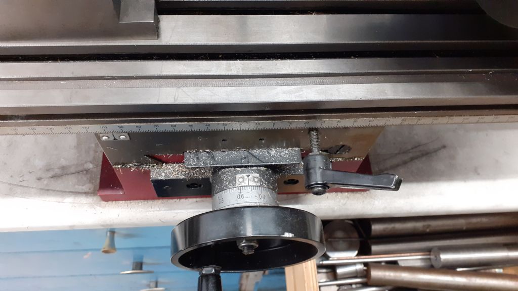

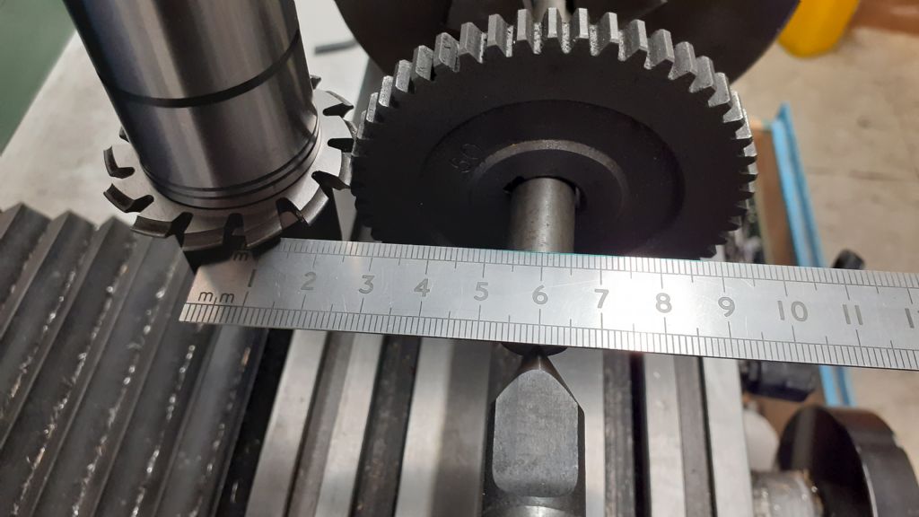

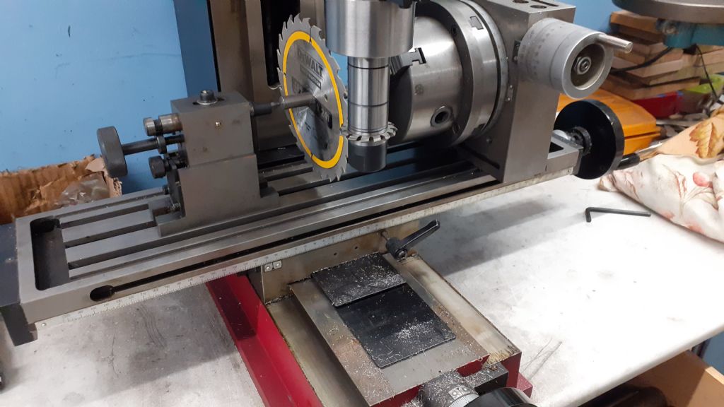

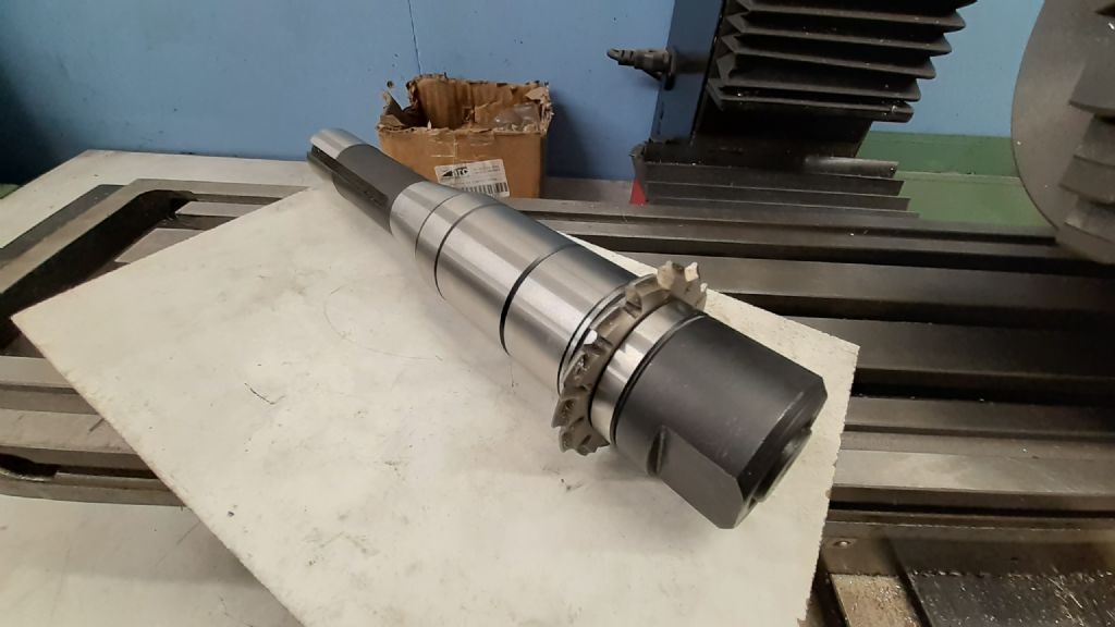

                Some pleasant surprises on the SX2.7 mill, but first
                This is a 1MOD cutter mounted on a R8 shank milling arbour. One advantage with these is the overall diameter is smaller than a similar tooth size imperial cutter at 50mm vs 63mm so you gain a bit of room using metric.

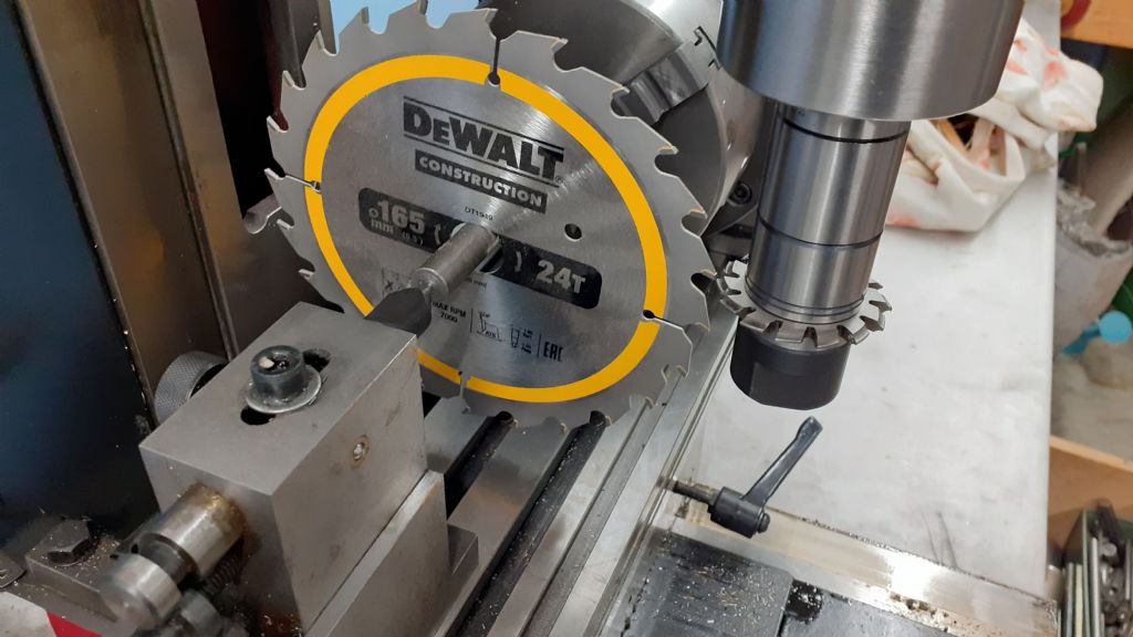

                Now the usual way most set up a rotary table and tailstock is to have the cutter behind the work and as I said this is going to limit the diameter of gear you can cut. here the gear is 78mm dia and you would be hard pushed to get much larger without hanging the rotary table off the mill's table.

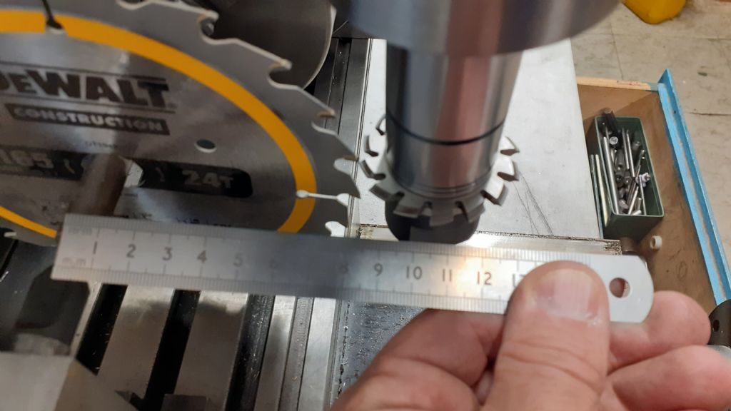

                This is as far forward as the table will go
                But then I remembered a conversation with Ketan at ARC about how far back some of teh Sieg mills tables will go so thought I would try it that way round. The protective bellows on the column are just retained at the bottom by magnets so can be slid up out the way to gain a bit more room too.
                I think you could probably manage 170mm dia gear blanks set up like this and still have the rotary table and tailstock lined up with the middle tee slot.
                If doing a gear of this size on the SX2.7 I think I would not use a single central arbour but instead bolt the blank to the rotary table with some suitable length spacers in a similar way to Andrew's photo as it will be a lot more rigid and no risk of the blank rotating on the arbour
                The SX2P being a bit smaller may manage 140-150mm dia and with moderate tooth size should cut the mustard. but would be worth checking the available table travel.

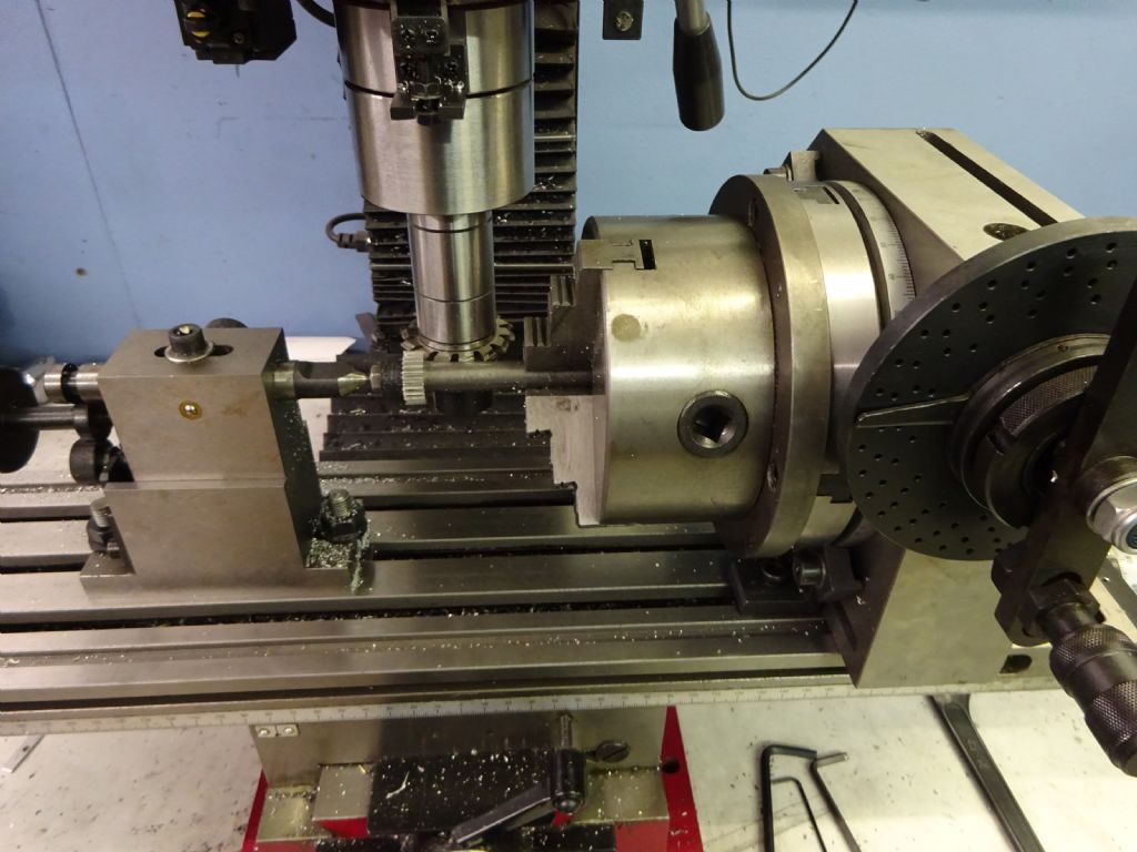

                            Is that any different to a rotary table with dividing plate? I did not bother to fit that as it would not have affected the measurements.
                            R/T also has the advantage on large dia gear like the OP wants to cut of providing a bigger surface to bolt the gear too and less overhang than a chuck and arbor
                            Pic of the R/T complete with indexing plates, quadrant, etc

                                            It is correct that the machine shown is ex-industrial, but it is a universal horizontal mill so does not have, or need, a horizontal attachment. Conversely I do have a horizontal attachment for my vertical mill:
                                            But I wouldn't normally use it for gear cutting as it is a bit wobbly.
                                            The horizontal mill shown has travels not that different from a SX2.7, 500mm in X and 200mm in Y, but it weighs about 15 times as much. I used the rotary table to cut the gear shown as the gear blank was too large to fit under arbor and cutter.

                                                    Well having said the SX2.7 could do it I thought I had better make sure or risk not being in Chris's good books.
                                                    Not wanting to waste a whole 6" circle of steel I just radiused the end of a piece of flat bar to use for the test. I thought O would use the ARC rotary table and 151T was a size that came up on the chart and about the middle of Chris's size requirement, the actual blank diameter being 153mm for 1MOD size teeth.
                                                    As I said earlier at this sort of diameter a single central arbor is asking for trouble so a proper gear would be best drilled 4 times like in Martin's photo and then bolted to the rotary table with some spacers so the cutter can run out and not cut the table. So the flat bar was bolted down with some 15-30-60 blocks as spacers.
                                                    I also made sure the R/T was fixed well with 4 clamps. On of the odd things with the ARC rotary tables is they mount on the right hand side of the table which did give me some issues of the quill spider handle hitting the R/T so I had more quill extended out of the head than I would have liked. Also at this cutting diameter the milling arbor fouled the dividing plate so I had to resort to handwheel divisions. I expect most will opt for a left hand mounting R/T which won't have the quill problems.
                                                    As I've said before the small vari speed mills are best run on the fast side for the cutter so I went with 260rpm. Full depth cut ( 2.25mm) so just one pass per tooth gap. The cheap cutter has seen better days and does not run particularly true and having to feed one handed while filming did not help but it cut an acceptable "gear" which could be done better once div plates set up and feeding with two hands.
                                                    I think this diameter and tooth size is about as big as the SX2.7 can be expected to handle without putting undue loads on it.
                                                    And meshed with a commercial gear
                                                    Not the best video but will give an idea of it cutting.

                                                      When you buy your Rotary Table, (A Horizontal / Vertical type hopefully ) do get the Tailstock with it, as well as the Division Plates..
                                                      In my case the Division Plates were bought after the R T (A Vertex HV6 now about 20 years old ) and last of all came a Tailstock.
                                                      With 20 / 20 hindsight, and more experience, buying everything at the same time would have been far better.
                                                      This eventually brought me to aligning the R T and the Tailstock. (The methods used were contained in an article in M E W, some time ago. ) It was time well spent, ensuring that the RT was aligned to the Tailstock and the Mill table, whilst the RT aligned the Tailstock with the centre at the correct height..
                                                      The Tailstock will support the arbor on which the gear blank is mounted, and will improve the rigidity which is ESSENTIAL in any machining or measuring operation.
                                                      Gashing the blank involves cut to the full depth of the teeth, so needs maximum rigidity.
                                                      Howard
