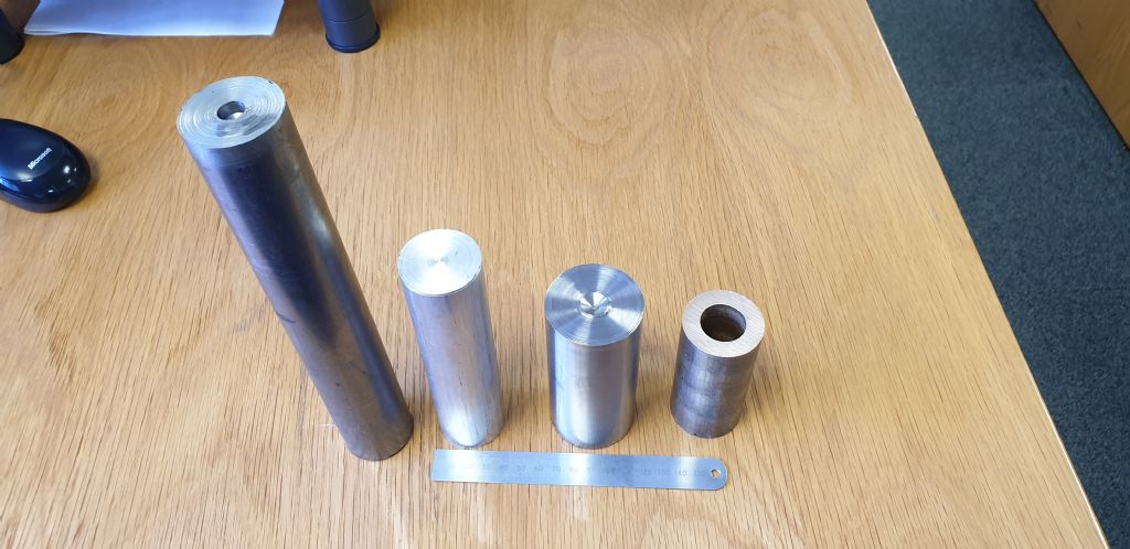

        #421025
        Ben Charlton
          @bencharlton53151
          "Ask and ye shall receive scrap metal!"
          Something like that anyways. Just been to the manufacturing department on a begging mission. Was given some decent lumps of (from left to right) mild st, Ali, 304 st/st and brass. Should be able to make some good swarf with those!

            Ron Laden
              @ronladen17547
              Well done Ben they will get you started and provide some practice, have you asked manufacturing to start a "Ben Box" i.e. save offcuts and ends for you, can never have enough material.

                  Posted by Ron Laden on 26/07/2019 14:12:30:
                  Not a bad idea but judging by the state of the scrap boxes I should be able to just grab the odd bit as I need it. There was a nice bit of 1/2" x 12" brass bar there though. Might need to acquire that.
