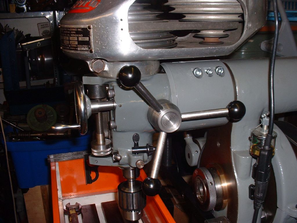

                                daveb
                                  @daveb17630
                                  #332187
                                  Danny Sanderson
                                    @dannysanderson39808
                                    Yes, sounds similar though your collar looks much more shallow.
