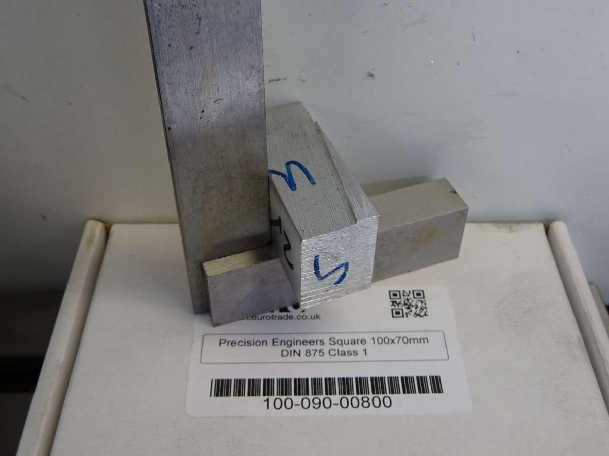

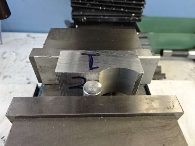

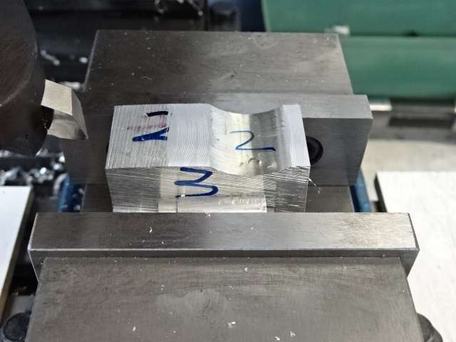

      To square up a block of stock the rear fixed jaw is the ref surface so the bottom of the vice should not come into it.
      Machine first face No1
      Photo 74
      Then rotate so face No1 is against fixed jaw and machine No2.
      Photo 76
      If fixed jaw is true the corner between N01 and N02 will be 90deg

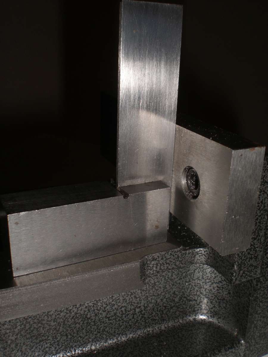

        Hi JasonB, yes I’m aware of that procedure, however, my back jaw is square to the bottom of the vice, the accuracy test for these vices gives a parallelism of 0.03mm on a length of 100mm, between the bottom of the vice, and the base, and a perpendicularity of 0.05mm on a length of 100mm of both jaws to the bottom of the vice, therefore, if the back jaw is square to the bottom of the vice, the bottom of the vice needs to be parallel to the base, and that would make the back jaw perpendicular to the base.
        Jaw Squareness
        Regards Nick.

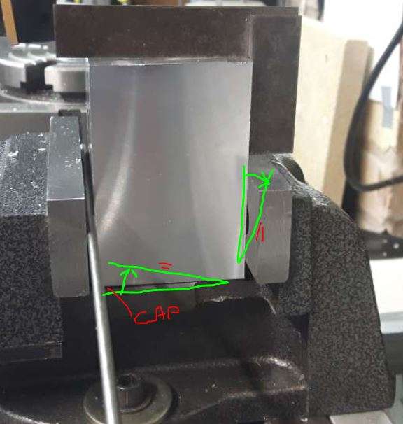

          The gap that can be seen at the bottom of the workpiece suggest base is flat and work sis being raised off the bed near the moving jaw as it is pushed back against the wonky rear jaw
          gap

                      Hi, well if he has got 0.1mm difference on a 1″ jaw, from the top of the jaw to the bottom, with a maximum run out of 0.05mm over 100 perpendicularity, as per the accuracy figures, that really is a wonky jaw, whatever the cause is.
                      Regards Nick.

                        It depends on which direction that fixed jaw is tilted. Some are ground with the top of the fixed jaw leaning towards the moving jaw by a few thou in an effort at some compensation for that rearward deflection. I believe the Vertex clones of the Kurt vise are or at least were done in that way.
