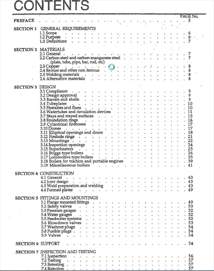

                #249009
                Paul Lousick
                  @paullousick59116
                  Hi Ken,
                  You comment "If a modeller builds his own boiler he doesn't need to use certified materials, can make it up as he goes along, and provided everything he uses and does appears sensible and well-done, as agreed by a club inspector, then he will be able to insure the boiler and use it within the public domain." is correct. What you make in your own backyard is up to you.
                  BUT, and a big but, is if the boiler is sold to someone as an approved boiler or is used in the public domain and someone is hurt you may be liable for compensation. If the club inspector passes an unsafe boiler he may be the one which is taken to court. This is why he needs to be sure that it is built correctly from approved materials.
                  The Australian code is not just for testing the boiler but is also a complete design guide which specifies the type and thickness of materials, weld preparations, types of fittings, etc. as shown below.
                  Paul.

                    That looks like the steel boiler code. There are also the copper code, the Duplex code and the sub-miniature boiler code. If anyone is interested in the history of the Australian code: http://www.aals.asn.au/AMBSC/AMBSC.htm
                    #249018
                    Paul Lousick
                      @paullousick59116
                      Simon,
                      Yes, it is the code for steel boilers. I do not have the one for copper but imagine that it would contain similar details.
                      Paul.
