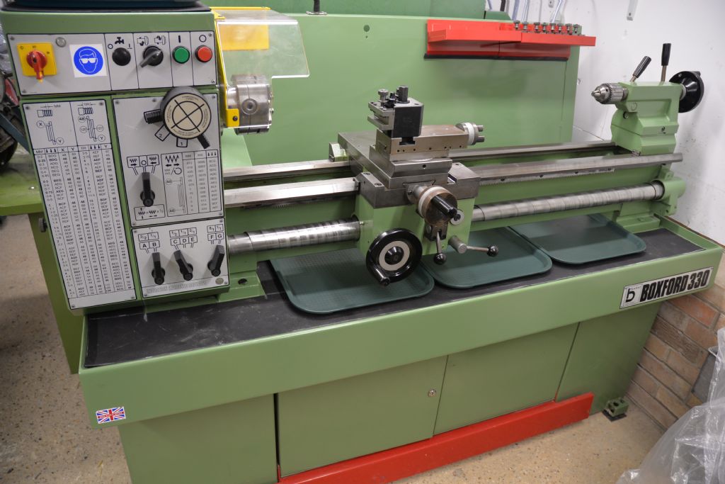

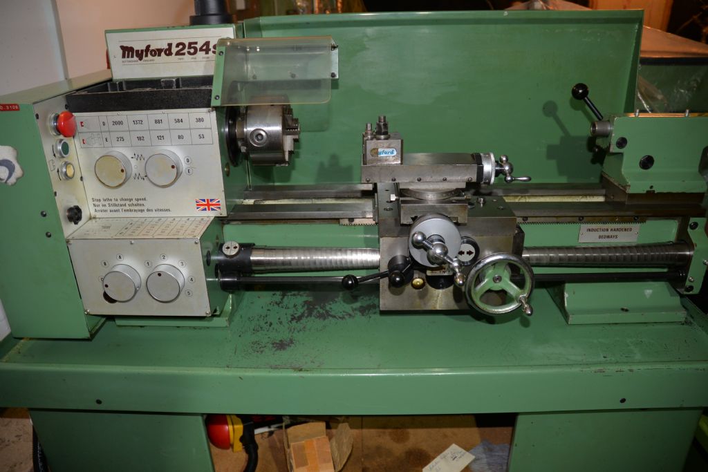

                    Two lathes sit in my workshop. I'm not suggesting this is what you may want, merely an example of what comes along if you are patient, and keep your eyes peeled.
                    The Myford 254S immediately below I paid just £1,450 for a few months back.
                    The Boxford 330 (330mm swing, 1000mm between centres) I paid just £2,200 for last year, it came out of a school that had not really used it, it just sat in the corner, and was pretty much as new.
