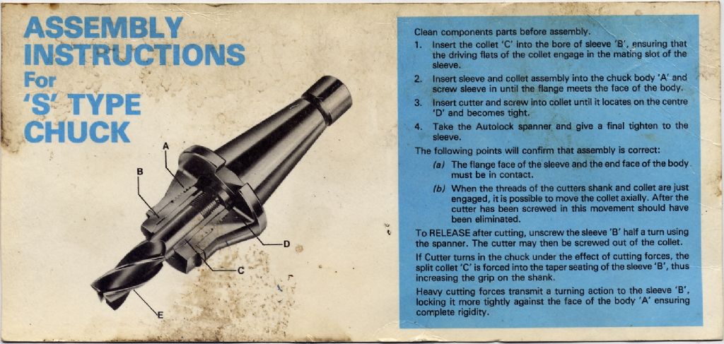

                                  This thing about cutters moving in Clarkson Autolock chucks. I don't get it. If the end of the cutter is hard up against the male centre in the body of the chuck surely the only way it can move is to rotate. This rotation, in my book, then rotates the closing ring and tightens the collet fingers. I don't see how the cutter can be drawn into the chuck.
                                  If however the clocing ring was assemble tight against the shoulder of the chuck body then I suppose the cutter could start shy of the male centre which would give conditions suitable for draw in of the cutter. Thats why leaving a small gap is the way to use the chuck.
                                  regards Martin
                                  #558269
                                  Anonymous
                                    Posted by Martin Kyte on 14/08/2021 22:29:12:
                                    Not according to Clarkson – see Section 4a:
                                    Autolock Instructions
                                    Andrew
                                    #558299
                                    Clive Foster
                                      @clivefoster55965
                                      I've long been skeptical of folk claiming that a properly inserted screwed shank cutter in a Clarkson / Osborne / Posilock holder is capable of moving forwards a measurable distance under cut.
                                      Properly Inserted being the operative words.
                                      Assuming a gap is not left between cutter and centre I suspect this can only occur if step 4 of the instructions:-
                                      "take the Autolock spanner and give a final tighten of the sleeve" is omitted.
                                      Of course the folk who are too darn lazy to read the instruction and too stupid to understand how the thing works will also omit the equally important inspection parameters at a) and b).
                                      The whole point of a screwed shank is that if the cutting torque overcomes the collet grip so that the cutter turns in the collet the collet itself is forced forwards until the grip is increased by enough to stop it turning. Not by much. Has anyone actually seen a Clarkson collet or screwed shank cutter shank damaged or scuffed by rotation? I haven't.
                                      I have broken the end off a 1/4" end mill by blindly following the leave a gap instructions from a man who really should have known better. But that one appeared to have simply slid straight back. After that I went looking for the instructions as my Posilock set had none.
                                      If anyone cares to dust off their maths its relatively easy to calculate the grip forces generated. Compare them to those given by an ER or native spindle collet too whilst you are at it. The results might surprise you. (I long ago decided never to do maths unless I'm being paid or need it for a "me job".)
                                      The final bump with the spanner seats the nose so the body is, effectively, solid and ensures the cutter is pressed firmly against the centre point. It probably also tightens the collet a fraction. Tightening the sleeve against the flange obviously makes a great deal of difference to rigidity and grip. One reason why ER collets need such ungodly high tightening torques is that the nut is loose on the threads and therefore the assembly is inherently less stiff.
                                      It would be interesting to make some tests before and after cutting with a tool setter.
                                      Clive
                                      Edited By Clive Foster on 15/08/2021 10:04:33

                                        You beat me! The cutter is locked when it hits the work piece causing it to rotate more slowly than the holder, thus screwing the collet taper out and locking against the cutter shank thus stopping further rpm drag

                                          Yes if it's too loose but it still cannot move axially if it's up against the male centre in the body.
                                          regards Martin

                                            I have broken the end off a 1/4" end mill by blindly following the leave a gap instructions……..
                                            Me too, after that I followed the manufacturer instructions.
                                            Andrew

                                              Fair enough, I've heard so many leave a gap don't leave a gap instructions it gets confusing. If Clarkson say don't then don't. My point was that if the cutter is hard up against the male centre it cannot move axially only rotate. I believe that the chuck design is intended to increase clamping force in the event of it being needed (cutting forces being high enough to rotate the cutter slightly) not a mechanism to initially tighten the chuck. That should be done by the operator.
                                              regards Martin
