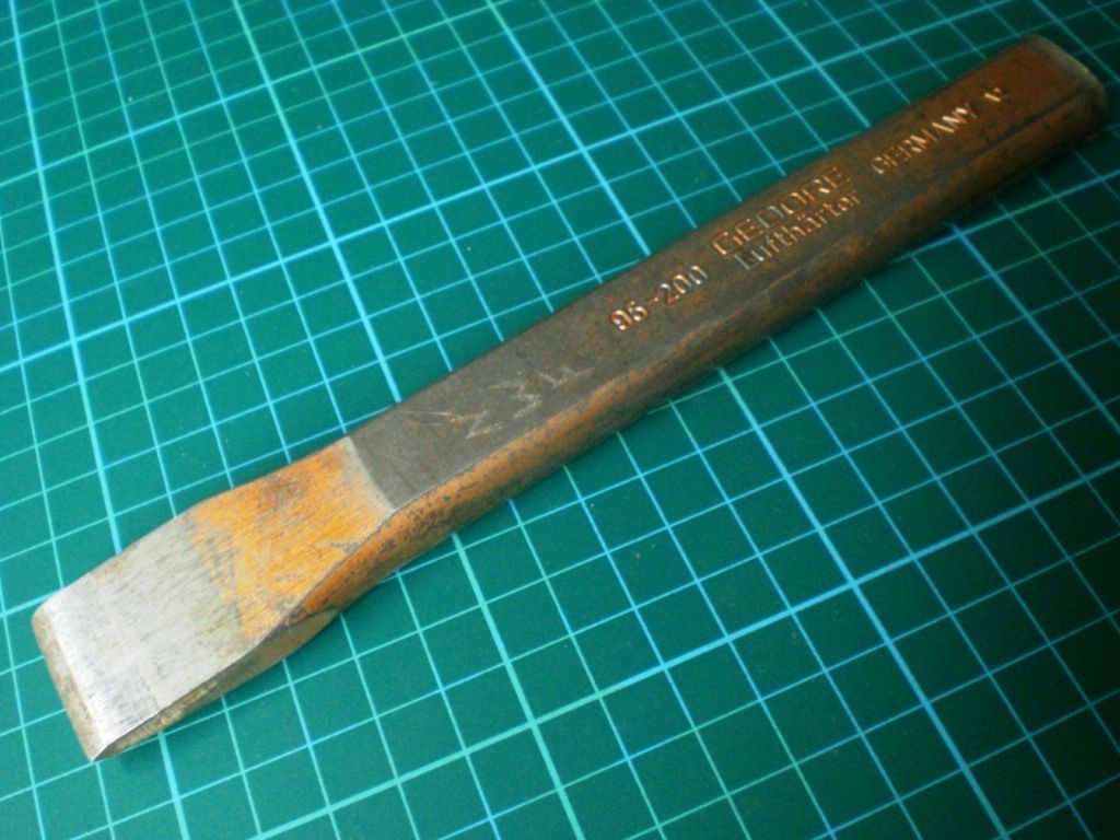

        Nicholas Farr
          @nicholasfarr14254
          Posted by Mike Poole on 23/07/2022 10:20:06:
          Hi Nick, you could probably pound that all day with a 14lb sledgehammer without a problem, the chisel I had in mind was about 2ft long and 1/2 diameter, it was my grandfather’s who was a plumber by trade. Faced with some concrete chiselling for some new fence posts I bought a Screwfix cheapy SDS drill/ breaker, it did the job in style and if it never comes out of it’s box again it was worth every penny. Cast steel used to be the material of choice for cold chisels and was what my apprentice made chisel was made from, CrV seems to have become popular nowadays.
          Mike
          Hi Mike, I can understand that the 2ft x1/2" one would bend as the dia/length ratio as JasonB mentioned earlier, makes it prone to bending with heavy blows, most good chisels are not made of round material in my experience and are very often octagonal, hexagonal and flat. I have a 11 – 1/2" x 1/2" AF hexagonal unbranded one which is pretty good, but I wouldn't slog that with a heavy hammer, but my first 18" x 1" one did get some hitting with a 14lb sledge a few times without bending. The best cold chisel that I do have is Gedore 95-200 flat one Gedore 95-200 which is made from Chrome-molybdenum-vanadium air hardening steel and it holds a really good edge and are nice to use.
          Regards Nick.
