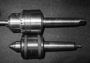

                                              #155986
                                              NJH
                                                @njh

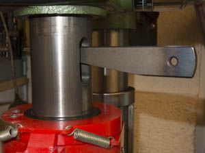

                                                Hi Brian
                                                What Thor says is quite right- these photos may explain further:-
                                                You will see that the length of taper on the arbor of the drill chuck is longer than that on the rotating centre. The drill chuck ejected easily but the centre would not self eject from my S 7 tailstock – a small hole tapped in the end and a screw loctited in proved the easy solution. A better centre might have a tang or perhaps be tapped to add one as in my previous post but – hey my solution works! ( and it was cheap)
                                                Here is a drill chuck in my pillar drill and you can see the end of the tang in the slot
                                                .. and here is how to remove it.
                                                Hope that makes it all clear.
                                                regards
                                                Norman
