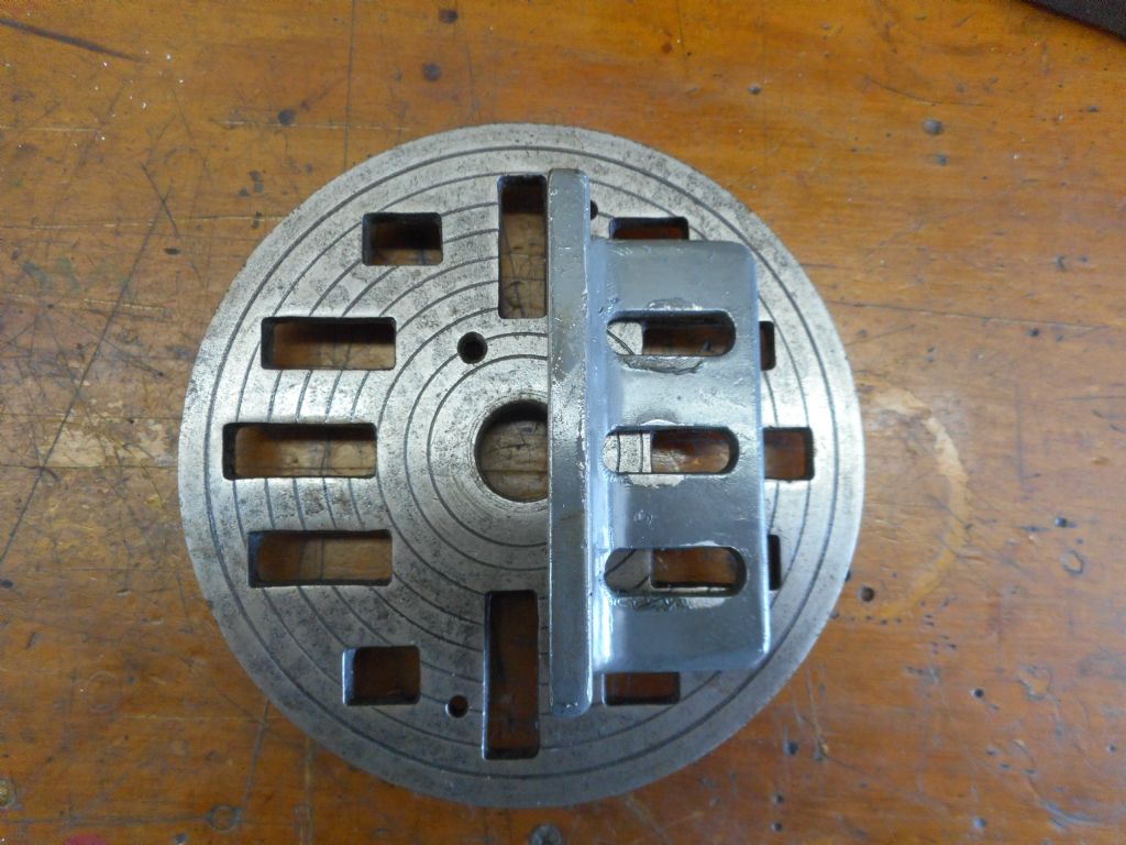

          Size of angle plate depends on job size. If its too short it might not reach the faceplate slots where they end before the centre of the faceplate. But you can then use a clamp on it. Myford make a nice longer one that has a curved edge to match the faceplate. My own is homemade and about 4 inches long i think. I can measure it later today. It's very useful.

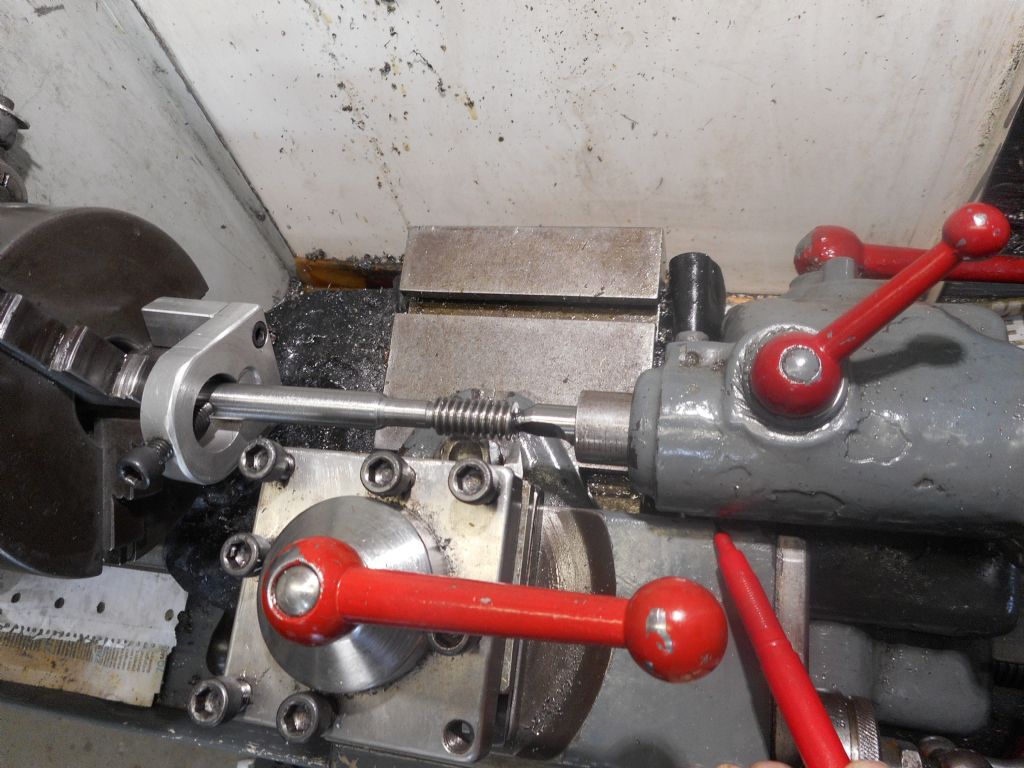

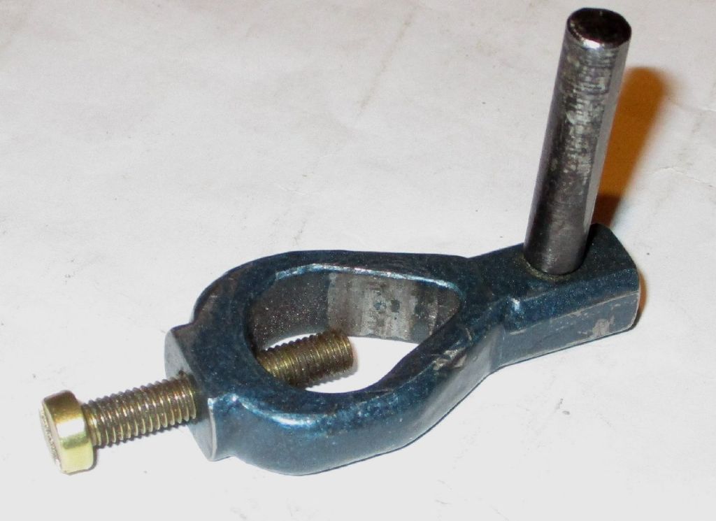

              I have made my own lathe dogs too from bits of aluminium from the scrap box, screwed together. I use the chuck rather than a catch plate on a gap bed lathe like a Myford or this Drummond. It moves the job to the right so the carriage is not half off the bed in the gap when machining the left hand end of the job.
              The piece of aluminium flat bar that forms the "tail" of the dog has a slot cut in it to just fit nicely over the jaw so it does not flap about. No need to tie it with wire when screwcutting etc.

                Nice lathe dogs Hopper, I guess you don't mind if I copy them.
                Thor
                #591217
                Hopper
                  @hopper
                  Posted by Thor 🇳🇴 on 23/03/2022 07:34:41:
                  Thor
                  Please go ahead. I have not applied for a patent on them. laugh

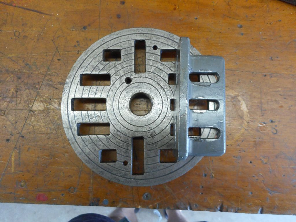

                          Posted by Clive Foster on 23/03/2022 09:16:30:
                          Its a pity that the modern faceplate only has radial slots. The old type having radial ones in one half and parallel ones in the other are far more versatile when mounting things.
                          Clive
