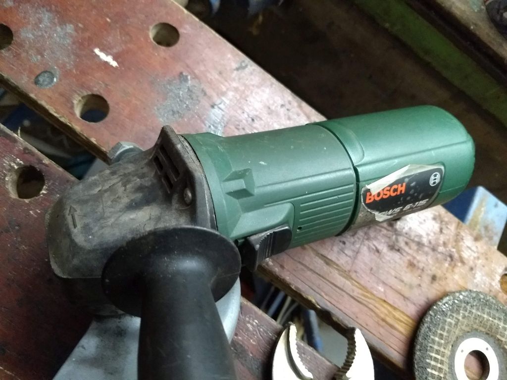

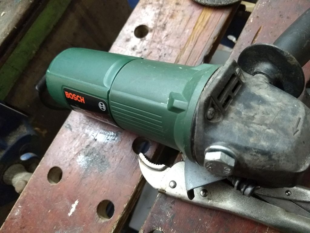

      I've obtained a 2nd hand Bosch angle grinder. The model id is on a stick-on label which is partially missing. What is visible reads 'nWS 6-115', but I think the 'n' is a 'P'.
      The problem is, how do I apply the spindle lock? According to the only manual I could find, there is supposed to be a spindle-lock button, but I can't find it at all.
      The photos show the grinder where the button should be visible, but where is it?

          Probably came with a thin stamped out spanner about 12mm that fits over flats on the spindle just as it exits the machine.

            My PWS 7-115 has a 17 mm Flat. The flat drives the rear washer unlike others that screw on. If not overtightened an appropriate blow on the normal spanner on the front nut may loosen it easily against just the motor inertia. Or just grip whatever disk or wire-brush is on it and undo the nut.

                  My dad has this grinder, thin spanner required, I would guess you might find one on eBay for a quid or 2 delivered
                  #453261
                    The spindle lock on 99% of angle grinders (and cheap routers) is a waste of time anyway, they round off of stop working quite quickly. I've modded spanners to fit before now…

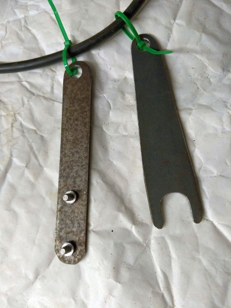

                          Since my acquisition came with no proper means of changing discs I made a pair of spanners.
