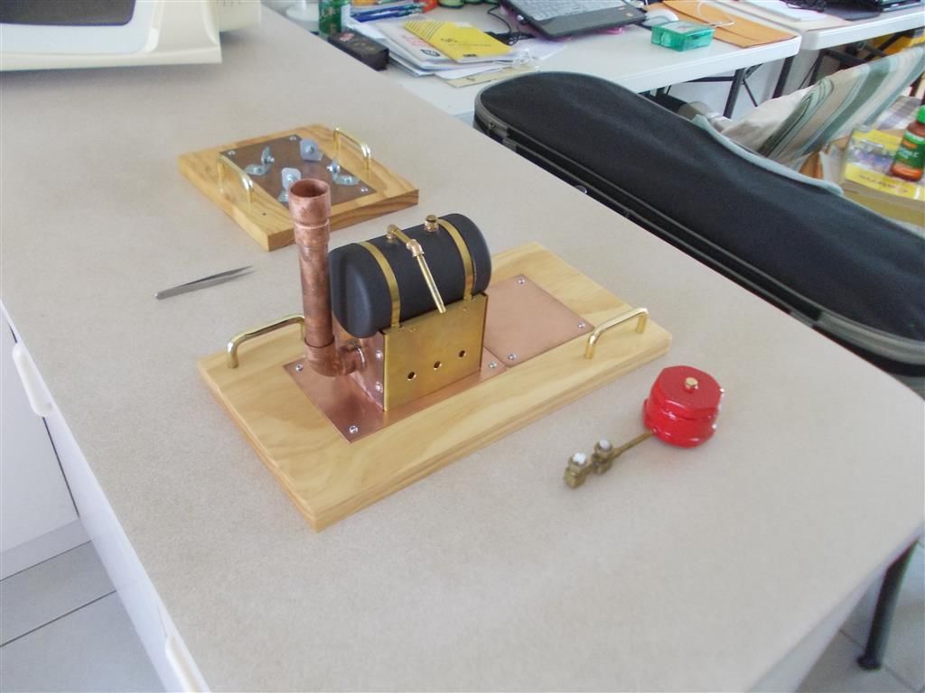

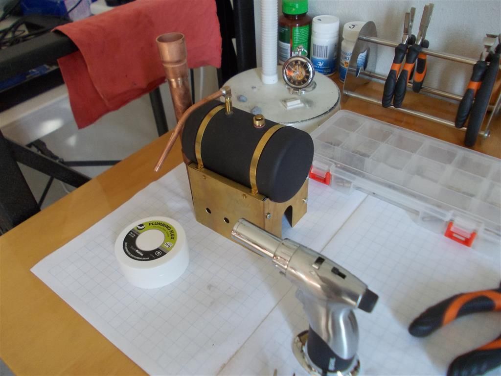

          The boilers never look finished until the boiler bands go on . I have raised the steam outlet a bit higher than I usually do : I am hoping that this might eliminate the problem of water coming from the steam outlet (priming ?) when the boiler is firing up.
          Soft soldering is very easy when you have the right flux. I am using a plumbers solder from Bunnings which is a white paste. It is very similar in appearance to the white paste I use for silver soldering but obviously it is chemically different. I never did get on with those liquid fluxes when soft soldering. I used 243 degree solder used for building model trains.

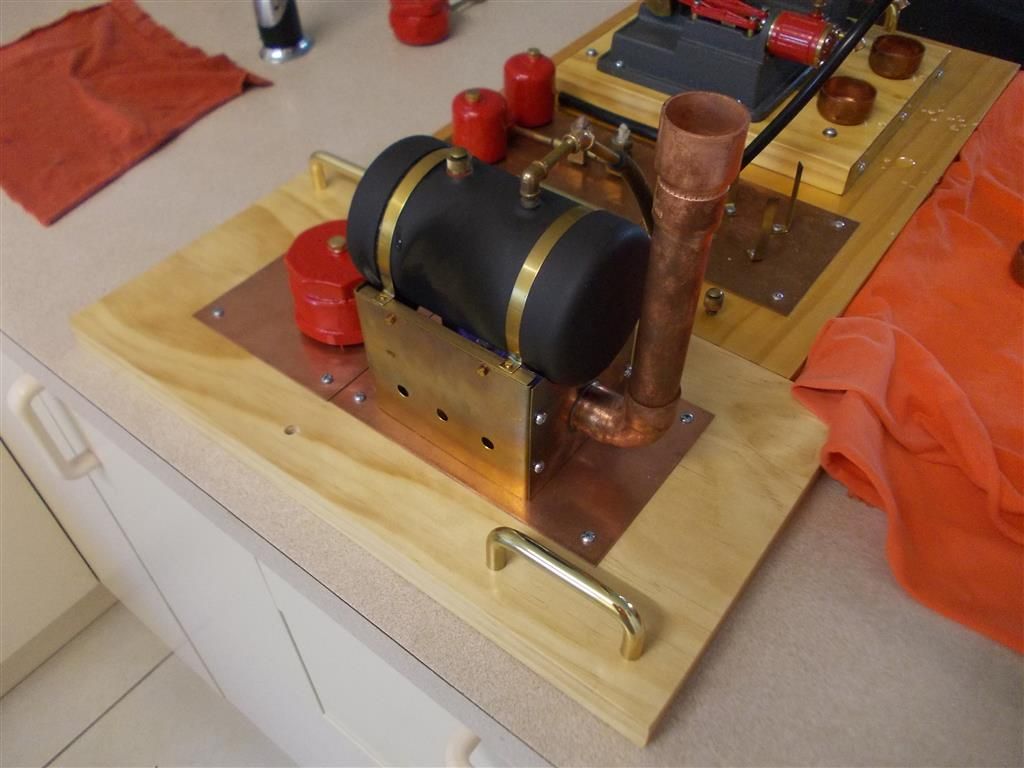

            Finished boiler on its stand and ready for testing :

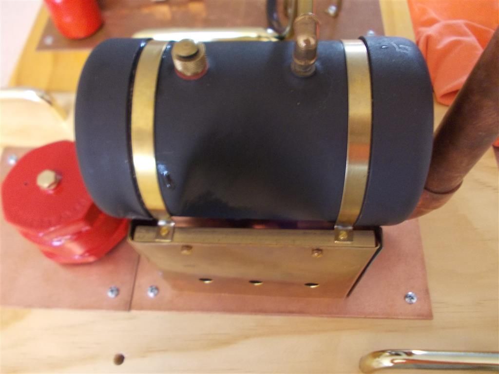

              With the lathe out of operation I had plenty of time test the new boiler. It works very well with the both the double wick meths burner and even the single wick meths burner. As you can see there is still a bit of a gap between the boiler and the sides of the firebox ; some heat is being lost there. I was thinking of building another one and soft soldering some brass strip in there to completely seal it. I am not sure it would make much difference as this one runs great with plenty of steam.

                I wouldn't bother sealing those gaps – they let the residual hat flow up and around the outside of a boiler and allow a good flow of hot flame around the underside of the boiler, it does no harm when boiling a saucepan…
                If you block them the only place for the hot air to go is up the chimney, where it won't heat the boiler at all.
                Most pot boiler designs like this have a narrow gap and no chimney.

                  Yes, I noticed that there was not much heat going up this chimney compared to the vertical boilers I have built.
                  No chimney surprise the horror ! …you must have a chimney even if only for the sake of appearance.

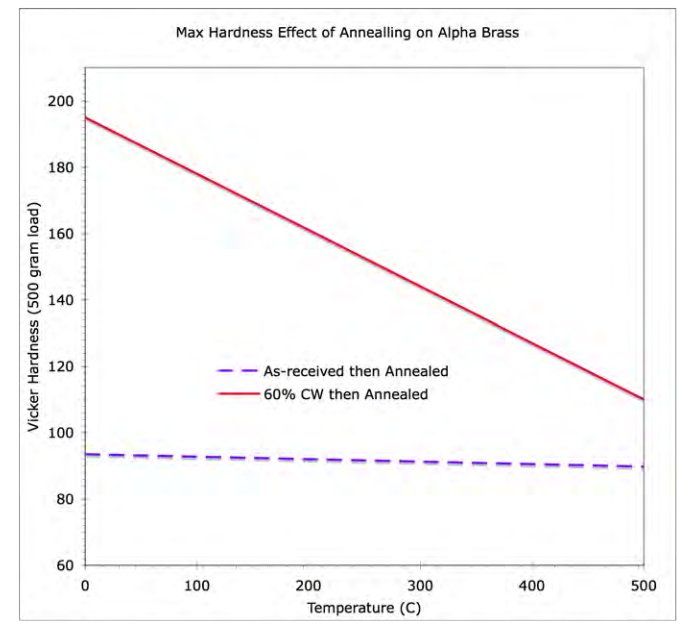

                          It's possible to make a decent job of folding metal with maybe in your case a small engineers vice and 2 pieces of thick bright drawn angle iron and something long to fold it with. If brass is too hard it will split so I'd guess you may have half hard.
                          According to my law fully annealing brass involves heating to red heat and quenching in water. That's all I have ever done with it. For that I will stick to that too. Some reckon that the heat it's raised to determines the degree of softening. This might be true. It might be worth trying an extended period in a domestic oven running flat out. From a uni educational paper.

                                  The problem with annealing and buckling is failing to apply and even heat all over – hence suggesting a domestic oven but pass if it will achieve anything. However some control can be exorcised by heating slowly and moving the flame around all over the sheet – just like when aluminium is annealed with a torch.
                                  Brass can only be hardened via cold working as far as I am aware and softened via heat.

                                            But my other problem is that I am not producing enough steam to run this engine for more than 60 seconds ; it runs out of puff. I tried my usual trick of inserting a piece of 1/8 brass tube inside the 3/16 steam pipe outlet but it did not help much that I could see. I assume that the reversing link mechanism is the reason for this as I have no problem running my other PMR engines using this boiler ie. more friction hence more energy required.
                                            I am going to have to find way to get more heat to the boiler. This may also solve the steam condensation problem. I was going to build a three wick burner for this boiler then put the job on hold as unnecessary. I think I may go back to this idea.
