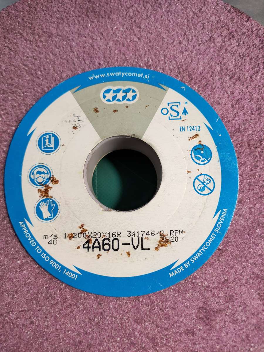

                                I took the wheel off – it just says 4A60-VL which I don’t think includes the hardness or porosity. So I may well have a wheel more intended for bench grinders (it is pretty pink though).  i may spend a day delving into my storage shed for some alternatives…

                                  I would say that’s a 60 grit V hardness AlOx wheel – bit fine and hard for general things.
                                  I tend to use a 46 J iirc, also from Coventry Grinders. Ive not had an issue with any of there “own brand” wheels for balance, but I only run 1/2” thick on my J&S 540.

                                    It  also looks to be a 16mm bore, so may not fit anyway.
                                    I’m guessing it’s intended for an 8″ double ended bench grinder, since it’s a V.

                                      It’s 16mm thick. The bore is the std imperial equivalent of 32mm. (or may the 16R means 32mm diameter?)
                                      It does seem too hard. I thought V meant Vitrified bond and it was missing the hardness grade?
