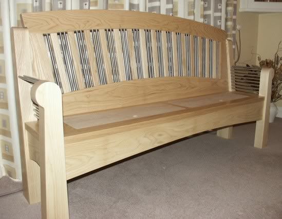

          I don't think its a standard product, there are companies that will centerless grind bar but thats likely to be a bit costly unless you want a fair bit.
          Are you actually looking for precision ground or just something with a ground/brushed look? if its the latter then when I use it in furniture I just by 303 and spin it up in the lathe and use a scotchbrite pad to give a nice look
