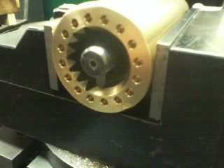

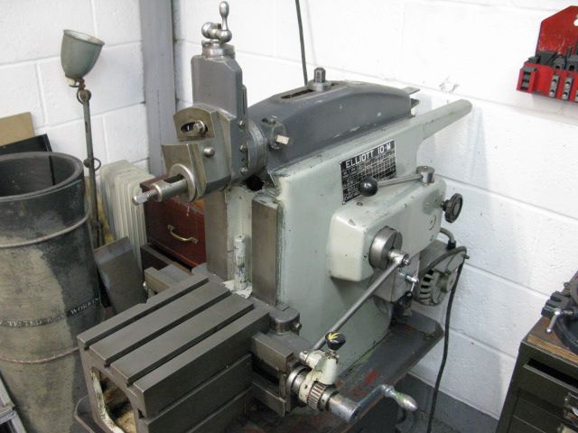

            Apologies I said I'd post a picture of my newly aquired 10M, life got in the way and I still have not tidied up! looking a lot cleaner than when purchased at first it was not evident it was in a two tone colour scheme, but paraffin and elbow grease have bought it up ok. Ex school it has not had a lot of use, three phase but wired for single using a capacitor it runs fine, had a play with it on some scrap but looking forward to using it in earnest.img_0483.jpg

              Hi Dave , exactly the same as mine and ex education as well. Mine has a date on the tool[ost swivel its 120976!. I also made the sleeve gear and post to enable auto vertical feed, a really worthwhile exercise .

                Just checked mine and it is 120907 so not far off yours. I'm not sure when Elliott packed up, there were a number of ex Elliott emloyees that had recently been made redundant in the firm I served my time with in the early 70's, but then again I briefly worked for a firm that imported some Taiwanese mills ( A1-S) in 1980 and badged some as RMT ( sold by themselves) and others as Elliott ( for a dealer) so there must have been some badge engineering going on. I'm intrigued and will have a bit of a search on the company's history. Very interested in the vertical feed as looking in the manual and at some online pictures it looked a fairly straightforward and interesting job. Be great to see some pictures of your conversion.
