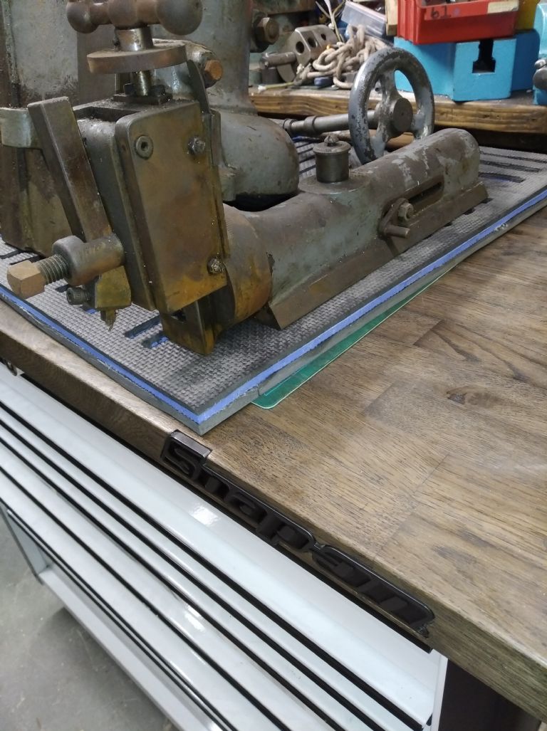

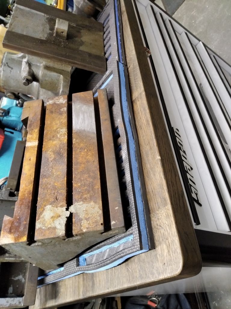

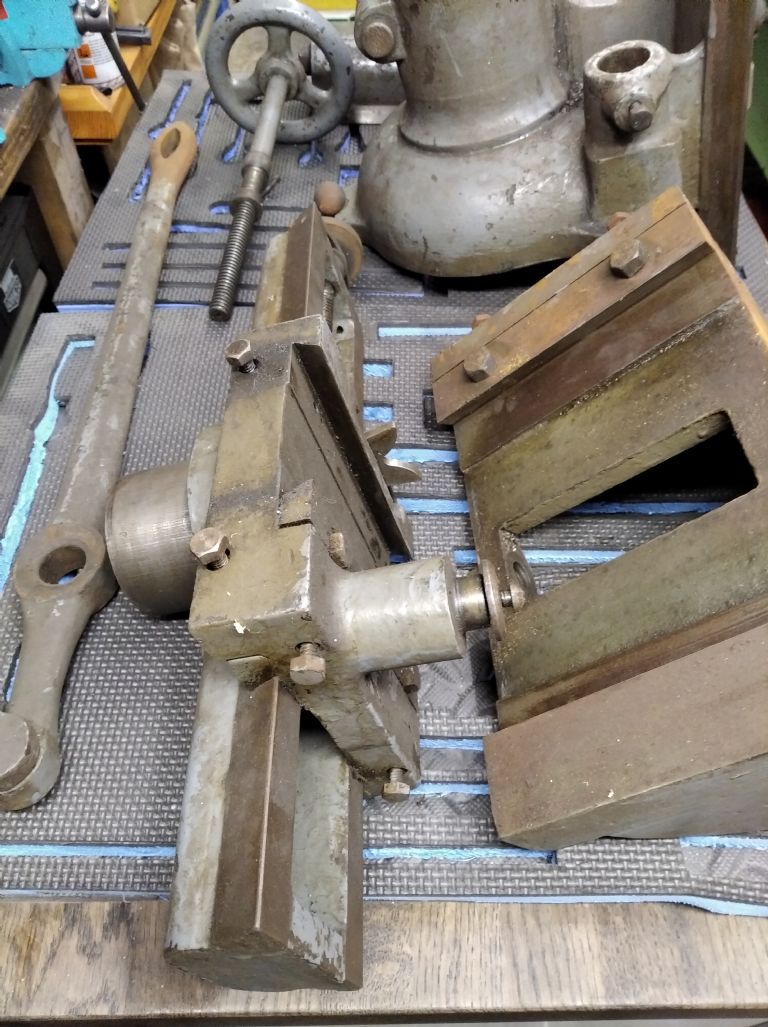

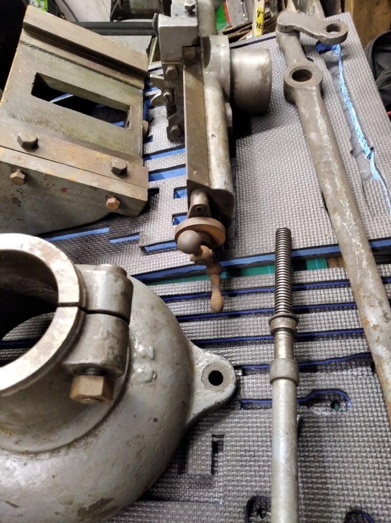

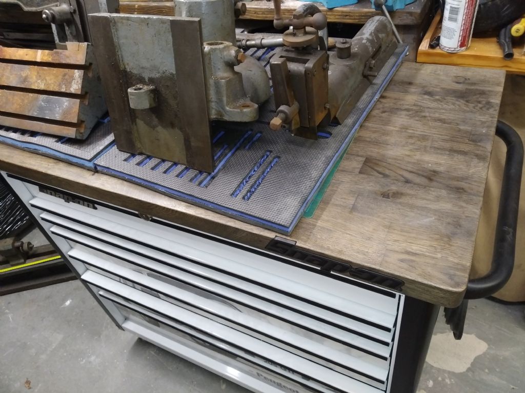

            Pete.
              @pete-2

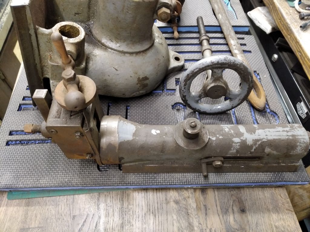

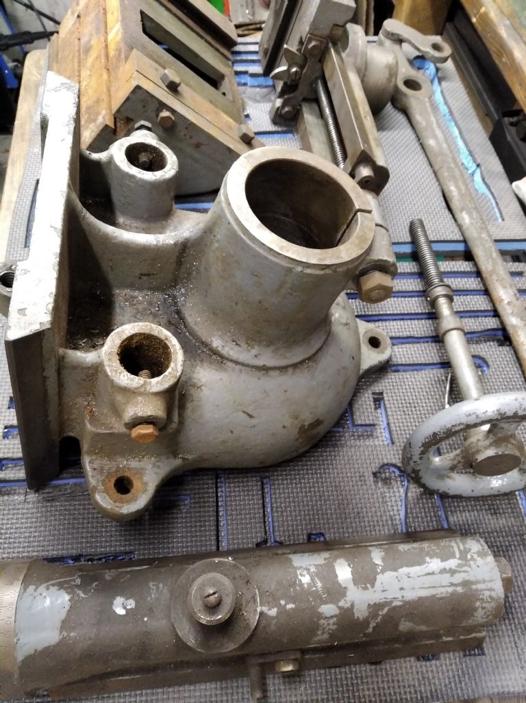

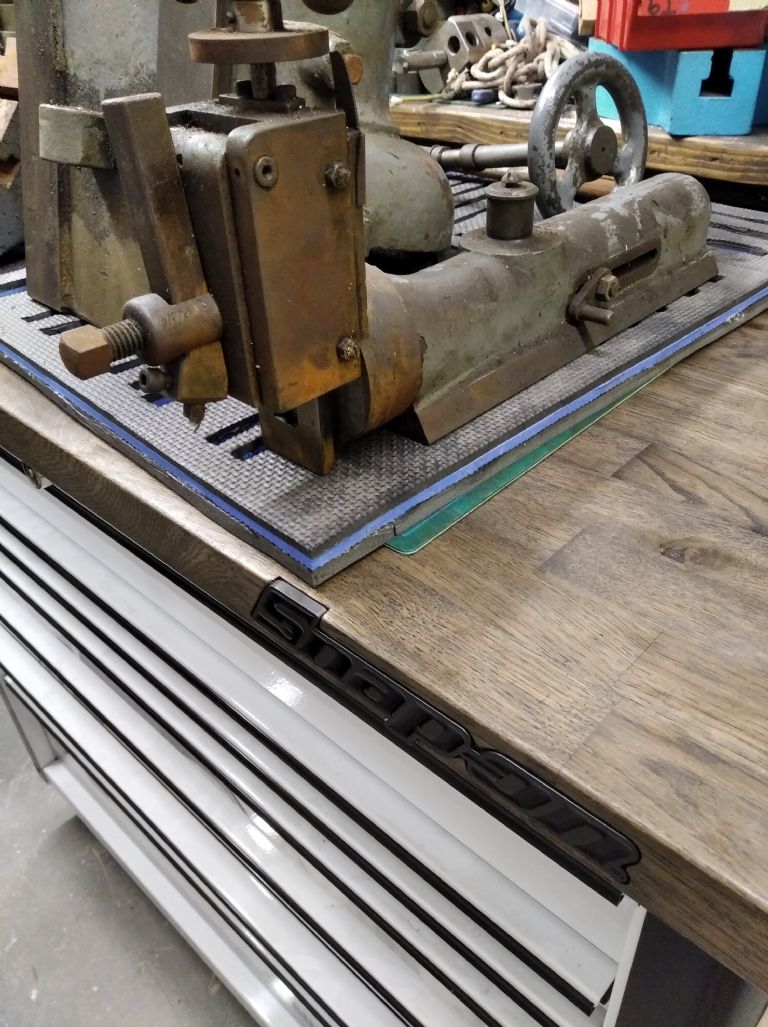

              After looking for a hand powered shaper for some time, i found an Adept no2 locally in good condition, another shaper popped up on ebay at the same time, I put a bid on it as well as the Adept thinking someone else will have to bump the price up, nobody else bid, so I now own two hand operated shaping machines.
              The second is older, a little bigger, what I would think more expensive when new, and seemingly quite rare, I've found out it's a Bradley Shaper, dating around 1900 to 1920.
              Are there any other owners of this quite rare machine?
              it's been in storage for a while, thick oily grime has preserved it very well mostly, the only area that has been affected by corrosion is the actual table, I've scraped a bit off, it's a bit pitted, a visit to a local surface grinder shouldn't be too expensive for that one item.

                Pete.
                  @pete-2

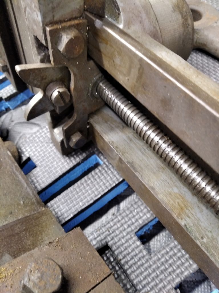

                  If the cutting tool will reach the back of table, I'll give that a go, do you know what the V pads that go in the two round holes behind the table are for?
                  missing on mine, but visible on the one at lathes UK Bradley shaper
                  #563274
                  Ady1
                    @ady1
                    I hate to say I don't have a clue but I…
                    I don't think the clapper even gets that far back (3rd down on left piccy)
                    With those Vs and the curious bracing wall on the back of the table I get the impression there was some sort of specific work it could perform that was useful back in the olden days, and why would you want a 90 degree swivel action?

                    #563279
                    Ady1
                      @ady1

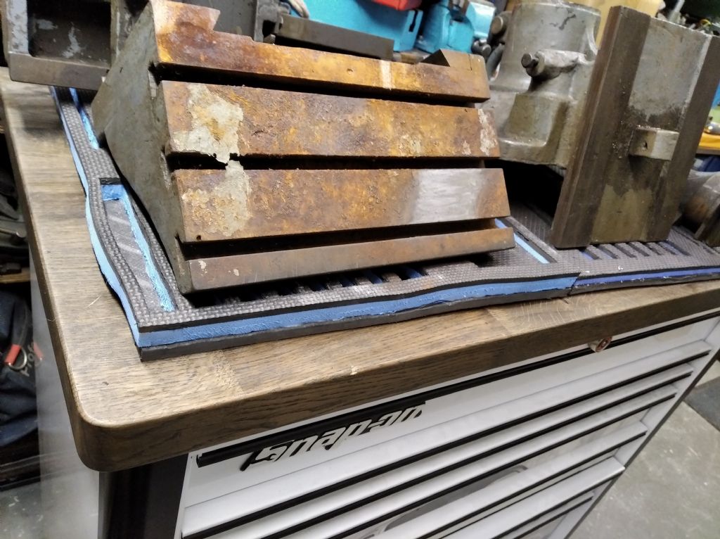

                      The wall is the v-ways for the table, so you can move the table AND the clapper on your hand shaper. wow
                      (usually the tables are bolted in a fixed position)

                      #563280
                      DC31k
                        @dc31k
                        The Vee pads look like they would take a shaft into which you want a keyway machined. The ability to swivel the 'cross slide' so it is fore and aft, thus making the ram movement 'left' and 'right' achieves this.
                        #563313
                        John Olsen
                          @johnolsen79199
                          DC31K has said exactly what I thought when I saw the pictures. Cutting keyways in shafts was once an important function for shapers, and if you look you will find that some power shapers are built so that you can if necessary feed a shaft right through the machine. One of mine has a forked end on the connection to the ram to permit this, so you could if necessary cut a keyway in the middle of a shaft of any arbitrary length. (You drill a hole at each end to permit the tool to start and finish the cut.) The setup on the shaper pictured above would also permit that.
                          #563318
                          DC31k
                            @dc31k
                            Posted by John Olsen on 18/09/2021 11:49:04:
                            …so you could if necessary cut a keyway in the middle of a shaft of any arbitrary length.
                            And being hand powered, you can take the machine to the shaft so you do not need to dismount the shaft or split any of the belts. Beats chipping it out by hand with a cape chisel.

                                #563354
                                Pete.
                                  @pete-2
                                  Thank you DC31k, turning the ram 90 degrees for using the V pads had slipped my mind, but I think that's exactly what it's for, if the ram had gone further back I thought it looked like maybe for cutting a rack in round bar.
                                  I think it's too heavy and unbalanced to use anywhere other than firmly bolted to a bench.
