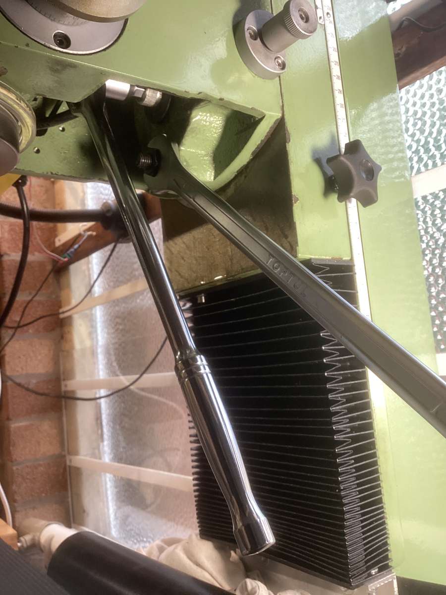

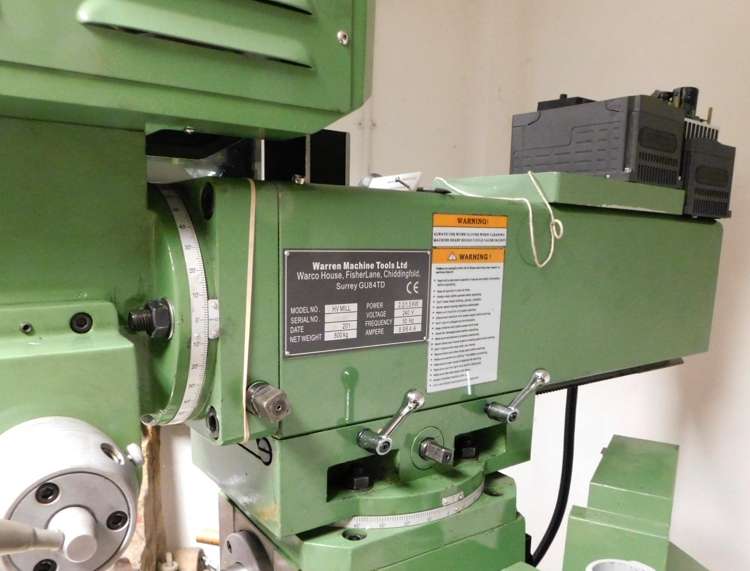

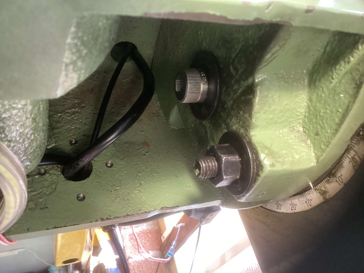

      I’ve just had the displeasure of spending nearly two hours tramming my Warco WM18 (it’s now within 0.01mm over a radius of about 7 inches, which will do).
      Nine tenths of the displeasure was caused by the fact that tightening down the two locking bolts after tramming always put the perfect tram I’d just carefully dialled in out of whack by anything between 0.5 and 1mm – the amount things became out of whack being proportionate to how tightly each locking bolt was finally tightened down – something which, as you can imagine, is difficult to gauge without a torque wrench, and there’s no way you can get any normally-proportioned torque wrench up inside the head of a Warco WM18 and on to the upper of the two locking bolts.
      Having to counteract this tram-altering effect at the final hurdle and hit the desired accuracy when everything was tightened down seemed practically impossible initially, and it was only by many tedious lockings and unlockings and tappings of the head that I finally hit the numbers I was looking for with everything locked down.
      If anyone can suggest a tramming technique that would involve less trial and error in the present circumstances, I would be delighted to hear from them.

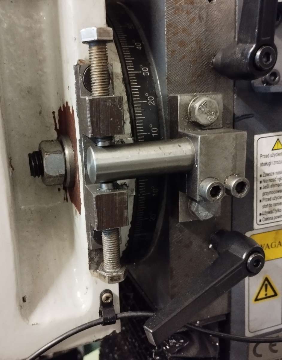

              I had similar problems with my mill, a Cormak ZX7045, similar to other suppliers offerings, close to Warco’s Super Major and similar to the OP’s WM18.
              First thing I did was remove the paint and filler from under where the three head clamping bolts sit.  Also made some much more substantial washers.  This made the clamping far more positive.  Doing this helped somewhat but was not the answer.
              The photo shows how I finally achieved accurate tramming, self explanatory I hope.   The device works for vertical and a few degrees either side.  The round stop bar can be unclamped and moved out of the way for bigger angles.Article
              I think the problem is caused by a couple of things.  Firstly, the head is poorly located on a very short spigot so tends to lean forward when the clamping bolts are released.  Therefore one is immediately fighting the alignment in two directions rather than one.  When tramming the head I leave the three clamp bolts just nipped to stop the head leaning forward.  The two set screws are 5/16″ UNF, quite capable of moving the head even when the clamping bolts are still holding the head against it’s mounting face.
              Secondly, the excessive mass of the head doesn’t help with the minute amounts of movement to achieve the accuracy of tramming wanted.

                  Besides the inherent engineering issues of a heavy head with all its weight overhung on a short spigot it sounds as if something is either not quite flat enough or the mating surfaces aren’t sufficiently clean. A bit of crap rolling around between two milled, rather than scraped, surfaces can create surprising amounts of error.
                  Another gotcha is if the ends of the drilled bolt holes haven’t been chamfered to ensure nothing round the edge has risen when the drill starts or breaks through. More usually associated with billet materials rather than cast iron but it can happen.
                  Time to pull the head and give it a very careful going over. Make yourself a stout support post that can be fixed to the table and grabbed in a collet to hold the head as you remove it using the table feed to pull it off the spigot. Use it to hold the head whilst you are working on it too rather than chasing around the bench. Probably need an extra support at the spigot end too.
                  Ultimately all the affordable machines tend to suffer from this sort of problem. There is limit to how much effort that can be put into a machine without taking it well beyond the price you can afford. It’s a great pity that the hobby machine tool market is way too small to support Tier 1 Automotive Supplier style factories with their ability to produce very accurate components at silly low prices. Even with professional market machines, like my Bridgeport, you still have to be careful with the right technique to quickly get things just so.

                        I thought John Mc’s screws were to adjust rotation which would be sideways tram not front to back nod?

                            He said the method works for vertical tram, ie nod, to which I concur, and a few degrees either side for sideways tilt. I would agree with you that is rather limited but it is the easier direction to correct in any case.

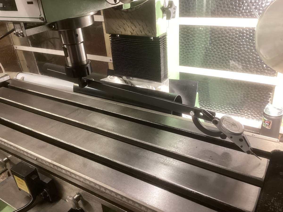

                                            Being a glutton for punishment, I trammed the mill all over again today, this time using the full length of the table (about 26”) to read from. Yesterday’s 0.01mm over a 14” swing had transformed itself into 0.04mm over the longer distance, so more fiddling was embarked on to get it down to a truer 0.01mm.
                                            This time I didn’t undo the two locking bolts as much as yesterday and I used a jack under one or other side of the head to tilt it what I’d roughly calculated would be the right amount each time. The max deflection on tightening the bolts was around 0.2mm, which was easier to compensate for than the bigger deflections of yesterday. I’d replaced the factory-fitted grade 4 hex head set screw in the upper position with an Unbrako cap screw so that I could leave the long ratchet in the hard-to-reach screw head between adjustments.
                                            It remains to be seen how long the present tram holds good. I’m sure people can see for themselves how disturbingly close together the two locking bolts are as well as the lunar surface the washers have to bear on to. Far from ideal.
                                            The last two days have revealed something else I’d long suspected was the case, which is that the quill lock on this machine skews the quill quite a lot – about 0.1mm when measured at each end of the table. This is one of the reasons I was already in the habit of using the head, column locks and Z axis DRO as much as possible rather than the quill lock and DRO.

                                              Put some spring or Belleville washers under the nuts. This will allow them to be slackened enough to allow rotation of the head while still maintaining the mating faces in contact.
                                              Same trick is also a huge help with faceplate setups in the lathe.
