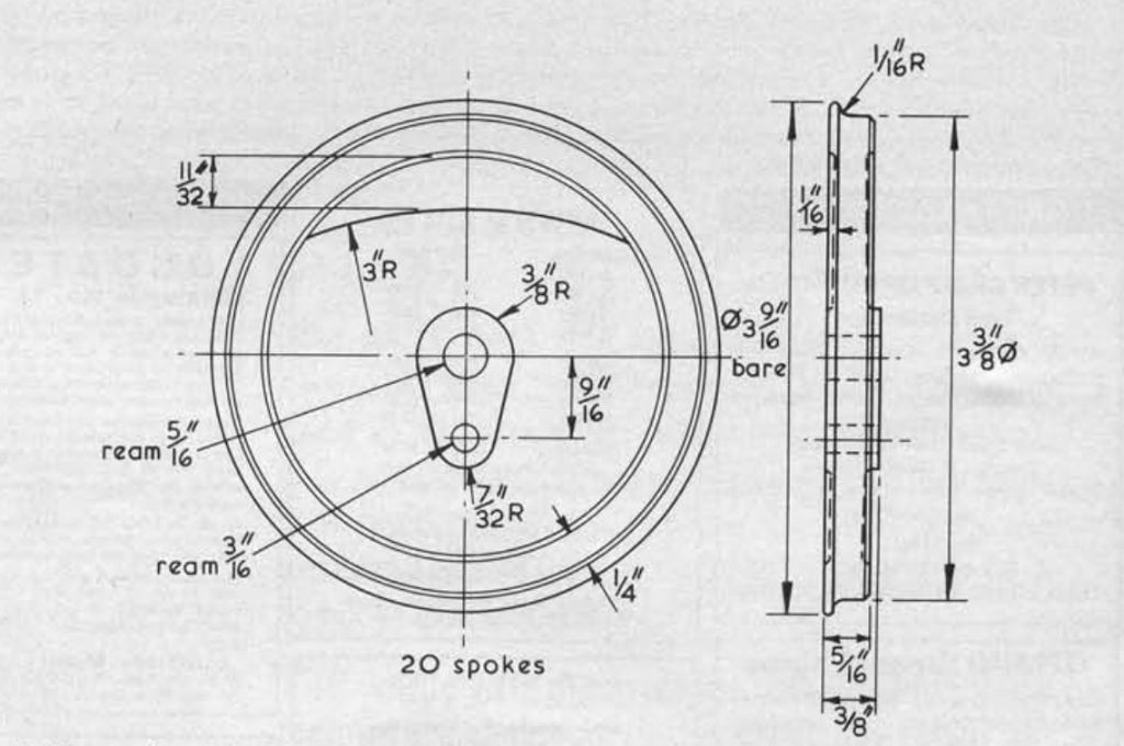

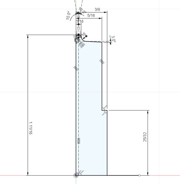

      Hello everyone!
      As I continue with 3D modeling Martin Evans Eagle, I have come across another feature I do not understand. I don't understand when the wheel flanges will start to cut into the side and make the 10 degrees angle that is set by the N25GA. If anyone could explain to me geometrically where the angles of the flanges and threads start and end that would be great! Thank you very much!
      Noah

          Original drawingWheel Cad DrawingZoomed in Wheel Cad Drawing

            I'd think there's risk of overinterpreting the drawing to a level of precision not achievable outside an instrumentation lab.
            The flange edge radius isn't specified because it's supposed to be derived from the 1/16" flange thickness at an arc where a 10 degree tangent each side touches the radius. In practice it'll be a bit over a 1/32" rad – I think I could probably work it out if I put the time into it. A more considerate draughtsman would have calculated the nominal value of that rad and put it on the drawing as a 'reference' dimension.
            Then the specified 1/16" rad runs from the 10 degree tangent down to a tangent on the 3 degree taper. It would be best to blend that transition as smoothly as possible. Absence of a step is *probably* more important than the precise value of the radius, or the taper.
            But hey – I know drawings better than I really know railway wheels. There will be people here who know far more.

              The 1/16 radius at the root of the flange is important, as that is what centralises the wheelset on the track.
              The tread does not have to be tapered – a parallel tread will work equally well, possibly better,
              The radius at the tip of the flange is not critical, on wheels of this size it is mainly cosmetic and can be formed freehand with a file.

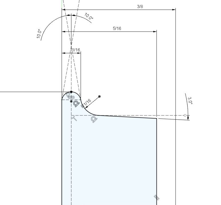

                It looks like you've drawn it properly.
                As long as you have used the 10 deg lines to trim the 1/16" diameter 'arc' and then constructed the 1/16" radius tangential to it, then it should work out OK. From there, a tangential line at 3 deg confirms the profile.
                Actually, the 10 deg line that intersects with the inner face of the wheel appears fairly pointless to me, as if you use it to trim the 1/16" diameter 'arc', you get a tiny flat/chamfer of a transition instead of a nice smooth blend.

                              Major league overthinking about the drawing forgetting its something that you just make, mosly by eye on unsophisticated machinery.
                              Start with a flat flange and wheel the right thickness and diameter. Use a concave tool to put the 1/16 radius on the wheel side of the flange. Probably end up with a thou or so undercut on the top but that is too small to worry about.
                              Use a convex 1/16 radius tool to cut the wheel taper stopping when the two radii blend. Again probably have a wisker of over or undercut. Polish it out and be happy.
                              Flip the wheel and put the radii on the back.
                              Do the rest.
                              With the right technique the theoretical drawing tricky stuff just falls out.
