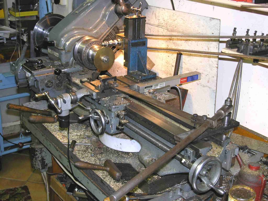

          If direct indexing is being used here and the fault shows every time, then the indexing plate must be faulty.
          A good picture of the whole setup might help us here.

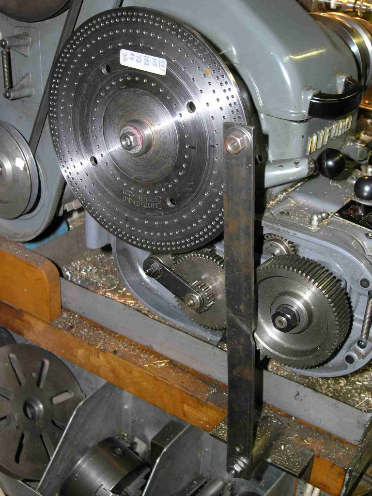

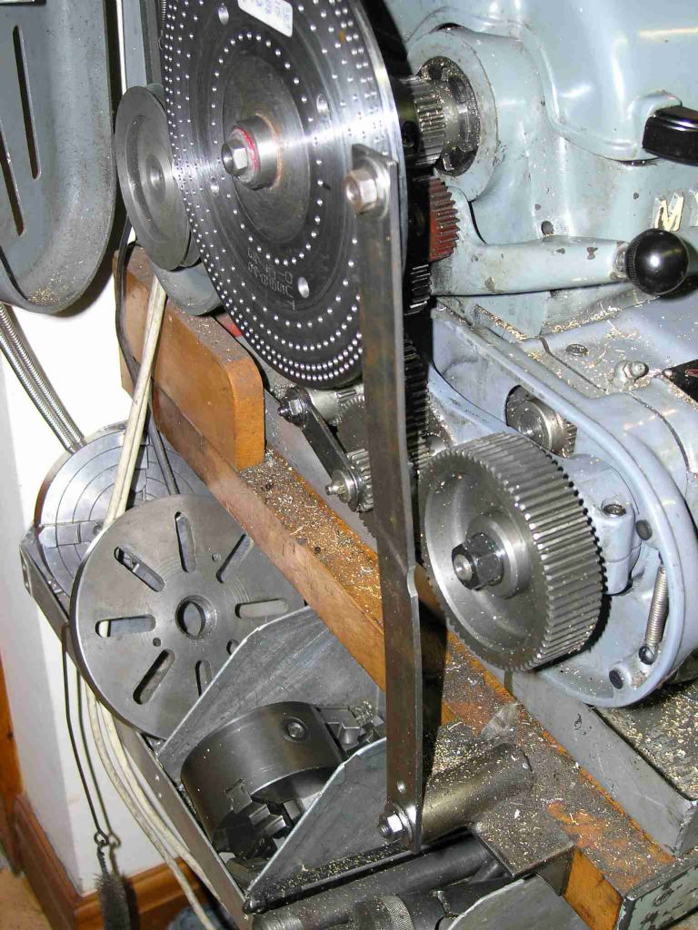

                                            First I agree with all of the comments discounting the size of the blank. The same also goes for the shape of the cutter. The problem is to do with the ANGLE of rotation of the blank between the teeth. Looking at the way the strap on which the indexing pin is mounted makes me think this could be a source of the problem. I assume that the nut at the bottom end of the strap is not undone during indexing. If it is was play in this hole could be the problem. I am assuming that you just flex the strap to index between holes.
                                            The way the bottom of the strap is fixed to the bench rather than somewhere on the headstock casting could be the problem as any movement in the bench between where the lathe is bolted to it and the bottom strap fixing would cause errors. The only other thing I can think of is end float in the cutter shaft but you have probably already eliminated that.
                                            Les.

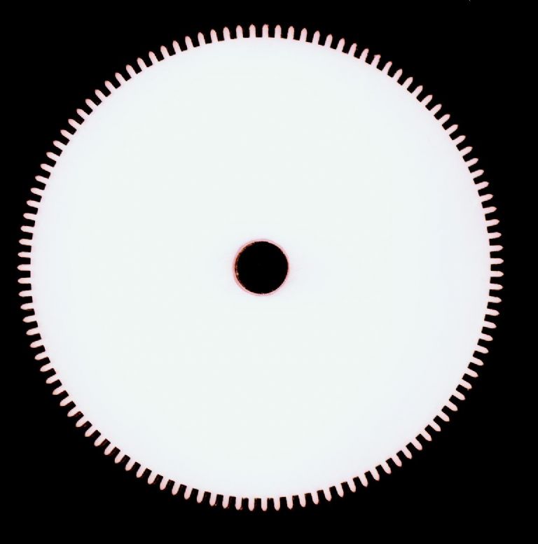

                                              The second wheel in your picture is duff at the 10:30 position.

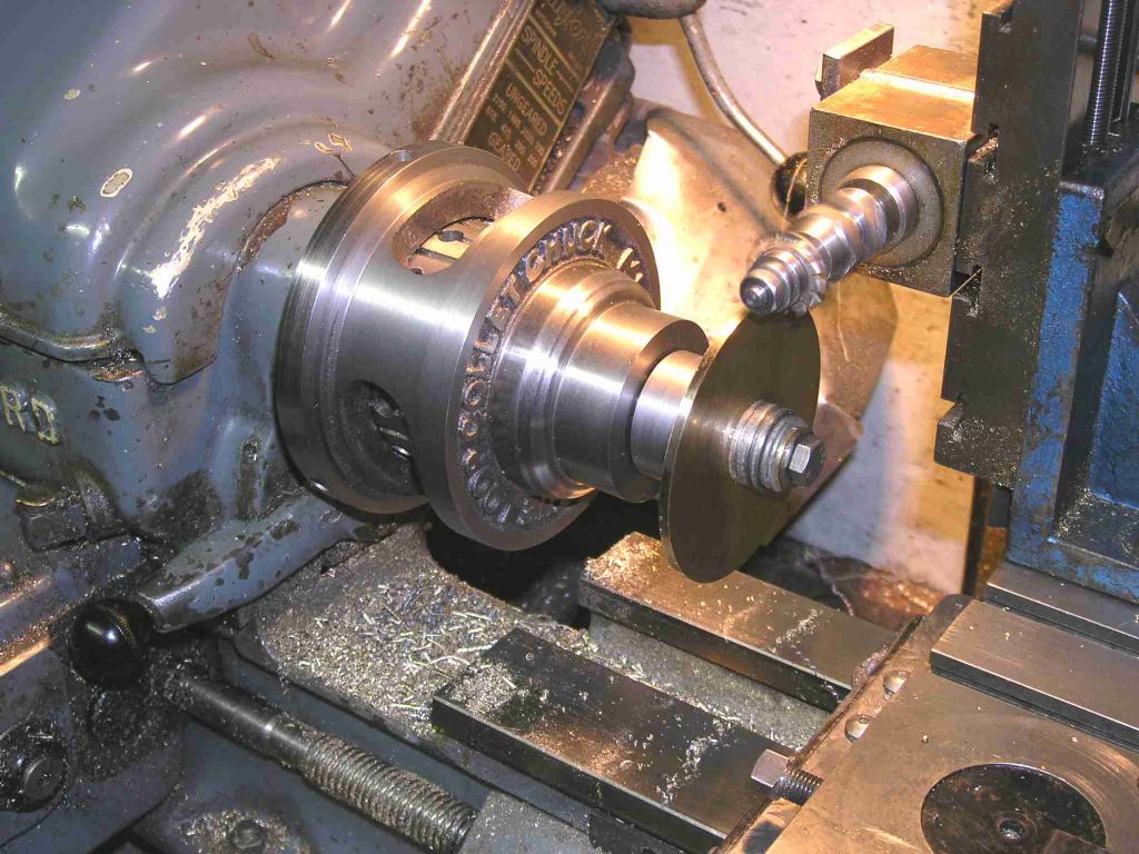

                                              The thing I notice in the third and last of your photographs is that the support arm of the indexing pin is anchored to the bench rather than the lathe.
                                              If the lathe is able to move in relation to the bench – and hence the the arm – then a slight rotation of the headstock spindle will occur and give the error we are seeing.
                                              Is the lathe firmly secured to the bench so that it can not creep across it?

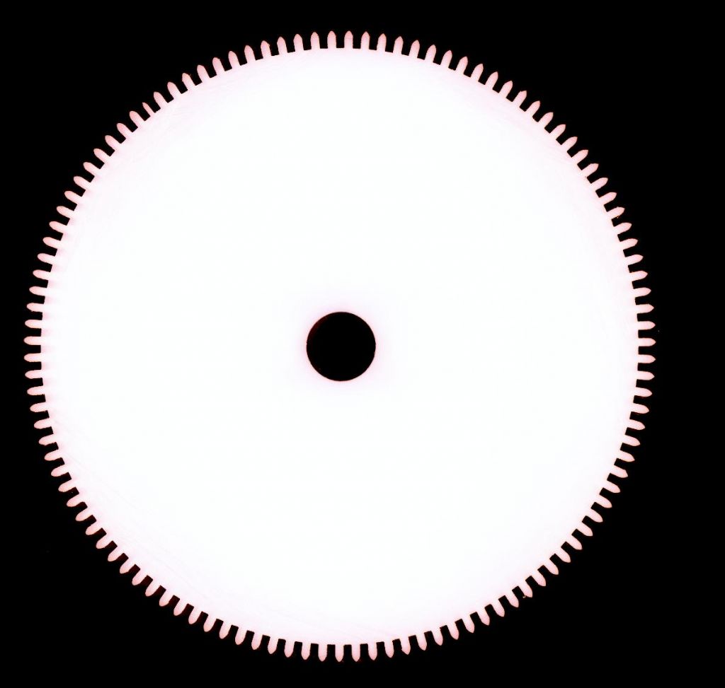

                                                If the three wheel pictures are the latest cut and given that the second has a thin tooth then something is loose or the cutting procedure has changed for the second wheel. It would be good to mark the first notch when cutting the next wheel and the starting position for the index plate. With a cut wheel mounted how much can you turn the wheel- i.e. how much backlash in the pin/plate/mandrel/ wheel system? How much can you move the culler along the spindle axis?
                                                It could be that the apparent rotation is in the first cut or the last cut . Not at some other position because that would produce two bad teeth, but it has not happened every time. So the evidence suggests that the plate is good but that some other gremlin sometimes moves stuff at the beginning or end.
                                                Billy.

                                                  It looks like the captions did not come through with the pictures, not sure what I did wrong? The middle wheel with the thin tooth is one of the originals, the top and bottom ones are new, cut last night.
                                                  The arm does indeed flex and is springy enough to allow it to be pulled back to index to the next hole and it locates with a firm clunk. Agree that the mounting could be better as it is only screwed to the wooden bench but just checked and the lathe is till firmy bolted down and the arm bracket is screwed tight. It would have been nice to report that something was loose!
                                                  Peter
