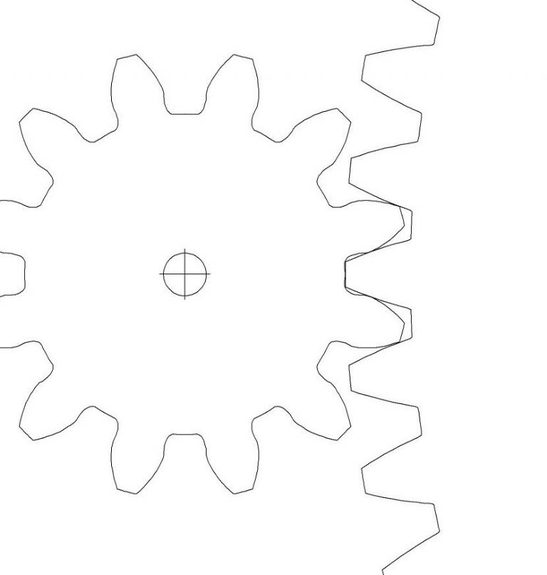

          Have you tried this, Steve ?
          **LINK**
          Online Involute Spur Gear Builder v2
          … from that very clever chap, Dr. Rainer Hessmer
          #613376
          Steve Crow
            @stevecrow46066
            Posted by Michael Gilligan on 13/09/2022 08:54:59:
            **LINK**
            I have used that site before. Here's what it shows for the gears in question –
            The thing is, I don't have a depthing difficulty as such. The gears run smoothly and freely with little backlash and I can live with the extra depthing distance.
            But I don't like the look of the tooth profile on the pinion.
            Steve
            #613386
              Posted by Steve Crow on 13/09/2022 11:51:27:
              Steve
              I’m really sorry to labour this, Steve … and I will leave you in peace after this posting:
              You do have ‘a depthing difficulty as such’ : Your pinion is not sitting at the right depth in the wheel.
              Just compare your photo with the drawing.
              If you are not bothered about the proper involute action, then the teeth could be any old shape you like, and you can run them at any depth you fancy. … but in that case, your opening question would seem irrelevant.
              #613394
              Steve Crow
                @stevecrow46066
                No problem Michael, I appreciate it. I need all the help I can get!

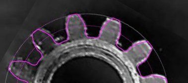

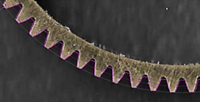

                What bothers me about the drawing is that there appears to be no clearance or play. There are 5 points of contact including one on the root of the pinions. It also seems that the tooth depth is only 2 x Mod.
                I scanned the wheel and pinion again and overlaid the outline from the drawing to see how profiles compare –
                They are a lot closer than I thought.
                Steve
                #613405
                  Posted by Steve Crow on 13/09/2022 14:03:04:
                  What bothers me about the drawing is that there appears to be no clearance or play. […]
                  Although in practice it is impossible to achieve, that is hypothetically correct : That’s what I had in mind when I wrote ‘the proper involute action‘ … in a perfect world the action would be pure rolling without scuffing.
                  Life, of course, is not perfect, but it should be possible to get closer than your current depthing.
