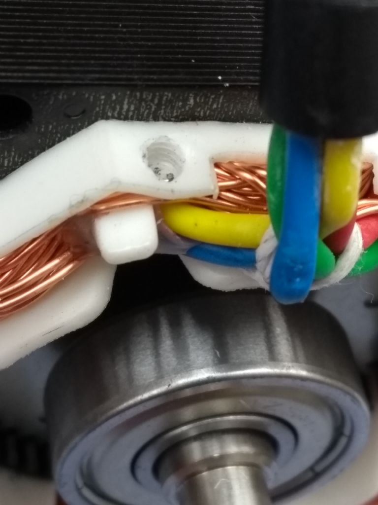

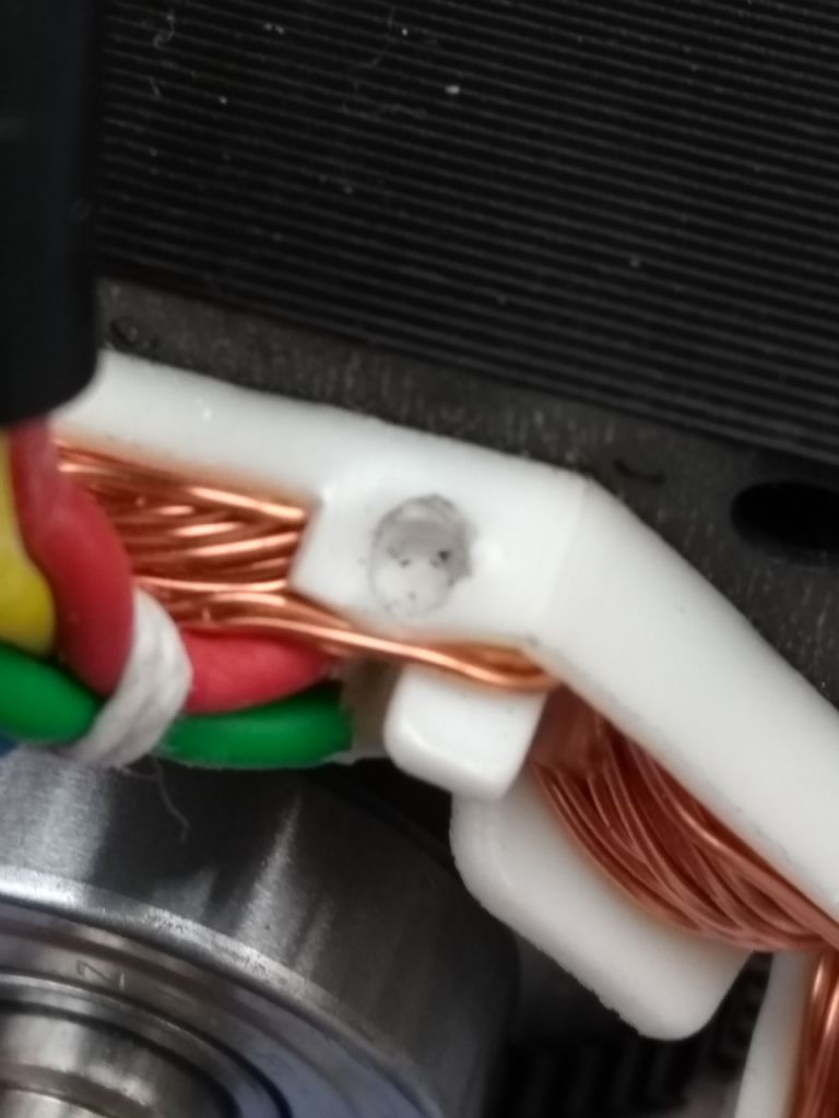

      Posted by SillyOldDuffer on 02/04/2018 11:46:58:
      Posted by blowlamp on 01/04/2018 20:57:11:
      Thanks for all the helpful replies.
      Martin.
      Good job Martin. Isn't it annoying when someone designs and builds something as technically demanding as a stepper motor and then, as in this case, screws up a minor detail?
      Muzzer gets a gold-star for his early diagnosis. I'd have been really impressed if he'd identified the actual cause of the short as well, but that's asking too much!
      Yes, it's very frustrating especially as their performance seems to be very good from what I've seen so far.
      I'm in full agreement with you in regard to Muzzer's diagnosis, but because of his failure to indentify the offending screw(s), I'm deducting one (1) point from his score.
      Some pics below of the issue.
      Thanks again to all contributors.
      Martin.
