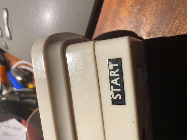

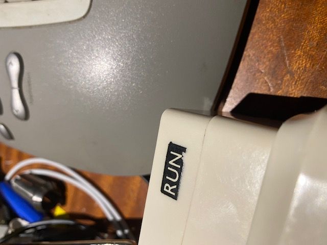

      I recently bought a oldish projector which came with a 5 amp round pin plug fitted also a extension with a round pin socket to a 13 amp plug
      the socket has a switch which is marked "start" in the off position and "run" in the on position
      the plug has "gnome" transfer on it
      it wasnt a gnome product that it was connected to

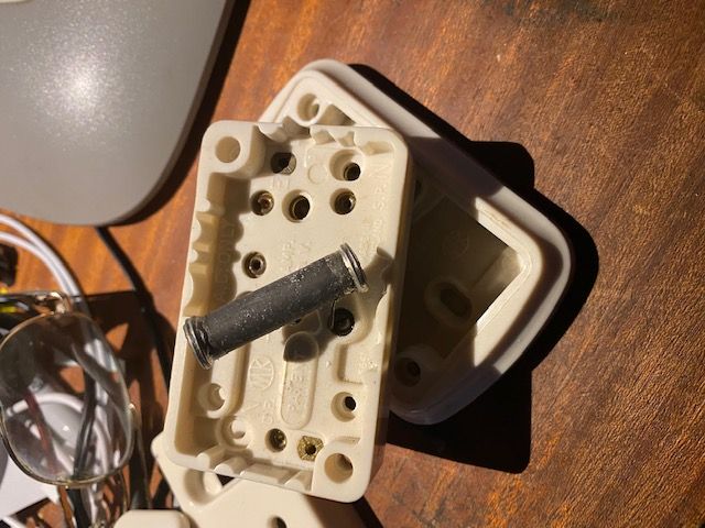

      In the socket across the switch is a 213 ohm resister
      any ideas what this is for ?
      to keep a bulb warmed up in the off position "start" then full beans when in "run" ?img_0056.jpg

          It was to allow the bulb to warm up and so not blow when the power is switched on. Other versions had a NTC thermistor instead of a switch and resistor.

              That 'resistor' looks like a 'Brimistor' to me. I can't remeber whether they were NTC or PTC but my now-vague memories associate them with the heater chains of themionic valve radio receivers of the 'AC/DC' variety. The high tension supply was derived by half-wave rectifying the mains and the heaters of all the valves were connected in series, including a suitable Brimistor, across the mains but with a 'dropper' resistor included to make the chain match 230 volts. Valves were available with high voltage heaters for use in such receivers – they were designed and manufactured to have high cathode to heater voltage ratings. The temperature coefficients of the various components in the heater chain were chosen both to limit 'inrush current' while the valve heaters were yet cold and to stabilise the heater current once the set had warmed up.

                The motor load is probably trivial in comparison with the inrush current of the cold lamp.
                More sophisticated electronic versions are called ‘soft start’ [or some-such]
                … excellent idea when you consider the price of some bulbs.

                      Just in case anyone is puzzled, a "Brimister" is a resistor with a high negative thermal coefficient of resistance. The resistance is high when it is cold and reduces as its temperature rises. So, by placing a Brimister in series with a load, its high cold resistance limits the current surge at switch-on, and as its temperature rises, (due to the current passing through it) its resistance reduces allowing the current to rise to the normal operating condition. This low starting current limits any thermal shock to the load. This operation is normally regarded as automatic which makes me wonder if the OPs equipment was modified in the past and that there was originally an ordinary resister which had to be switched in and out of use.

                        I can't see from the photo, but my guess is that the resistor is connected as a bypass between the two sides of the switch, and also that it isn't a thermistor.
                        Photographic bulbs are notoriously short-lived because they are run at such high temperatures, which firstly causes the tungsten filament to evaporate quickly, and secondly causes a huge thermal shock at switch-on, which administers the coup-de-grace to an already tired filament.
                        I'm sure that the owner of the Gnome didn't want to modify his latest acquisition, so made a special-to-purpose adaptor lead to allow a soft start and make his expensive bulbs last longer. My father made something similar for his slide projector.
