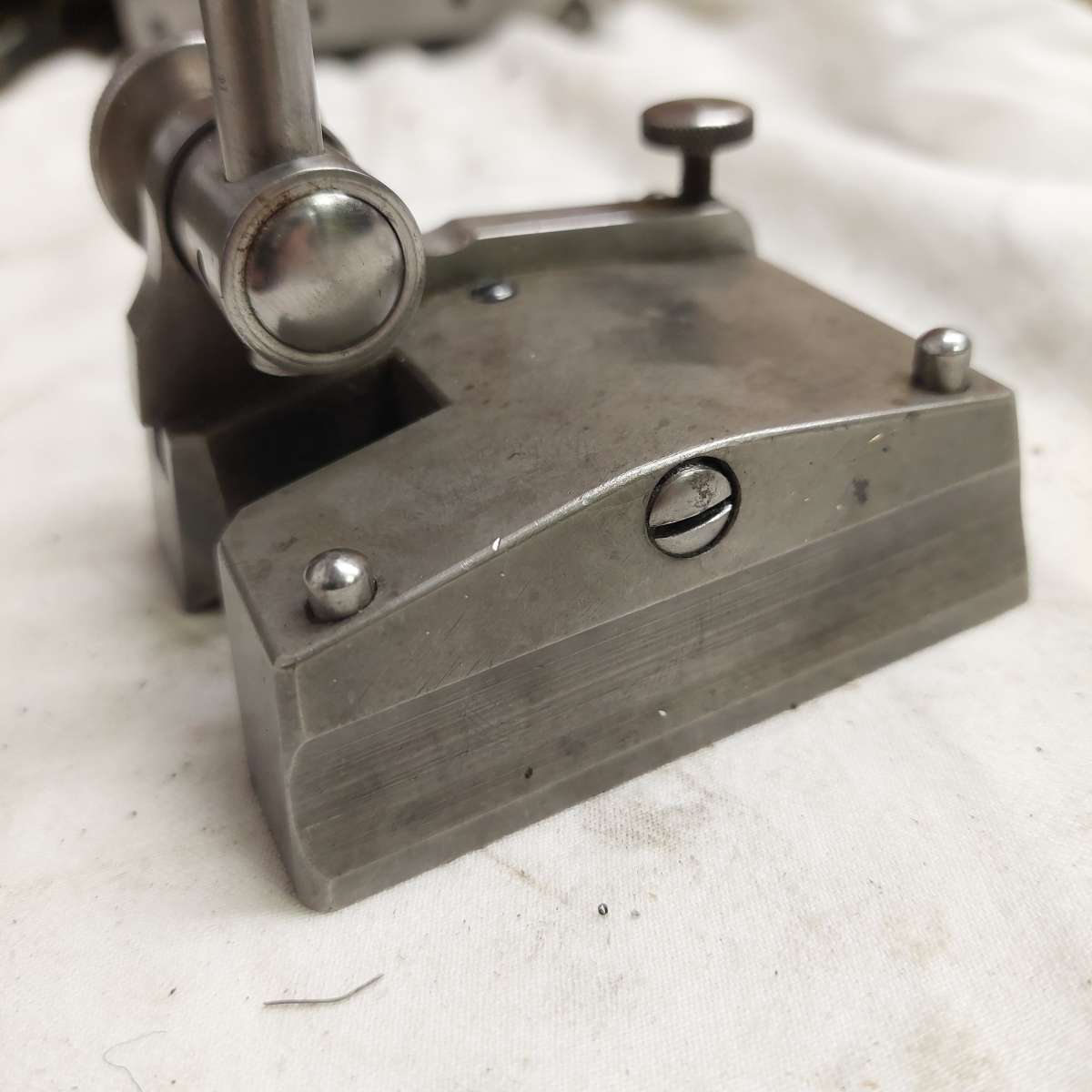

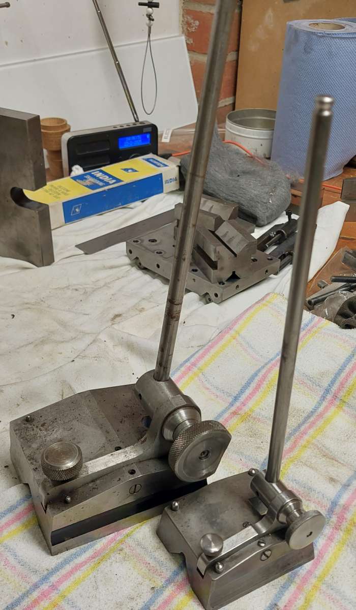

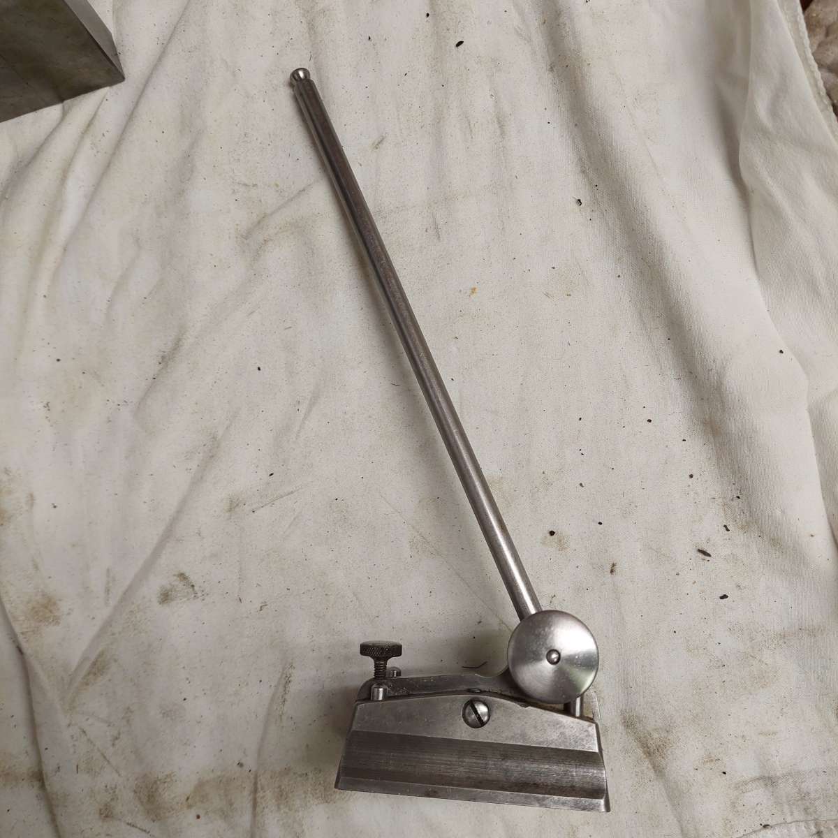

      I’m not sure the best way to do this. I have bought loads of stuff and I don’t know that a lot of it is for. I will probably do one long thread unless anyone has a better idea.20250223_13271320250223_13272020250223_13272820250223_132737
      OK first up..whats this. It feels old and jolly well made. The pins do move, we’ll one does a bit.
      What’s it for please, what are the pins and fine tilt for. Is the v to go on a lathe bed? Thanks

        Use it on surface plate, for scribing lines on your workpiece.

          Marking gauge. Missing the scriber so an early project for you. The pins are let down and act as a limit enabling it to be run along the edge of a table for marking parallel lines.

            It’s a scribing block for marking out work, at the moment it is incomplete but in some of your earlier photos the other part which fits on long round bar and holds the actual scriber is there.

              Hi Beeza   It is a surface gauge. There should be a knuckle clamp which would hold a dial indicator or a scriber. It is used to check flatness or height and with the scriber in place mark out lines parrallel to the base. It is used on a suface plate usualy or a machine bedway with a flat surface. The two pins are used to run along the edge of a piece or surface plate to check parallelism         I have one I made at collage and although I dont use it very much it is a usfull piece of equipment.

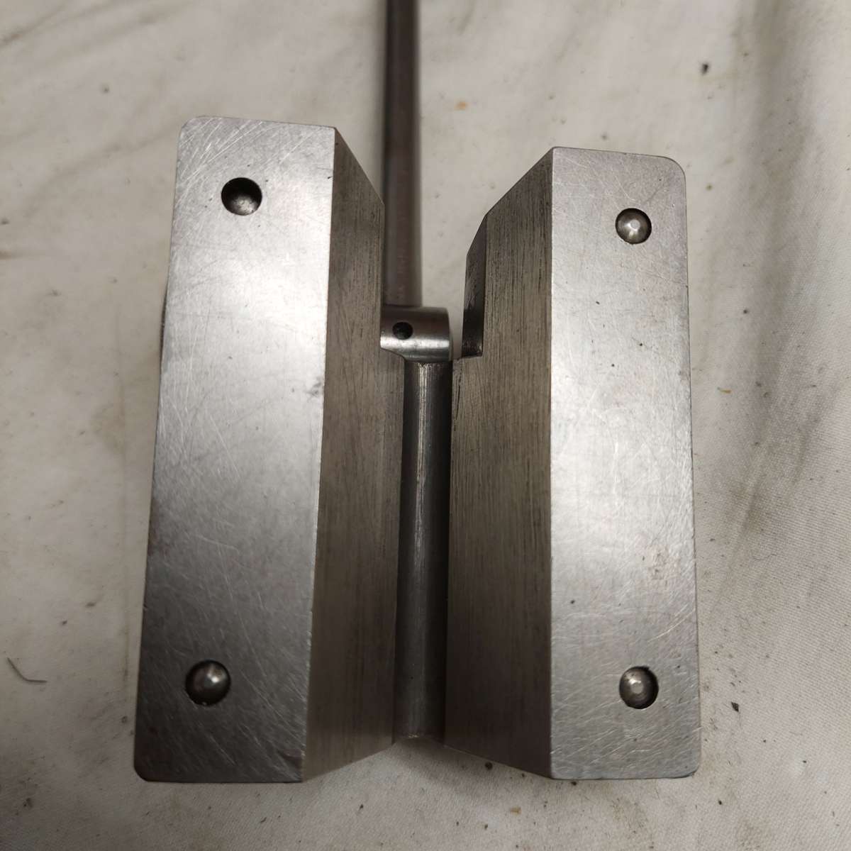

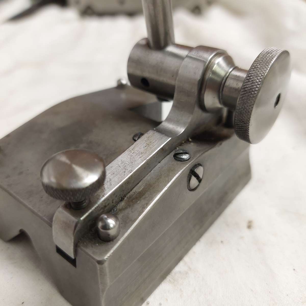

                Thanks for the replies. What’s the fine tilt screw for and the v in the base? There are actually two. The larger one is not shop bought. Surely I will never need two?20250223_140657

                  2 sizes always useful. Or set them to 2 different heights for repetitive work. Tilt screw for fine adjustment

                    The ball ended rod is also upside down, the ball end should be down in the bases front “V” notch and is used in conjunction with both a finger DTI and a reference square, for checking vertical faces for squareness.

                      The Vee in the bottom lets the base sit squarely on a rod or shaft if needed.

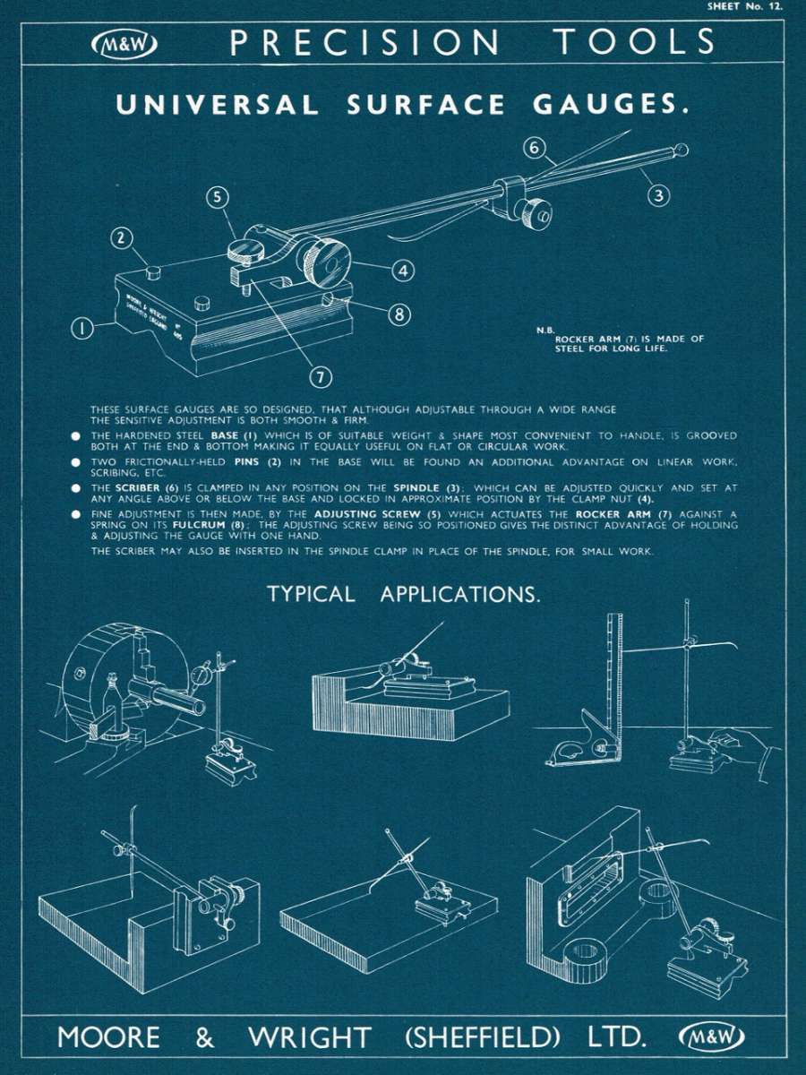

                      Nicholas Farr
                        @nicholasfarr14254

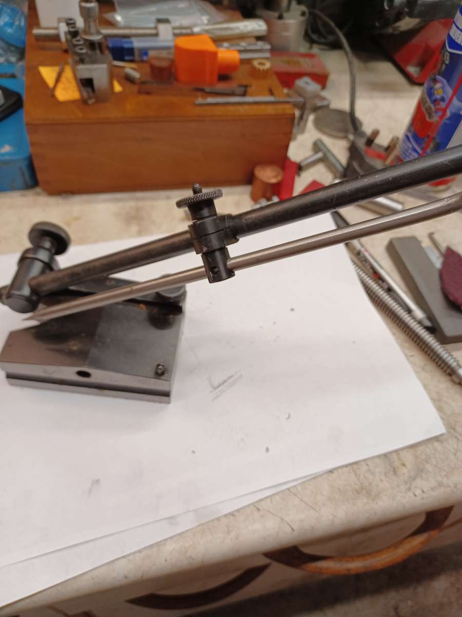

                        Hi, these may answer your questions.
                        Moorite 405
                        Scan_20150811 (961x1280)
                        Regards Nick.
                        #785229

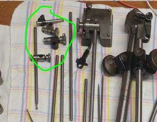

                          These are the other bits that go with them, can’t remember the last time I used mine.
                          bits

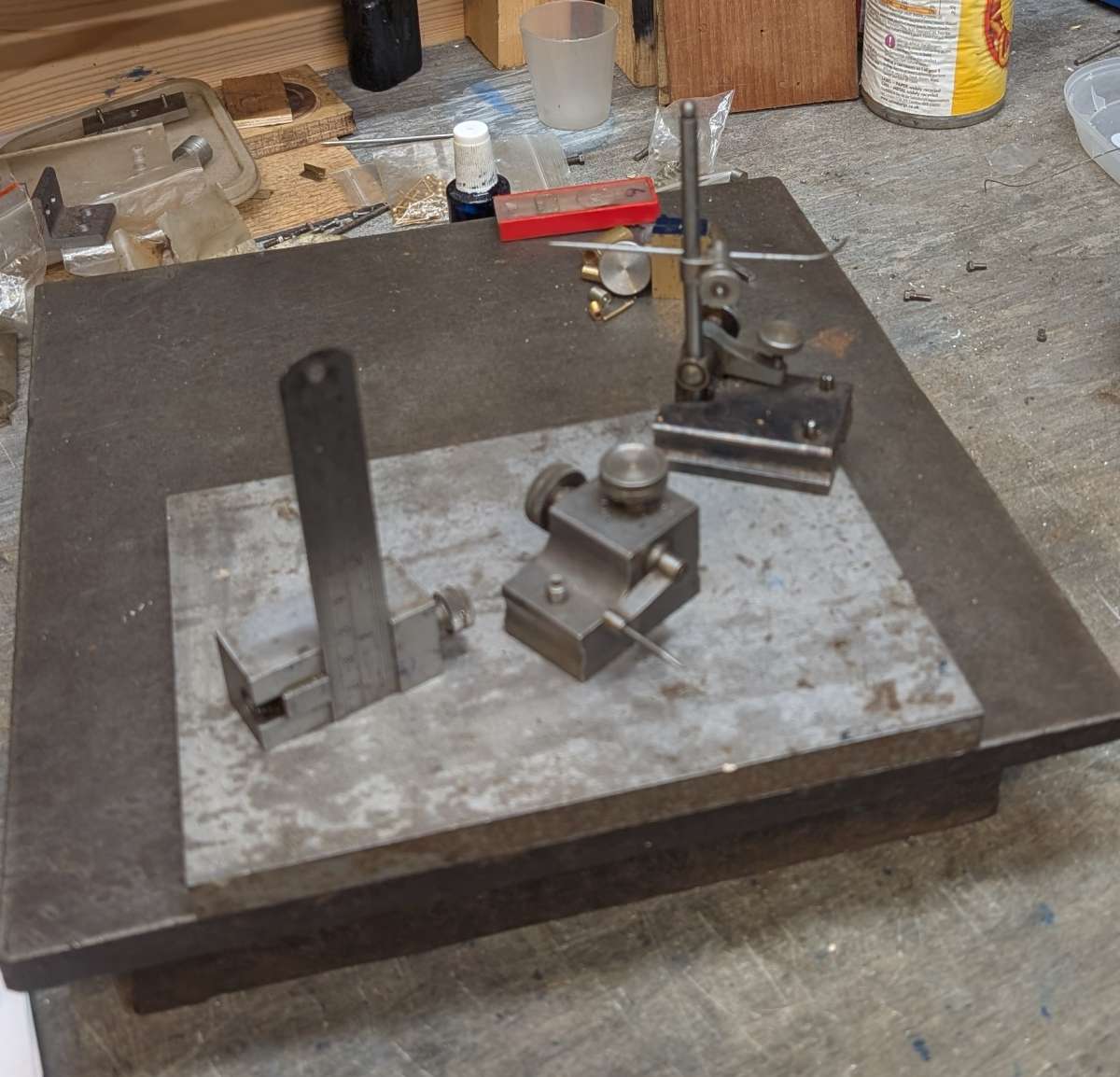

                            Just to drift the thread! I made the GHT scribing block and rule holder ages ago. They get a lot of use. Hardly ever use the Eclipse surface gauge.
                            Scribing Block

                                        Would you write to Messers Moore and Wright and avail them of this fact please, as their diagram above also repeats the error that you point out.
                                        It might be simpler to say that the device has an application in which the rod is used with the ball end at the bottom.
                                        Having the ball at the top 90% of the time allows you to tuck the bent end of the scriber into the recess below it, reducing blood-letting potential.

                                          I was taught that the ball at the top of the surface gauge post was to assist in replacing the knuckle on the post after it has been removed for some reason. The fit between post and knuckle is very precise on surface gauges made by reputable makers and it is difficult to line up the knuckle so that it will slide onto the post if the post has a plain end. It’s much easier to fit the knuckle onto the ball, which is exactly the same diameter as the post, and then align and slide the monkey onto the post.

                                            The ball serves dual purpose. Left at the top it allows for easy fitment of clamps onto the stem. When slid through and the holding clamp rotated so that it is now at the bottom, it forms part of an assembly for checking squareness of standing items like bottle squares and angle plates etc.

                                                The two, pins in the base of the Scribing Block (surface gauge) are meant to push through so that they protrude slightly and can be butted against a machined edge, such as on a Surface Plate, or the edge of a lathe bed, to provide a definite datum location.
                                                If you can’t fond a suitable source for the “monkey block” to clamp the scriber, you could always make one
                                                Ditto for the scriber.
                                                The illustrations of the Moore and Wright catalogue (And the items circled in green by Jason) will show you what you are looking for.
                                                The scriber could be made from a piece of 1/8″ mild, or silver, steel, carefully ground to a point at each end, and then one end bent around a suitable piece of bar or tube, to form the curved end.
                                                Making the monkey block could be an interesting and informative exercise, as an introduction to machining.
