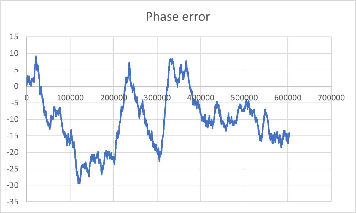

          Screenshot 2024-05-06 102237
          Talking about mains frequency stability there’s nothing like data.  This website:
          https://bmrs.elexon.co.uk/rolling-system-frequency

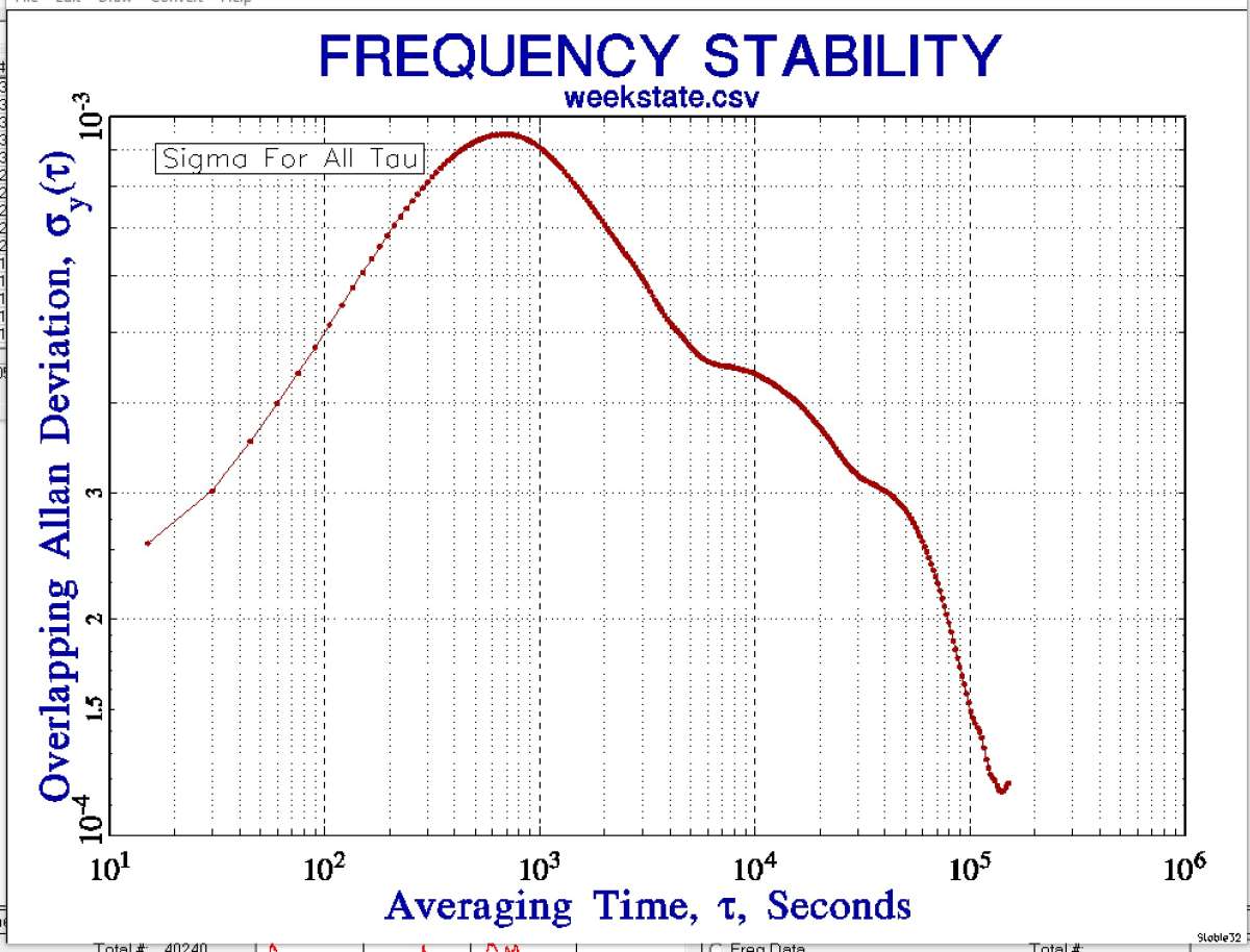

          …gives records of rolling system frequency at 15s intervals from which I downloaded the last week’s worth.  The first plot above shows time error of a clock using the mains frequency as a reference over the past week.  Basically within +20/-30 seconds, not so good.  From the data we can also plot the Allan Deviation which is in many ways a more useful measure of stability. It plots a “standard deviation” against averaging time.  Assuming I’ve driven the program that generates it correctly (Stable32) it shows that over the last week a clock looked at every 15 minutes would have a standard deviation of 1 part in a thousand.  Stability is better for shorter and longer averaging times, but certainly not comparable with a quartz clock.  Since there’s only a weeks worth of data we can’t see what happens for much longer averaging time, the Adev certainly seems to drop precipitously though there’s a slight hook at the end.
