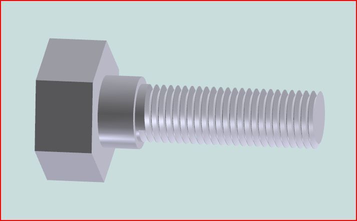

                                        Ok this is the application: trying to cut a threaded hole in the bolts for the cranks on a mountain bike. I’m making my own frame from a few old bikes, the idea being that once i get the frame right il get it copied by a reputable frame builder and live happily ever after. I have already made the jig and just unsure of the best way of bolting the bottom bracket complete with cranks to the jig in a way that gives some left right adjustment. The bottom bracket bolts that hold the crank are m8x1 which even the nearest fastner shop can’t get (in small quantities). I have made a proof of concept frame already, but was unsure of my welding so that was just carefully eyeballed and shimmed with blocks of wood and jubilee clips as i didn’t want to potentially waste time making a jig. It came of so close to perfect i darent cut it until i make a better frame. Btw, so long as the thread has no play i can take a datum from the jig. Thanks
                                        #154079
                                          I'd be wary of holding the BB spindle to the jig just by a bolt in one end and relying on the small contact area at the end of the spindle to keep things true.
                                          Better to have a substantial spigot 20-25mm dia with cones on that will centralise the BB shell and can be adjusted latteraly by spacers. Most of the jigs I have seen use this sort of setup and the one my Uncle who was a well know South London frame builder used also employed this method.
                                          If you are going to bolt it to the jig then set the jig up so you can use the right hand threaded side not the lefthand

                                              id be inclined to think a series tap is what i need and the drilled and reamed to shank size on the tap? when i originally posted i didn’t know of series taps

                                                    When I designed my frame I went with oval section fork blades for teh chain stays to get a bit more clearance, but things have moved on a bit since then, don't think Rockshoks had been invented back in '89.
                                                    You would be better off making a bolt with a plain section that will be a good fit in a hole in the jig and then the M8x1 thread beyond that, something like this. By adjusting the fit of teh die you will get a good fit in the crank axle.
                                                    J

                                                      thanks, il look at m8x1 dies
