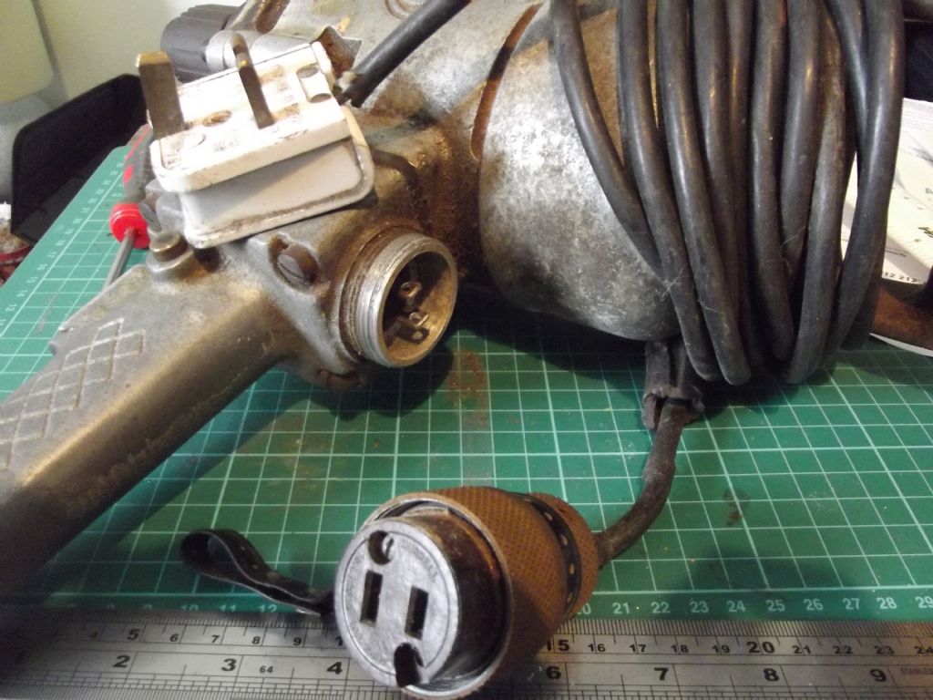

                                                  #189190
                                                  Rainbows
                                                    @rainbows
                                                    Oh my good lord it is absolutely massive, must have originated in a ship builders or something.
                                                    Also is this an american plug? Screws into the body. Considering it has AC universal on the name plate I am wondering if this is designed to work with a wide range of voltages.
                                                    Edited By Rainbows on 09/05/2015 11:30:46
                                                    #189195
                                                    Russell Eberhardt
                                                      @russelleberhardt48058
                                                      "Universal" usually refers to a motor capable of being used on ac and on dc. It doesn't mean it will work on a wide range of voltages.
                                                      Russell.
