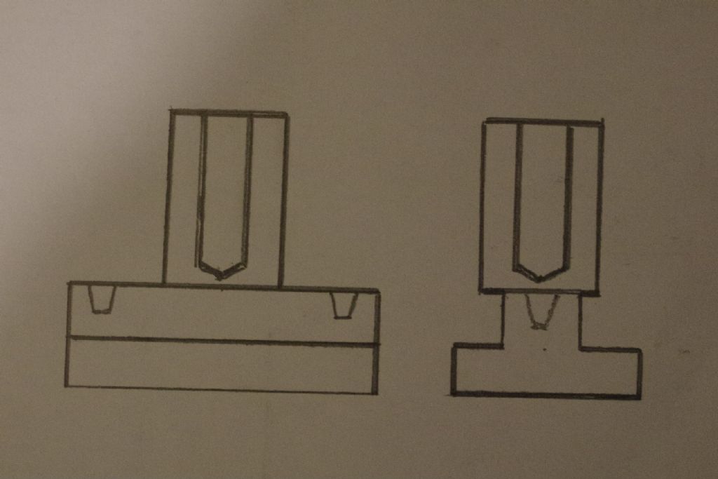

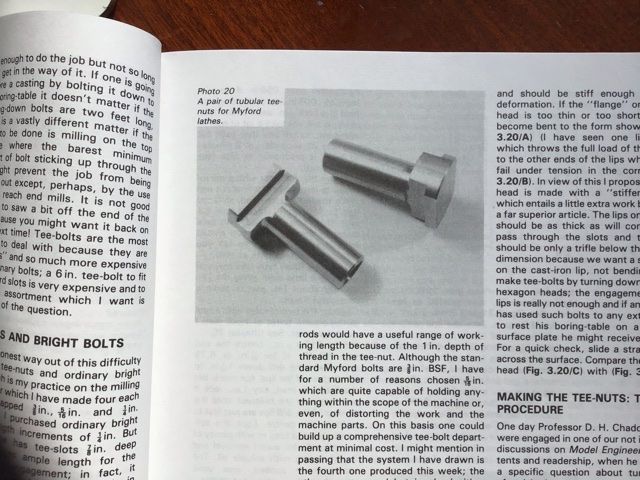

          I think these are what was being referred to.
          from GHT Model engineers workshop manual.
          Mike
          Edited By Mike Poole on 19/09/2020 13:20:05

              Is it because they are used as a bushing sort of . So the thread of a normal t-nut has side play in whatever is being clamped. Where the tubular ones would be a snug fit stopping any chance of side slip. Trouble there if i am correct you would need lots of different sizes.

                Well, they could give a greater length of thread engagement than the plain type, but you pay for that in the smaller thread diameter.
                You could get more precise location, perhaps to holes in the base of whatever they're retaining. Same price, plus fiddly and potential binding whilst sliding along slots.
                Difficult therefore, AFAICS, to justify an unrestrained paean of praise… laugh

                    I think the tubular bit is bigger diameter than the width of the the tee slot so you can get a bigger thread in. Having said that you can easily get 1/4" or M6 thread into a normal nut, and that should provide enough clamping force for a fairly light machine like a Myford

                      those pictured are how I make them. Mainly because I can make several at a time in the lathe from a length of bar. Turn the bigger diameter along the whole piece, then the tapped hole, then the smaller diameter using stops and part off. Add the flats for the T-slot putting as many as you can fit in the mill vice.
                      Using my 5" lathe is much quicker and easier than using the mini-mill to make the whole part.

                        GHT makes it clear somewhere in his writing that the point of the tubular T nut is that the longer thread engagement means you can have a set of T bolts at longer intervals than with regular T nuts and still be able to grip work of any intermediate size.
