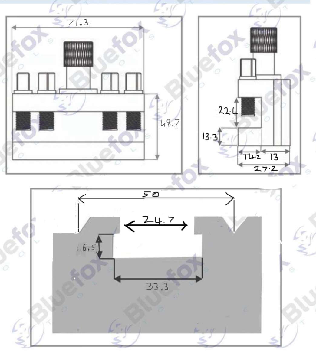

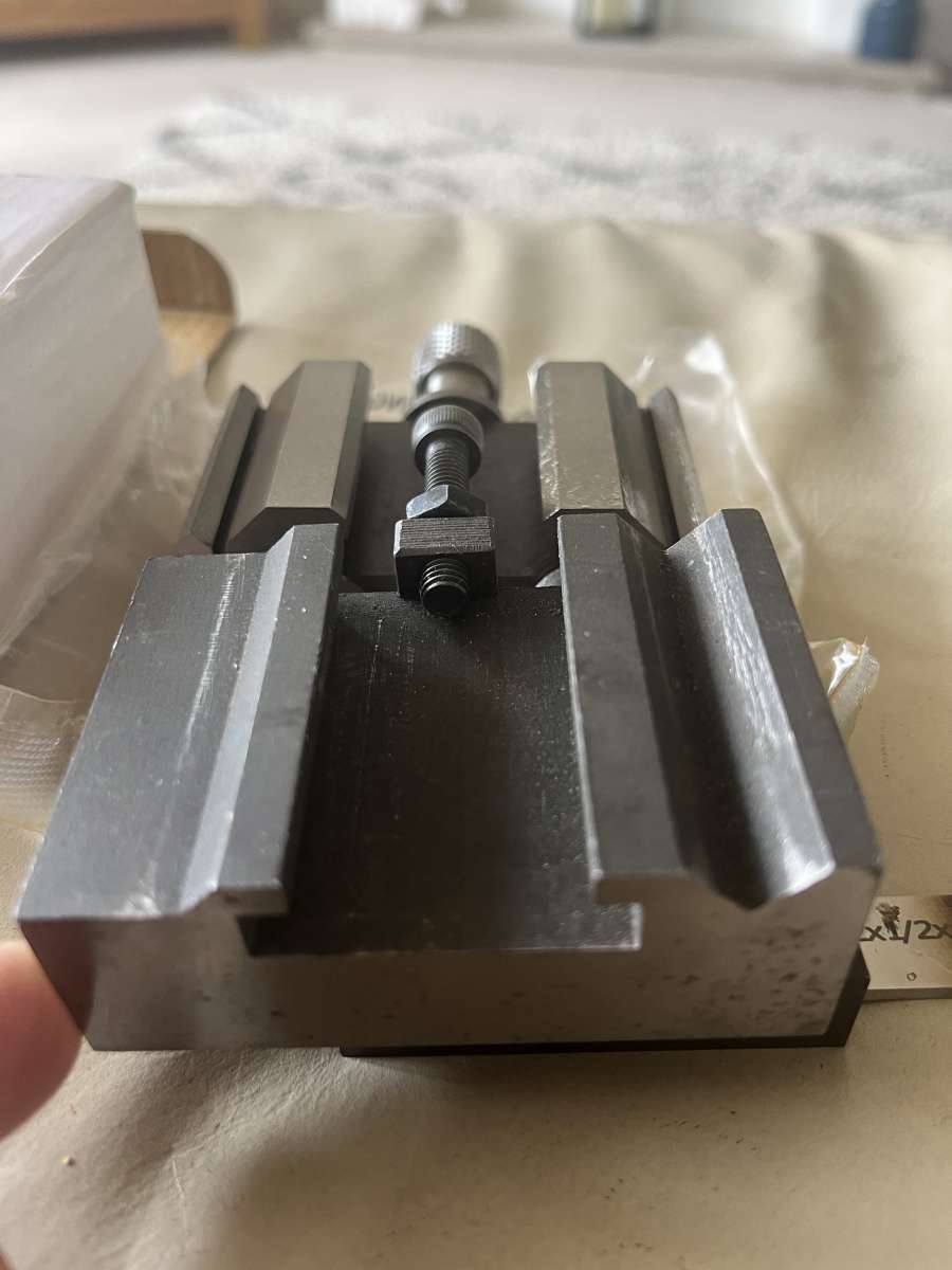

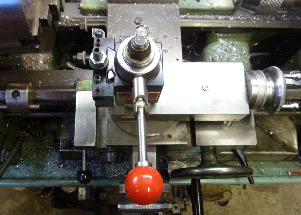

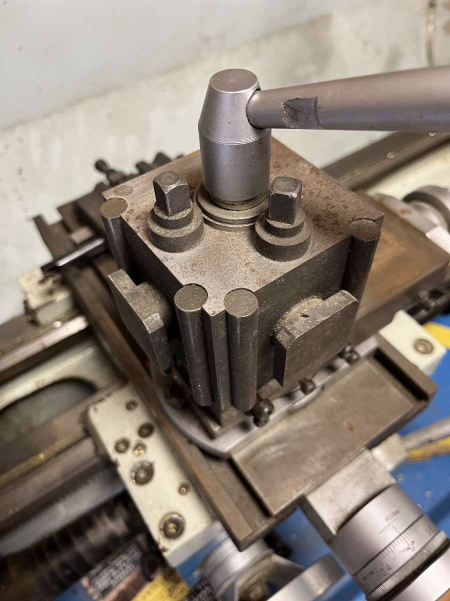

      Good Morning engineers.
      I’ve got a 250×750 Amadeal lathe, and a few years back I bought a QCTP for it and have been happily using it since.
      I’ve decided to purchase some more tool holders for it, but am struggling to find the correct size.
      The box that the QCTP came is states; “NEW SWISS TYPE T-63 QUICK CHANGE TOOL POST WITH 3 HOLDER AND 1 PARTING HOLDER”
      I’ve ordered a T63 parting holder from RDG and it doesn’t fit on my tool post.
      Comparing mine and the new RDG tool holders, the biggest difference seems to be the distance between the V’s. RDG is 60mm, mine is 50mm (although I only have a single V on my tool holders). All of the T63 references online also appear to have a 60mm spacing between centers.
      I’ve spent quite a few hours researching, and am still none the wiser.
      IMG_7795IMG_7791IMG_7796Does anyone have any ideas please.

        Hmmm. Does the adjective “type” refer to the nationality or the pattern?
        #730622
          I have probably lived a very sheltered life, but I don’t recall ever seeing rods used like that on a tool-post.
          It’s reasonably common on focus rails and such … but  it may be a ‘distinguishing feature’ amongst T63s

            I agree with MichaelG, the only thing resembling Paul’s are a tool-post made by Harold Hall, see here: http://www.homews.co.uk/page518.html
            Thor

              “I have probably lived a very sheltered life, but I don’t recall ever seeing rods used like that on a tool-post.”
              The Radford quick-change tool-post uses rods in a similar way but is a home-made system and not a design that is available commercially. (BTW, it is far superior and convenient to use IMO than any off-the-shelf product for a ‘Myford’ size lathe.)

                They seem to have been commercially available, and I can vaguely remember them.
                Google reverse image search comes up with this on an M300 lathe sold by GM tools, but the advert is now deleted
                image_2024-05-14_144206664
                Maybe check the Dickson measurements on Tony’s site
                http://www.lathes.co.uk/latheparts/page13.html
                Other folk list T63 sizes to compare.

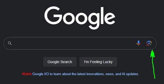

                    On Paul Mercer Said:
                    Bill, that’s amazing that you can search for images, something I was unaware of.
                    It’s actually very easy; head for the Google web search directly, rather than using a search box in your browser; clock on the right hand icon, and all should become obvious.
                    You can upload an image, specify a URL of an image, or just up[load a snip screenshot. (I use snipping Tool in W10)
                    image_2024-05-14_221942770
                    For something slightly more powerful try this website, which works in a similar way, but launches three searches, the above Google one, Bing & Yandex.
                    Just be careful you don’t install various bits of trial software by accident
                    https://smallseotools.com/reverse-image-search/

                        Re the (T63) Dickson style, I’d try and make sure you get a block and holders all from the same supplier.
                        They are supposed to conform to standard dimensions, but not all makes are compatible with each other.
                        I have a couple of SE Asian toolposts that came with my second hand Warco 720, (S7 clone) which work fine, albeit a smaller size than your T63s.
                        A genuine original Dickson older fits it fine, but some of the others don’t quite lock with the lever. Either the bolt goes over centre and it comes loose that way, or it doesn’t go far enough and fails to lock sufficiently.
                        Since the genuine holder works fine, I have to assume the two toolposts are OK and the fault(s) lie with the holders.
                        On my larger GH1330, I have the Warco piston style, which works well enough with all my holders, sufficiently well that I bought   a second one in a sale to use on the Myford S7 in lieu of the top slide. I’ve not yet made the adaptor, but the idea is that it will be more rigid, along the lines of a Gibraltar toolpost, but with the advantage of having a quick change as well. The plan is to set the centre heights to work out correctly for both lathes, so I can chop and change tools between lathes without re-setting anything.
                        There is a second variant of that style, which uses the same toolholders, but rather than a piston for locking, one side of the dovetail acts as a moveable wedge. There’s a few Youtube reviews, though I don’t recall where.
                        I think they are more affordable variants of The Aloris Style
                        I think now I would probably go for one of those.
                        This style of toolholder with just a large dovetail groove is also easier to replicate of you want some spares, as I did here.

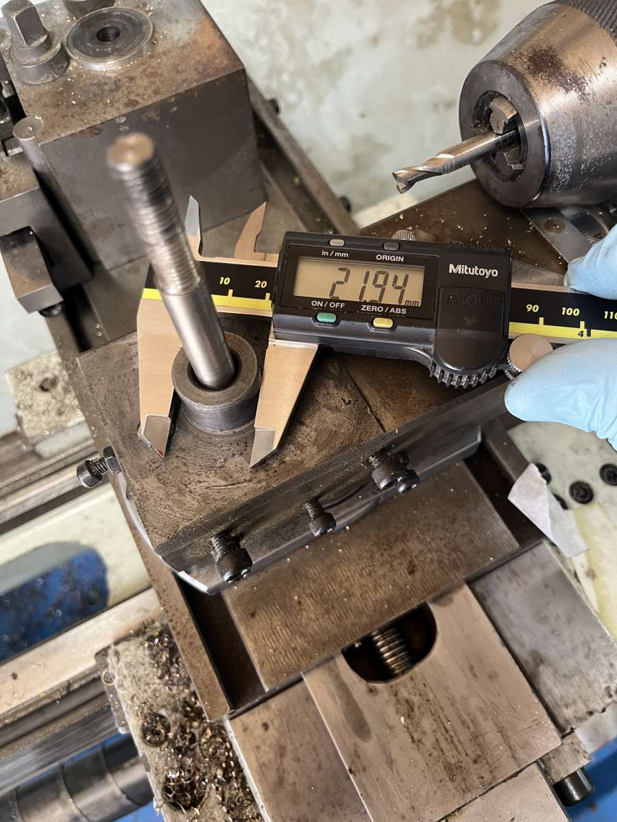

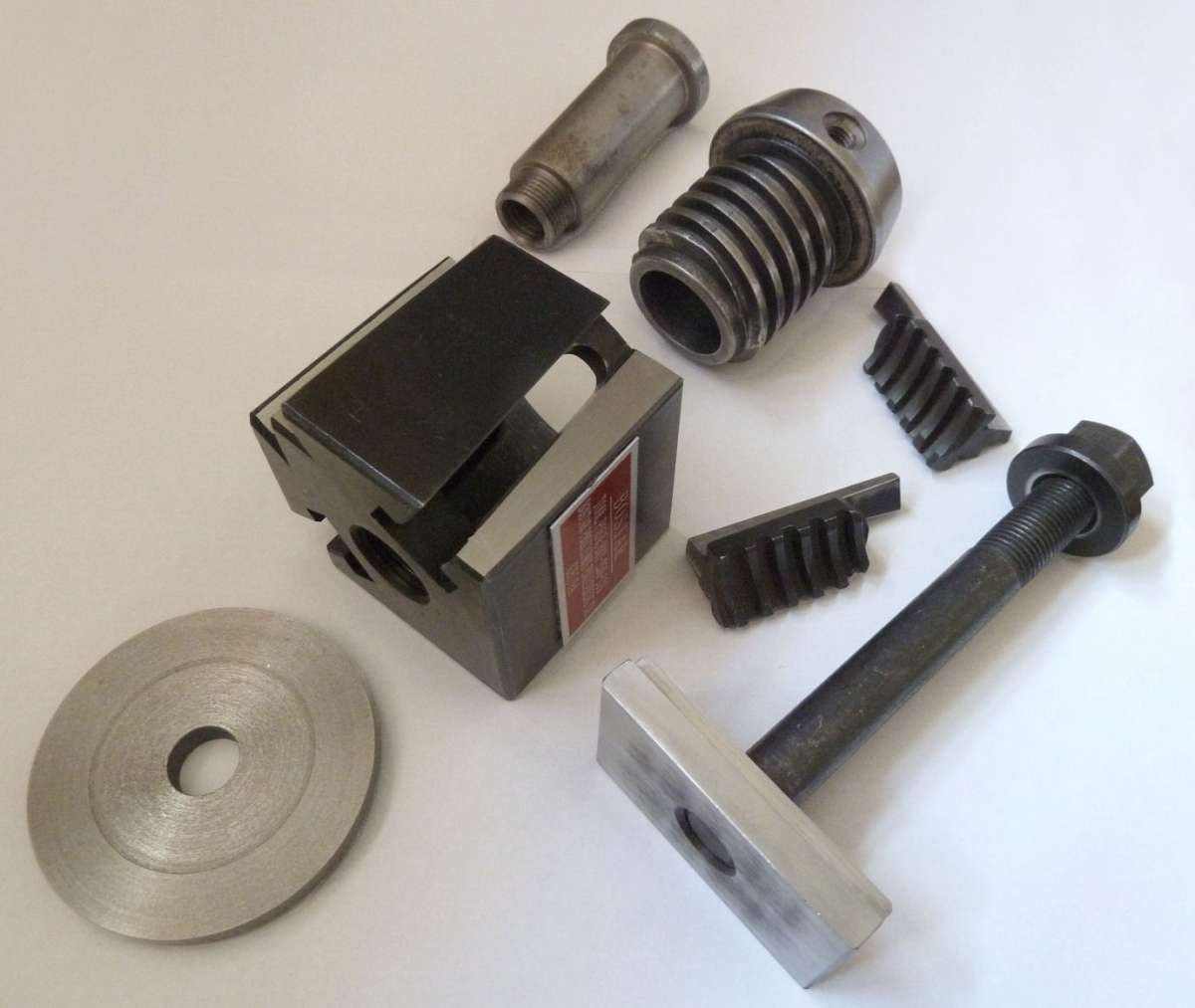

                                For anyone that stumbles across this post, also looking for the same tool holders; I’ll probably chuck my old ones at the back of a cupboard. If you could make use of them, they are yours if you cover shipping.
                                my lathe is an AmaDeal 250V x 750. (I’d already replaced the tool post with an unknown brand qctp) Alternative models are: Precision Matthews PM1022 PM1030, Grizzly G0602, Seig, Husky pc36, and a Craftex cx700
                                The boss on my cross slide limited which tool post I could fit. My solution was to machine off the boss and drill the hole out to 12.5mm  I then tapped it with 14×1.5 which is the thread that the model 100 QCTP from ArcEurope comes with. The model 100 simply fit onto the newly machined cross slide. Now that the boss has been removed, I suspect the wedge tool post would fit as well.
                                IMG_7845

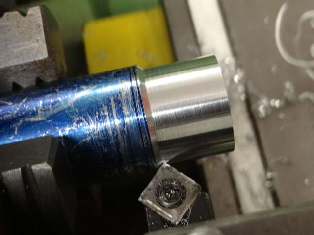

                                        #732371
                                          On Nick Wheeler Said:
                                          On SillyOldDuffer Said:
                                          On Ex contributor Said:
                                          How many holders is the optimum to have , Dave ? Usually one more than you have to hand ! I would be interested to know your “disadvantage” to QCTPs – can’t say I have come up against one, but do enjoy the advantages…
                                          Here’s the case for the prosecution!

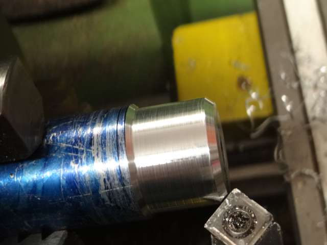

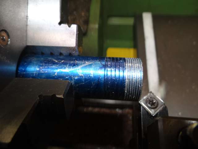

                                          Consider a simple, common part like a stepped bush: it needs two diameters and two faces that will need two tools(unless you’ve expended time and/or money on a tool that can do both), then a hole through the middle(tailstock job, but at least a spotting and through drill), all the edges chamfered(you did make a tool that can do all of them without a change didn’t you), parted off, remounted and the new edges chamfered. That’s at least four carriage tool changes and another 2 tailstock ones which is marginally acceptable for one part. …
                                          Or maybe not!  Mounting a drill in the tailstock doesn’t count because that doesn’t need a QCTP/

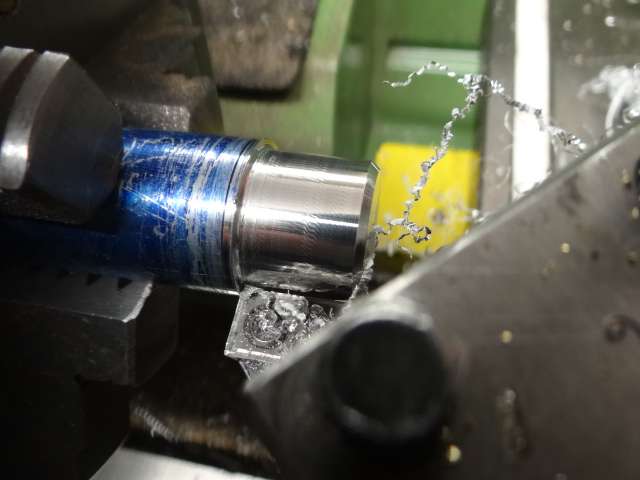

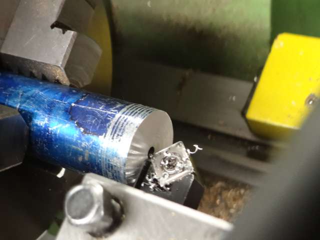

                                          Here’s how I might do it with a single insert tool.  (Not shown but I could have a parting-off tool in the 4-way at the same time.)
                                          Step 1, a 4 cornered insert that can face, cut and chamfer.
                                          DSC06830
                                          Step 2, face off.
                                          DSC06831
                                          Step 3: turn the diameter.
                                          DSC06833
                                          Step 4: chamfer the end.
                                          DSC06834
                                          Step 5, rotate the tool-post to square off the turned end
                                          DSC06835
                                          A features of inserts that may be missed is that they can cut on all the edges.   Without changing anything I used two different points and an edge to do the chamfer, then finished off simply by rotating the tool post.  The cutting edge of the insert was at the correct height throughout.   Unlike HSS shaped by hand, it’s often possible to save time by exploiting triangular, square and round inserts.   And once the shim heights are known for each holder,  they can be quickly changed in an ordinary tool-post.
                                          Admittedly the last step isn’t ideal because cutting with a square insert edge on tends to spoil the finish by smearing swarf into it – there isn’t enough relief.  I could fix that by deploying a different insert holder, and there would probably be room for it in a 4-way with a parting tool as well.
                                          All in all I’m not seeing much advantage in a QCTP.   As I said earlier, the main benefit of a QCTP is in an HSS only shop.   Of course, it’s inserts that speed up the 4-way.   Holding conventional HSS in a 4-way tool-post is much slower than a QCTP: I’m not recommending that!

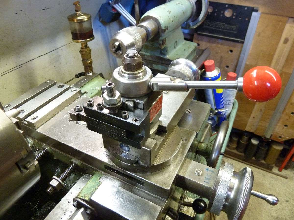

                                              “A QCTP is a flimsy bendy affair compared with a 4-way tool-post, and further reducing the limited rigidity of a small lathe may be undesirable”.
                                              I would take issue with that contention, though do not have a mini lathe. Indeed, in my experience an AXA wedge QCTP has proved much more rigid than the four way tool post it replaced, and indeed is as good as the “Gibraltar” which is now only required if a 20mm height “just in case” tool is needed. Surprisingly perhaps, parting off causes no drama with the AXA, both with the seemingly inadequate special holder supplied (but it is a Chinese copy of the original Aloris), and also with a 12 mm slotted blade holder clamped via the tool holder screws.
                                              AXA View
                                              The one snag I had was that the clamp handle blocked the view of the cross dial, so a foldable handle was devised. You can also see that I merely used a round spacer to reach optimum mounting height. Finally, the original USA origin of the design shows though, concentration on what is necessary to work well, and elimination of unnecessary features.
                                              AXA Mounting
                                              AXA-parts
