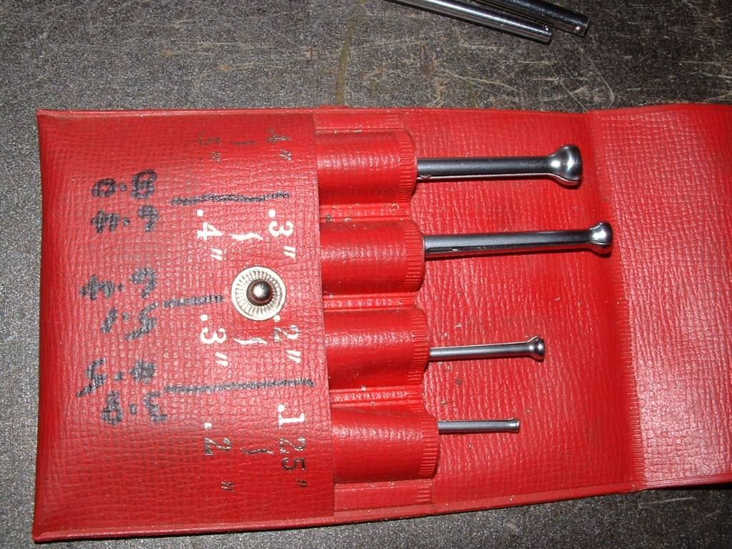

          Emgee
            @emgee
            Darren
            I use these on small bores, fit the gauge in the bore and then measure over the gauge with a micrometer.
            You may have to turn a stub piece to the finish size needed for checking as you make the shaft.
            The top set are split and the bottom set have 2 balls to measure over.
            As with all gauges of this type you will develop a feel for them the more you use them.
            Emgee

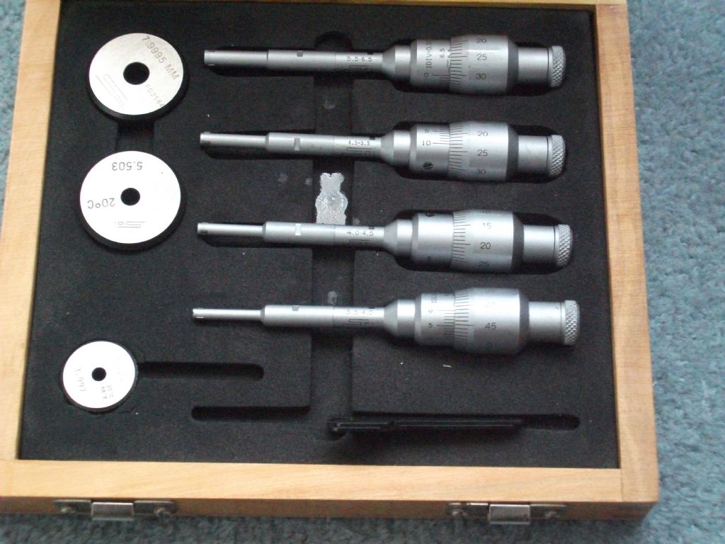

                        John P
                          @johnp77052
                          Hi
                          I've woken up now and taken a photo of these micrometers ,of course they
                          only read to 1 um ,made by Spi not as good quality as Mitutoyo but they
                          are plenty good enough for use in the workshop ,as far as i can remember
                          they worked out at about £105 each they do sell them individually but
                          work out more expensive this way as the setting rings are not supplied.
                          The smallest here will measure into a depth of about 16 mm.
                          Edited By John Pace on 01/03/2021 09:48:19

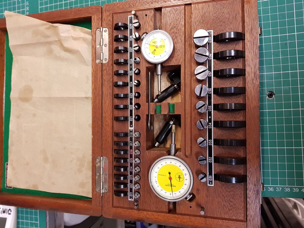

                                    jimmy b
                                      @jimmyb
                                      This set goes from 1.5mm to about 20mm. allows easy measurement to 0.002mm.
                                      Around £200+ on ebay. (this set was a bargain at £75!).

                                              Nicholas Farr
                                                @nicholasfarr14254
                                                Hi, I have a M&W small hole set, same style as the twin ball ones that Emgee has shown. There is ten sizes in my set, four small ones from 1.59mm to 3.2mm and six larger ones from 3.2 to 12.7mm. I bought them off a guy I used to work with some years ago, for about a fiver, he got them in a job lot of tools he bought from a boot sale, but didn't have a use for them. I said is a fiver all you want and he was adamant that was all he wanted for them, I mean, who was I to refuse.
                                                Regards Nick.
