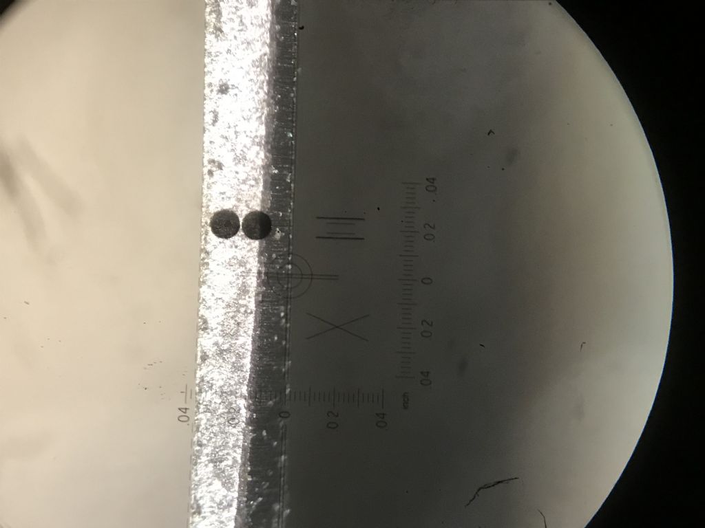

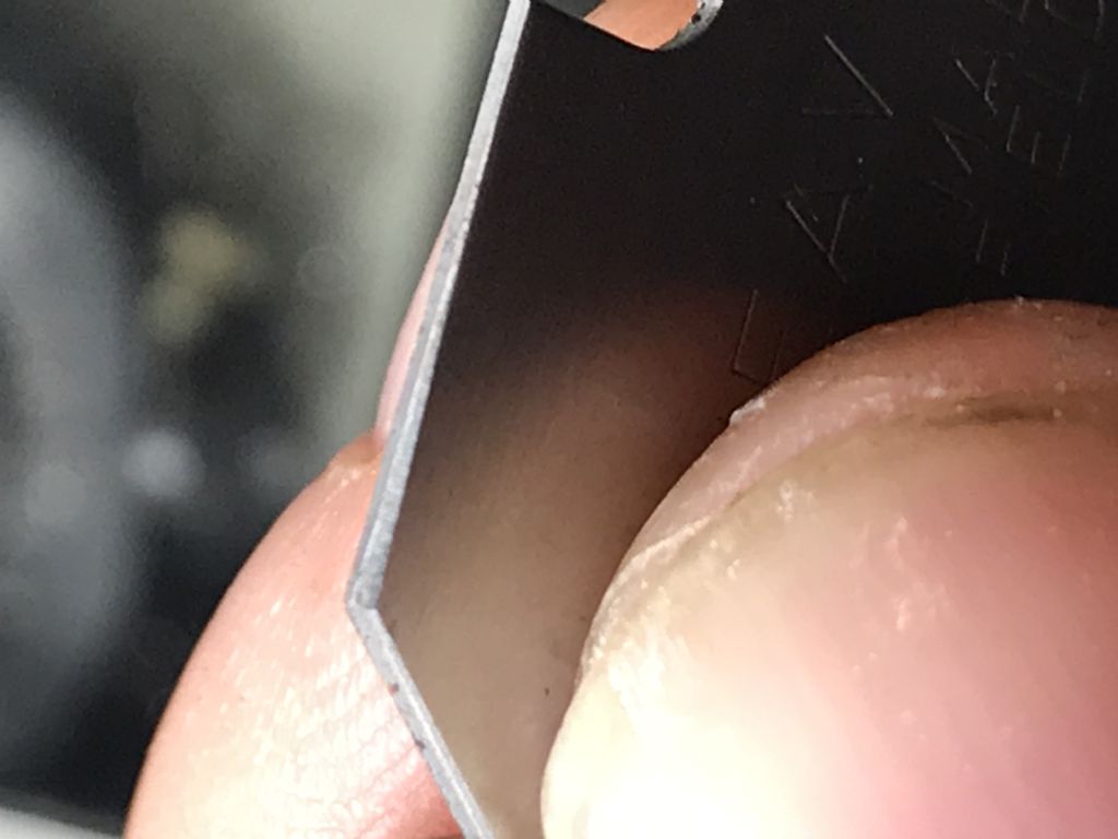

          In the interests of this thread I have wounded a Stanley Knife blade:
          I just boshed a 45ish degree 'radius' on the back edge with a diamond stone.
          This is the (quite poor) photo through an inspecion microscope:
          measurment of a radius on an edge is potentially doable in this manner, with the bonus that you can inspect the finish as well.
          Inspection microscopes, unlike dissection ones, have an x-y stage under them. This one is imperial – it does 1/10000" on its dials. I also have one with 0.001mm micrometers.
          Fixturing is not hard – there is no force. This would be adequate for instance (took it after, when I though a fixture photo would be useful, hence the upside downness of the blade):
          As you are planning on subbing out this work once a spec is figured out you need to also think about how you are going to inspect and reject sub standard parts.
          If a spec came to me saying 0.25mm radius I would look at it and think about:
          A: Quote high enough that the work buggered off, or paid a hansome profit for actually doing the job properly
          or
          B: just break the edge like we always do and hope no one notices…
          If its important enough to spec then its important enough to check.
