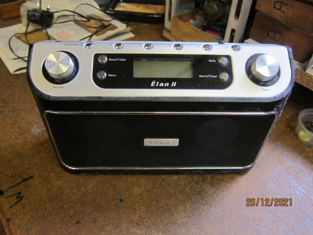

      Greensands
        @greensands
        Merry Christmas all – I have just been given for repair a small portable radio which is suffering from the sticky case syndrome, not the first I have had with this problem but something I have never been able to overcome. Previously I have associated this problem with he older models but this current example is a much more recent product. Has anyone come up with a solution to this problem?
        #576688
        J Hancock
          @jhancock95746
          The 'rubber/plastic has been 'reconstructed ' into another polymer , no way back.
          #576689
          Grindstone Cowboy
            @grindstonecowboy
            I did once have remarkably good results with hand sanitiser, but it was probably just the alcohol content. Worth a try with IPA at your own risk.

            #576692
            Clive Foster
              @clivefoster55965
              I've had some, generally intermittent, success by working through the gentler solvents I have about the place. Things like neat washing up liquid, isopropyl alcohol, computer screen cleaner, foaming aerosol cleaner (RS breed in my case), sticky label remover, Jizer, Gunk, et al. Apply a little at a time on small areas and rub.
              If you can find the right one the results can be good for a year or so but there seems to be no lasting cure. Lots of effort for little reward. 50% success is doing well methinks.
              Wear disposable gloves because a seriously wrong cleaner pick will create a super sticky gunge that seriously doesn't want to wash off your fingers.
              I have the impression that regular use of foaming cleaner holds back the deterioration can prolong the life of a cleaning session. Letting finger sweat marks build up to the sticky stage seems to be a fatal mistake as the sticky seems to spread from such marks.

              #576695
              Frances IoM
                @francesiom58905
                I have used surgical spirit because I have a large quantity bought cheaply pre-covid (mostly Iso-propyl) and kitchen paper to wipe off the gunge then use a slightly abrasive kitchen cleaner to remove the oily residue left by the SS but though works for a time the surface can go back to its sticky state – suspect usual Chinese trick of saving money by removal of a key plasticiser in manufacture of the plastic

                                              #576819
                                              Greensands
                                                @greensands
                                                A couple of photos to illustrate the radio in question and extent of the problem at the back of the case.
                                                #576821
                                                KEITH BEAUMONT
                                                  @keithbeaumont45476
                                                  A lot of high quality plastic items are made from Polycarbonate and Acetone will have a very bad effect on it.It will create micro cracks in its surface,so is not recommended as a cleaner in this instance.
                                                  Keith.
