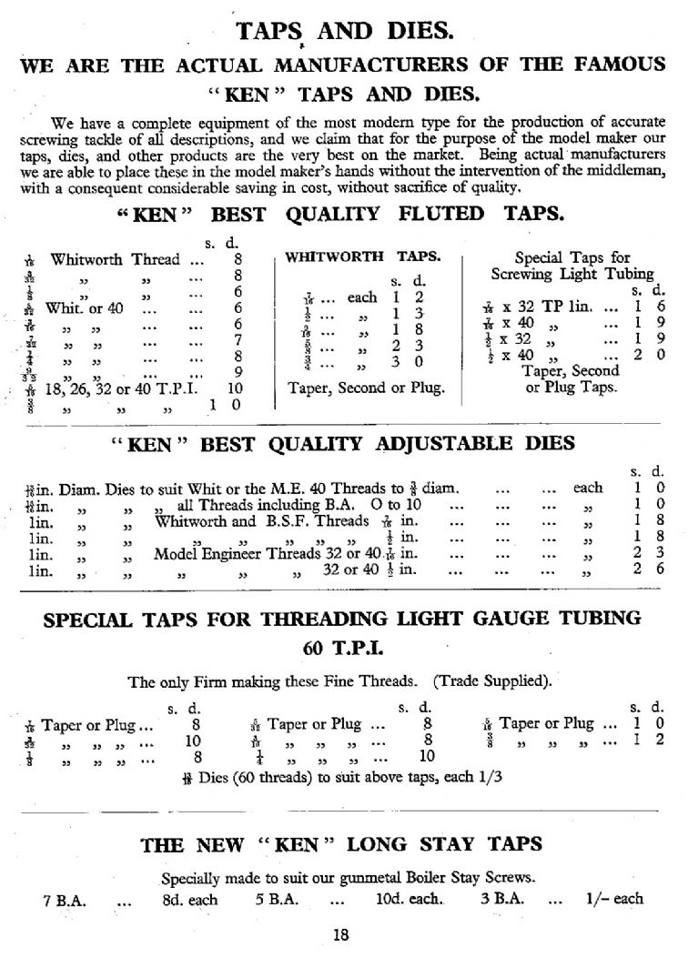

                          Nicholas Farr
                            @nicholasfarr14254
                            Hi, you could get them in 1834 from G. Kennion & Co. who made taps & dies and claimed they could sell theirs cheaper by cutting out the middleman.
                            Regards Nick.
                            P.S. I've actually got a few narked "Ken" that were my father's and do still cut a decent thread.
                            Edited By Nicholas Farr on 21/12/2021 16:24:19
