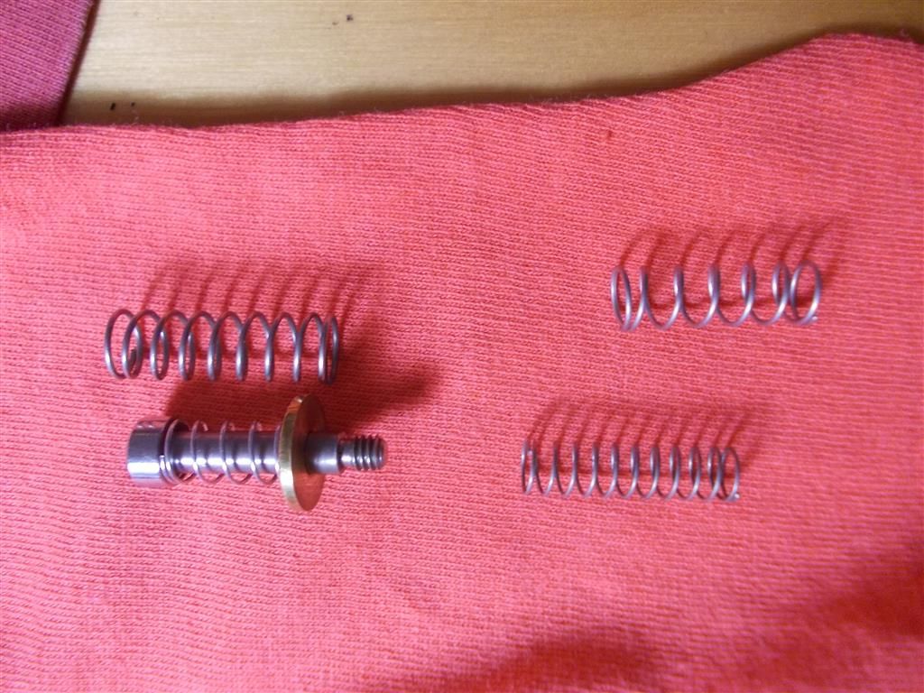

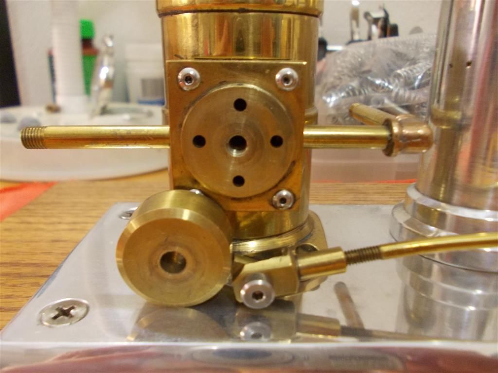

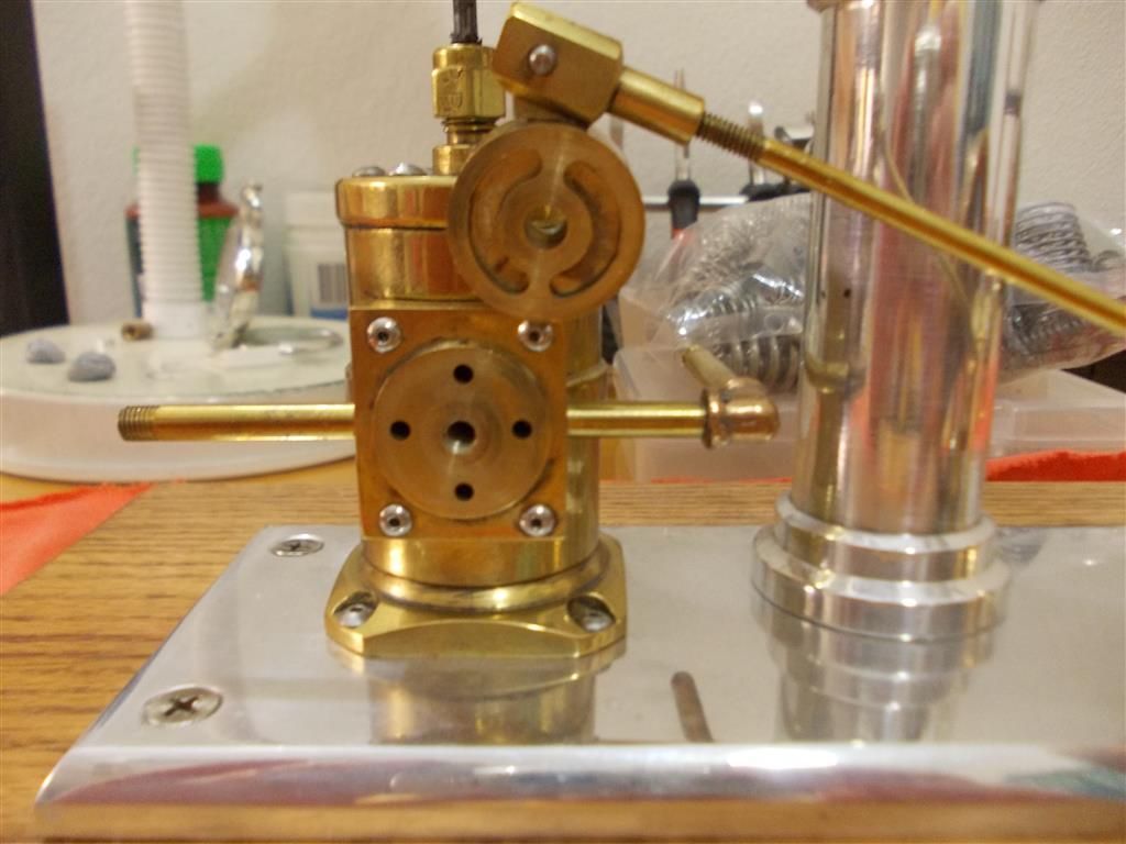

              I have dragged this beam engine out to have a look at it today. The previous owner/ builder had TWO springs on the valve nut. I have found a replacement spring with less tension but I am having problems getting this engine to run at all. I have never fiddled with a beam engine before : how do I go about setting the timing ? I thought I could work it out but after two hours I must admit defeat and ask for help.
              Below are some photos showing the valve arrangement. The bottom photo shows the springs : the original two springs are on the right. He had used one inside the other. I suspect he had problems getting it to run which is why he sold it !

                Looking at the top picture, it appears that if the flywheel is rotated 45 degrees clockwise the beam will be roughly horizontal and the valve will be roughly at the mid-point of its travel.
                This suggests the eccentric is about 90-degrees out from the correct position.
                The starting point should be to have the valve at approximately maximum travel one way or the other when the piston is at its mid point (beam horizontal). The engine should then run and the eccentric can be adjusted to get the best result.
                You are aiming for the valve to open just as the piston approaches TDC, whatever type of steam engine it is.
                The double spring was probably needed to to stop the large rotary valve lifting and leaking with steam pressure applied.

                  Thank you Neil. I have been working on it today and I understand the timing much better ; the engine is running quite well. Plenty of lubrication and a new spring over the valve cover has helped too. The engine will even start without touching the flywheel now. There is still a bit of a clunk/knock but it is nowhere near as bad and I suspect that this is as good as it gets. I have fiddled endlessly with the length of the connecting rods but it does nothing to eliminate it .
