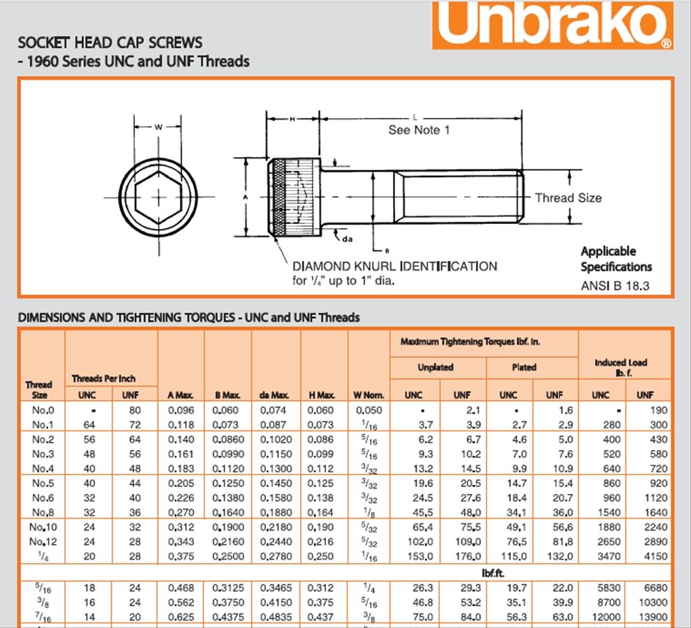

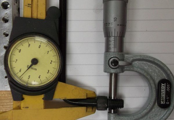

      needing some easy way of linking to a 1/4″ hex I thought of a cap head screw – Harold Hall states in his Metal workers data book states that a 5/16 UNC/UNF accepts 1/4 key – didn’t seem right to me as head wall would be too thin – my examples require 7/16 key – so what size needs a 1/4 key?

          5/16" according to this too

                5/16" UNC SHCS take 1/4" a/f hex key. JD

                  thanks Michael – 7/32 was meant rather than 7/16 but good to know some are observant.
                  one use was to allow an old motor from a defunct woolies electric screwdriver to drive the carriage screw on my small Perris lathe during demonstrations – also thought I could use one as basis of a simple lantern chuck using the many 1/4 bits that I seem to acquired to lock the screw to be doctored.
                  My local specialist fastenings shop is currently on holiday otherwise I’d have tried them armed with the 1/4″ hex bar

                    1/4" key is standard – see chart. Head dia is .46" so plenty of room.

                        maybe I was sold non-standard cap heads (Tim I did mention cap head in 1st sentence of 1st post

                          for the record Bandersnatch's post appears to be a facsimile of the cap screw page from ASTM B 18-3 and should be so recognised.

                              Posted by john brennan 1 on 21/09/2016 19:09:39:
                              Dunno – I copied it from Gould Fasteners "Comprehensive Fastener Guide". No reference to the ASTM spec.

                                5/16" UNC Socket head cap screw uses 1/4" key (there are also a few non-standard cap screws)

                                  In my Pitmans book on aircraft spec bolts AN standard 5/16" UNF uses a 7/32" key, there is no size in that series of bolts, internal wrenching that uses a 1/4" key. I see that the Unbrako bolts use a 1/4" key for 5/16" UNF/UNC bolts.
