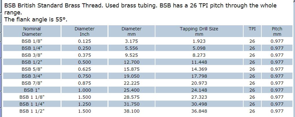

        i have what looks like a Stuart 5 or 7? Vertical with reversing gear. It doesn't have an 'S' on the valve cover. I'm trying to identify the air/steam connector thread size. The internal diameter is 3/16". What thread do you think it might be and where is the best place to buy fittings?
        Many thanks.

          The inside diameter of 3/16" is too small for 1/8" BSP which has an 11/32" (8.8mm) drill size for tapping.
          Possibly a 1/4" BSB (British Standard Brass) thread which is common on brass fittings. (3/16" = 4.76mm)
          BSB uses a Whitworth thread profile with a 55 degree tooth angle. Do not confuse it with an American Cycle thread that has similar dimensions but uses a 60 tooth angle.
          Paul.

            I doubt it is a No 5 unless it's been made with seriously undersize connections as that should use flanged connections with 3/8" clear inlet and 1/2" outlet.
            For the current No7A the threads would be 1/4x32ME which would have 5.6mm tapping size. Not sure if the old original No7 had different maybe 1/4" Whit. In any cast the builder may not have used the specified thread and Stuarts have always used a coarser one than most other makes of steam fittings use so only their fittings will fit. Stuarts list inlet pipe for the 7A as 3/16" and 1/4" on the exhaust

              Thanks guys, glad to see there's no absolute answer. It's definitely 3/16 so not sure.
              Any suggestions for good suppliers?

                3/16" may be the minor diameter but you will need to establish the thread pitch and profile. A bit hard to measure in such a small hole. Try screwing in a piece of round wood and measure the pitch of the marks that the thread leaves. This will establish the tpi.
                Then do a Google search for screw thread specifications and find a match for the minor thread diameter. This will give you the major diameter of the thread. Then you can find a supplier for fittings.
