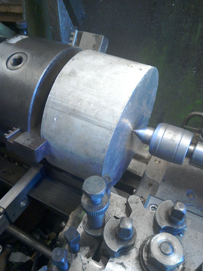

                        Martin Connelly
                          @martinconnelly55370
                          6" diameter bar mounted in my 6" chuck on my 8" machine. This is aluminium alloy as the only 6" diameter iron I have is another chuck.

                            Clive Foster
                              @clivefoster55965
                              Nice picture Martin.
                              A superb illustration of how to set up a larger billet job on a relatively small machine. Especially when it comes to showing the "maximum safe" overhang of the chuck jaws and why you dont try to hold a billet of larger diameter than the chuck from the outside.
                              One for the "1,000 pictures of machining set ups" book that someone really ought to compile for the guidance of newbies.
                              Entirely agree that the job can be done on a smaller machine. Just like you I could happily do so.
                              But with an inexperienced driver I think the larger chucks associated with bigger machines will give a much more secure and safer grip.
                              New guy probably won't realise why you need that centre there with a smaller machine.
                              On a Triumph 2000 or M300 you can safely just have at it. The greater power at the spindle is dangerous but I feel that newbie will be apprehensive at the quantity of chips coming off long before crash time. I know I was ahem "worried" the first time I was shown what a Triumph 2000 can do when in the mood. Major step up from a Pools Special!
