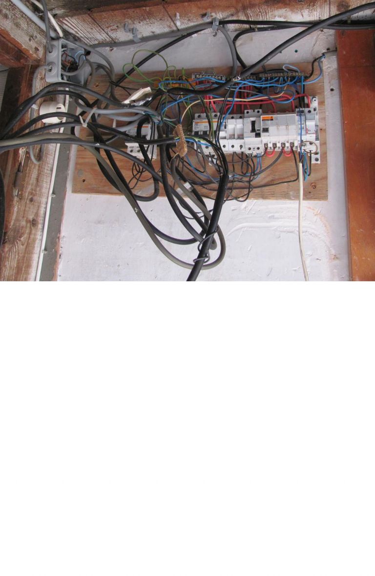

                                            Hi Bob – thanks for that – it hadn't even occurred to me to think of getting the new CU run directly from a new fused supply after the meter. This would also prevent me tripping out the main CU if anything in the garage tripped an RCD – as others have mentioned, that's not ideal, to say the least!
                                            Here is a picture of the old bits in my fusebox – I'm no expert, but to me that looks like an incoming fuse and some sort of resettable breaker…
                                            fusebox I am guessing I'd need to get the leccy board involved to wire up another fused breaker post meter – unless the sparky is mad enough to work on live, unfused mains!
                                            I'm not sure who 'the leccy board' is these days – is it the people I send the money to, or the consumer-facing side of the national grid?

                                                    Hi JoeT, re your picture, that is an early Chiltern or crabtree(?) earth leakage circuit breaker, when you press the yellow test button, it should trip. I only see one earth wire, there should be two, one going to an earth spike, and another going to the consumer unit to provide the installation earth, They work by sensing any current flowing in the earth wire and tripping if this current rises above a pre set level. If you cannot find the second earth wire, there are two possibilities
                                                    1) Your entire house is not earthed!!!
                                                    2) the installation has been converted to PME by the supply authority, but they have not put the PME sticker on the board.
                                                    I am guessing this pic is in a cellar, and the consumer unit is upstairs, can you post up another pic taken from a bit further back and including the meter and also one of the consumer unit. That is a very old fuse cut out, probably mid 1950s, nothing wrong with that, but you need to check your earthing !
                                                    Phil
