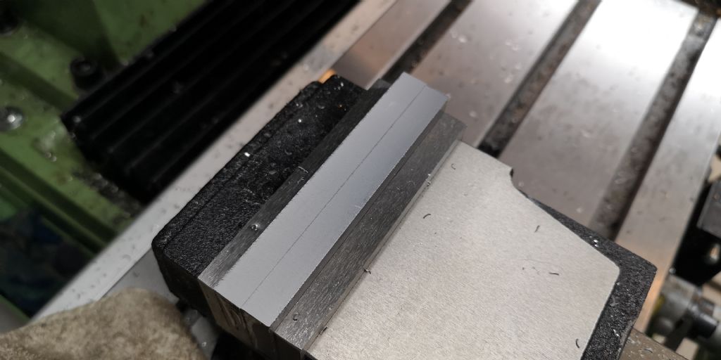

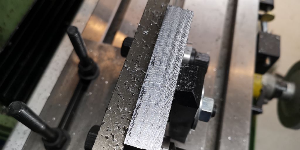

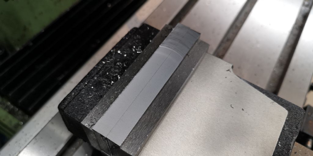

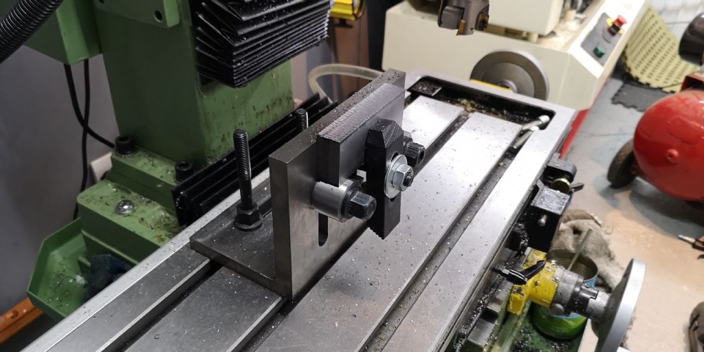

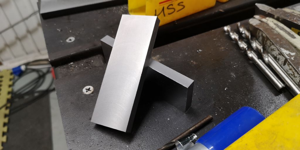

          Lee Jones 6
            @leejones6

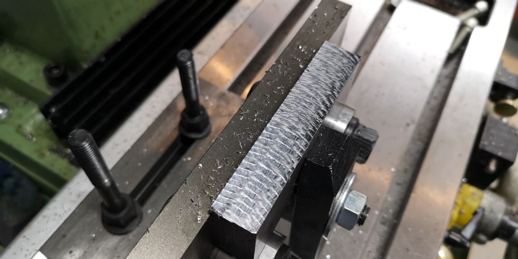

            Hola. Back again.
            Sorry about the delay. Machining was deprioritised for a few months.
            So had a big play today and guess what?
            Well, a picture paints a thousand words:
            TL;DR; Bolted machine down (didn't change much), faster speeds (1000RPM), faster feeds (250mm/m). laugh
            This is how I left it *after* changing to Arc's "known good" inserts – so much for high hopes:
            Thoughts: maybe the setup is janky – too much flex:
            Yuck. Change back to the vise, pronto:

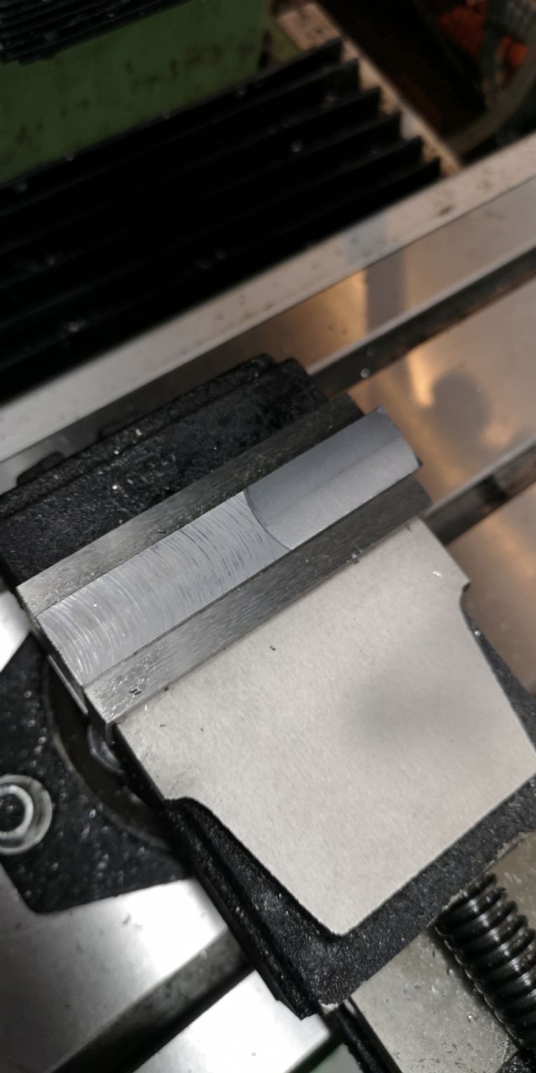

            Ooooo, faster (and don't let the trailing edge catch it):
            Missing test, back edge was trashing the finish, so mill the other way:
            The money shot:
            Pretty:

              Would the improvement gained by changing direction seem to indicate a problem with the tram of your mill? Assuming that the tram is adjustable.
              Mike
              #497888
              not done it yet
                @notdoneityet
                As per Mike. You would likely find the surface is dished (concave). Perhaps not a lot but imagine a wide piece and cutting with a fly-cutter – it would be noticeable then likely preventing you squaring up th part, if that was what younwere wanting.🙂
                #497981
                Steviegtr
                  @steviegtr
                  I did see one article by Hass who said if the cutter is wide enough, do not run it central down the work. Slight offset gives a better cut. I do this now if the piece to be cut is narrower than the cutter, to allow such a cut.
                  Also when the trailing edge of the cutter comes along, does it show a arc on the work the opposite way. Meaning the cutter is touching at both ends.
                  Only from a amateur prospective of course.
                  Steve.
                  #497996
                  Lee Jones 6
                    @leejones6
                    Yes, the trailing edge makes reversed arcs on the way through.
                    And yes, it must mean the head is out of tram.
                    Although when I checked it, it was about 0.02mm over 400mm, which I thought was reasonable.
                    I've since ordered a new DTI holder to re-check it.
                    #498001

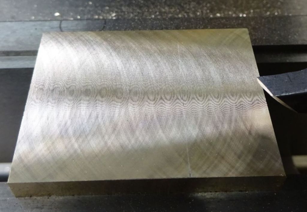

                      Spot on tram will cut on the trailing pass giving an almost holographic look, best way to check if tram is out is to take a cut from both directions, if the trailing edge only cuts in one direction then you are leaning towards the leading edge.
                      As Stevie says you can get a smoother cut by offsetting the cutter as it will keep at least one tip engaged all the time this makes for smoother running particularly if you have any gears in the mill's head.

                        Annoyingly I like the current surface finish, so I'm at pains to tram to 100%.
                        The main issue for me is that it's trammed the wrong way.
                        I'd like the best finish to be a result from pushing the cut into the fixed jaw really.
