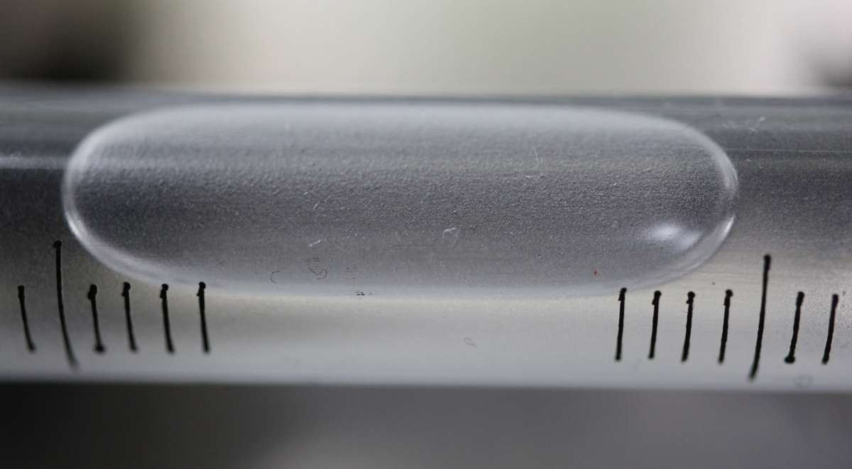

      The minimal bubble, in a plain straight tube, would [in that zenith view] present as something very close to a circle, and if it were somehow elongated would present as a ‘racetrack oval’ with semicircular ends BUT as Nick’s photo nicely illustrates, the curvature of the vial distorts those semicircles.
      It therefore seems reasonable to assume that the bubble in a sensitive level will be less distorted than one  in a general-purpose level.

        I’ve been pondering that too!  And wishing my 3D-CAD and maths skills were much better.
        Comparing Nick’s vial with my model, it’s seen that his real bubble is much rounder than my simplistic model:
        bubbles
        I suggest surface tension is a good thing in that it conveniently rounds the real bubble into a tighter easier to see shape.   The liquid often contains dye, and possibly it’s engineered to optimise the shape too.   (The surface tension of water is reduced by adding washing up liquid.)
        My guess is that the bubble in a barrel-ground sensitive level is distorted in much the same way as a cheap bent tube provided both are on a level plane.  I think the problem with bent tubes is that they distort the bubble when tilted sideways, making them less accurate.  Barrel-ground would be more tolerant of side tilt, I feel, but this is pure conjecture!

                Hi Dave, this photo isn’t directly over the bubble, but I think it shows that there is no real discernible difference in the shape of the bubble, when the vial is tilted to one side, and watching it while turning a full rotation, I couldn’t see it change shape.
