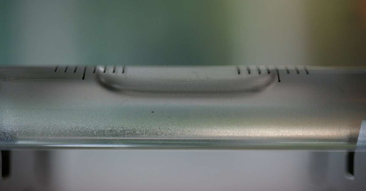

                                    Hi, just to give you an idea, the vial in the photo below is 60mm long and 10mm diameter, I can’t remember the resolution, but it’s not less than 0.005mm /250mm, the bubble is 25mm long. It’s a little out of focus in places, as it was a bit difficult to get it right with manual focus, and auto focus wasn’t having anything to do with it.
                                    IMG_1620-Bubble
                                    Regards Nick.

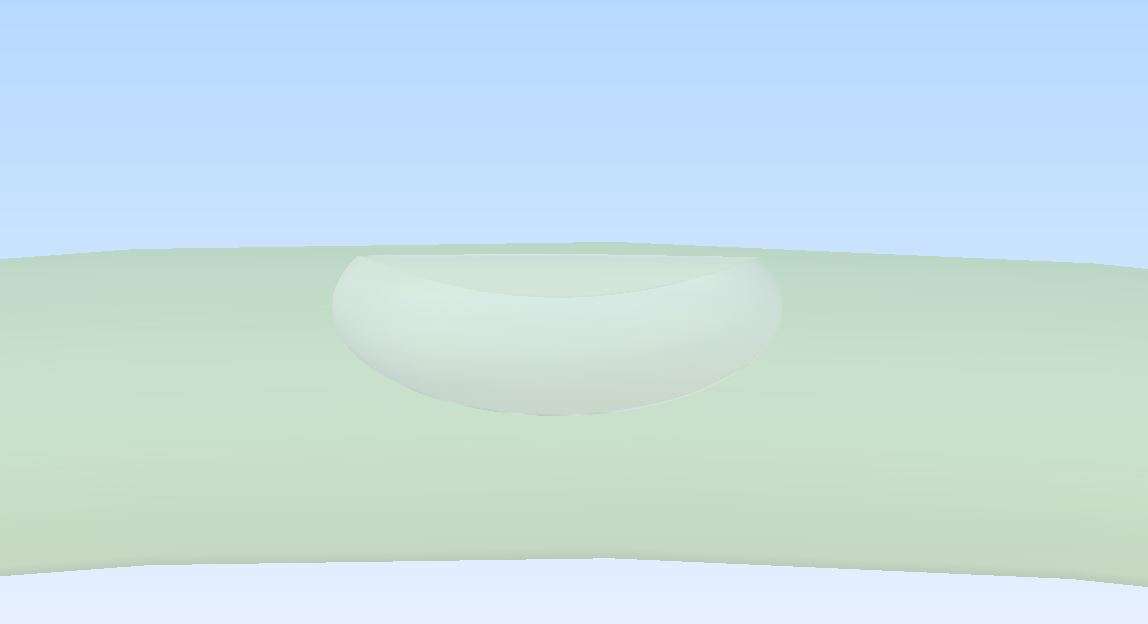

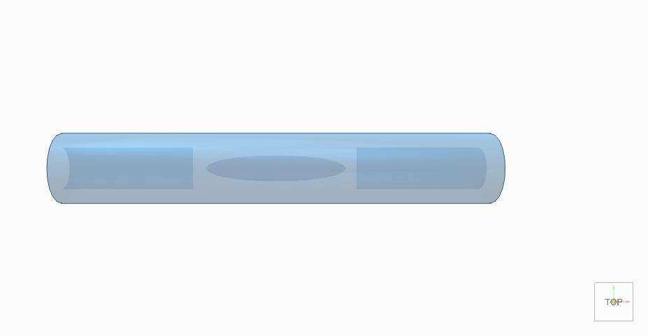

                                                Though I’m not proud of it, this is a promising start with  SolidEdge 2024, using my two ‘easy’ assumptions, which are the top of the bubble is the shape of the tube, and the bottom is flat.
                                                The Vial is modelled as a bent tube, 300mm diameter, material declared as glass to make it transparent.
                                                The inner liquid was modelled by extruding a new square section inside the tube, such that a gap is left inside the tube.   The gap is the bubble.
                                                I expected to be able to colour the flat bottom as a face, but it appears solid edge considers the whole interior to be a face (like a sphere), so I’ve not been able to colour the model effectively.   The software failing to identify the flat bottom as a face, also means I can’t fillet the line to fake a meniscus.   It’s also created two unwanted artifacts right and left by colouring the contents of the tube, which is not wanted.
                                                Like as not my method is flawed because I’ve tried to model the vial and contents as a single body when two are needed.  Might try to make the flat bubble by joining two boolean parts.
                                                Three views:
                                                Top, showing the bubble base looks like an ellipse:
                                                bubbleTop
                                                The side view is less satisfactory:
                                                bubbleSide

                                                      Hi, for anyone who wants a photo of a bubble from above, below is the same bubble as the one in my previous post.
                                                      Bubble 2
                                                      Regards Nick.
