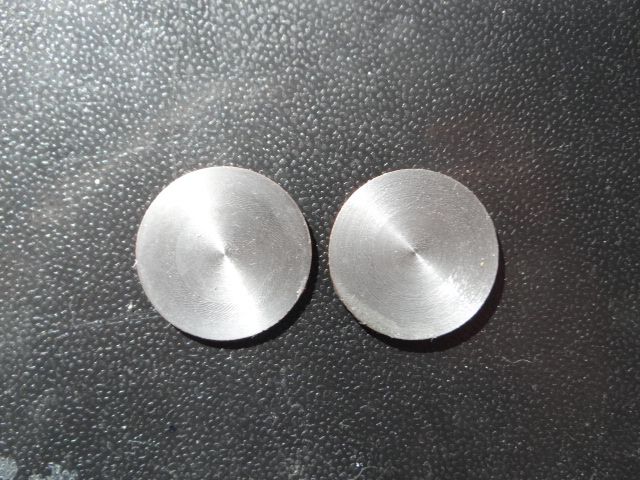

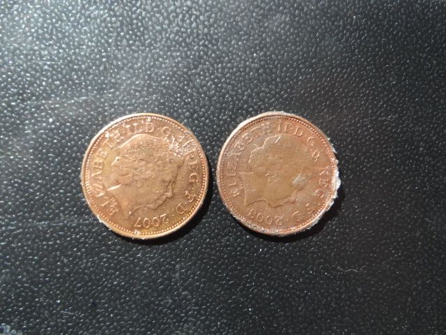

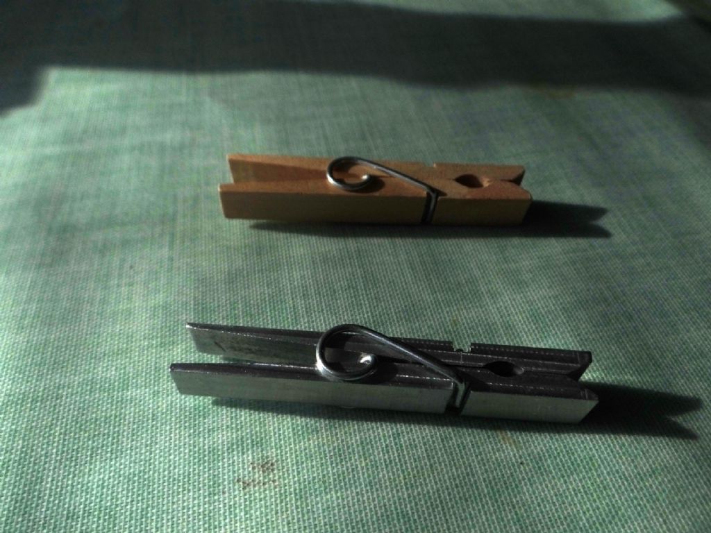

        #271174
          I've not had much success impressing my family. They are an ignorant unappreciative lot.
          This peg got some positive comments:
          This one went down well after reassembly.
          I gave away the real one, but the impossible nut is amusing

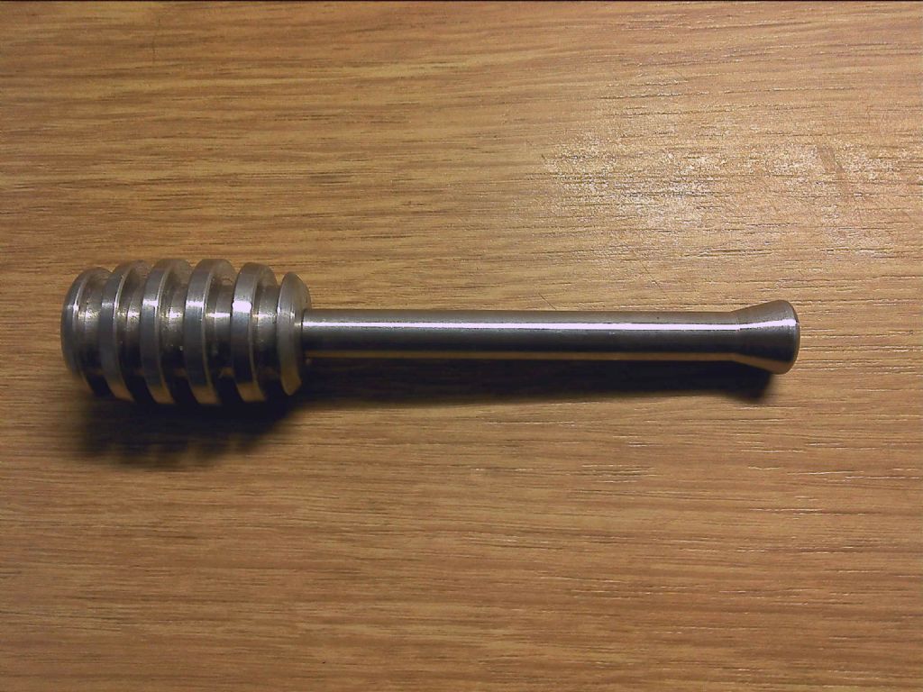

                            Some time ago I found myself in a very similar position. In my case my wife expressed an interest in a honey 'dibber', so I made one from stainless steel—no precision needed at all:
                            By the way, I made the grooves on my Myford using a large parting tool—that was before I learned that was supposed to be difficult!
                            Trevor

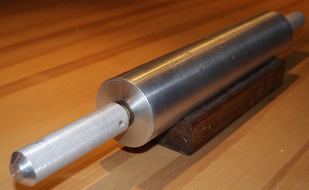

                              Some years ago I made 6-7 Rolling Pins (in Norway it is called a "Kjevle&quot for making flat cakes and pastries (pizza etc.) for all family members. I had some old aluminium tubing, and used ball bearings for easy rotation. It was completed with a hardwood stand. It is a pleasure to use, and only needs a simple cleaning with a moist cloth.
                              To my great pleasure, my wife likes to show the Rolling Pin to guests and I willingly shows them my workshop in the garage!
                              Merry Christmas from Sverre

                                  A honey, 'Drizzle' I think Trevor, I make mine out of Holly wood, as I cut down a male Holly tree ( No berries) and seasoned the wood for a long time and it turns very nicely.
                                  Clive
