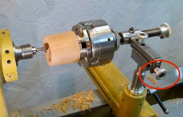

      I’m thinking of making a jig to cut threads on my wood turning lathe.There are a number of commercial units on the market and I’ve noticed that some of them have a “click stopped” dial for advancing the cut. It’s not that important to me how many clicks are required for a given thread but I’m intrigued by the numbers I’m seeing in the description:
      A 20 TPI thread needs 3 clicks,
      16 = 5
      14 = 7
      12 = 9
      I can’t seem to work out what the likely thread pitch is used on the adjuster? The cutters are 60°
      This is the type of jig. The click stop adjuster is circled in red. Any ideas?

        You can look up the single depth of thread for any pitch of a 60 degree thread.
        You can find or derive a mathematical expression that says d = x/p where d is the single depth, x is a number based on the thread geometry and p is the tpi of the thread.
        An example chart for UN form threads is here:
        https://kb.wisc.edu/engr/teamlab/page.php?id=81932
        If you take the numbers from that, and divide the 20 tpi single depth by three, you get a number that is double that which you obtain if you take the 12 tpi single depth and divide it by nine.
        You can also see from that chart that no integer threads per inch number will work on a feedscrew, because the numerator for the fraction they give for the single depth is not a ‘nice’ number.
        You can also also see that if the feedscrew had a pitch of 10tpi and a dial graduated in 100 divisions or 100 ‘clicks’ (i.e. one division is 0.001″), 20 tpi would need 32 clicks, 16 tpi would need 41 clicks, 14 tpi would need 46 clicks and 12 tpi would need 54 clicks.
        On that basis, something smells fishy.
        However, we do not know if the device is made for UN (flat-crested) threads or sharp 60 degree threads, so reacalculate based on sharp threads (a much easier exercise for your brain than doing so for a flat-crested item), and see what you conclude.
        Can you link to the device’s product description.

          Does the click adjuster have to be threaded, could it be a face cam correctly spaced steps ?

              All the units I’ve seen have a threaded adjuster.
              When you read the review of the bestwoodtools one, the reviewer talks in terms of measurements in thousandths of an inch of infeed for the thread he is cutting. You can also see from the pictures that the dial on that one has finer graduations than ‘clicks’. That is a way of using it which is closer to how you would cut a thread on a metalworking lathe.
              The eBay one has problems with describing the product: in the first paragraph it cuts 16 tpi threads; in the second it cuts 10 tpi threads. When you post an eBay link, it creates less clutter if you delete everything after and including the first question mark in the URL.
              Woodworkers do not work in the same manner as metalworkers. All the clicks do is to ensure that the depth of the internal and external threads are the same. The actual numbers given have probably been arrived at by trial and error – they work OK for the pitches listed. The threads thus produced will not match any international standard.

                          The thread tpi is determined by the screw thread sticking out to the right. The depth of the thread is determined by the number of clicks. To do a coarse thread you would have a coarse thread feed screw and that coarse thread would need a deeper cut to avoid truncated threads. I think you will find that either there is a kit with multiple feed screws or you can buy/make different feed screws for the thread you want to create.
