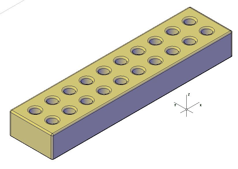

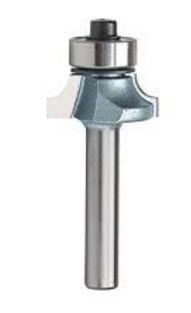

                                            #313199
                                              Clive, can I ask what you do about fine cast iron dust or any small particles of swarf carried by cutting fluid?
                                              #313207
                                              John McNamara
                                                @johnmcnamara74883
                                                Hui Clive
                                                I would use MDF or better still a good chunk of dressed timber.
                                                An array of drilled holes is easy to do, the only difficulty is that the top edge of the hole is likely to be chipped by the act of drilling or inserting tools in the holes.
                                                If you have a wood router the trick is to use a 2.5 – 3mm radius cutter to round all the holes and the corners of the block. This will remove any chipped edges and stop the edges chipping when inserting and removing tools. These days small sets of cutters are very inexpensive.
                                                5 minutes with the router and you have a nice looking and functional block. a couple of coats of polyurethane varnish will finish it off.
                                                See two images below
                                                Regards
                                                #313263
