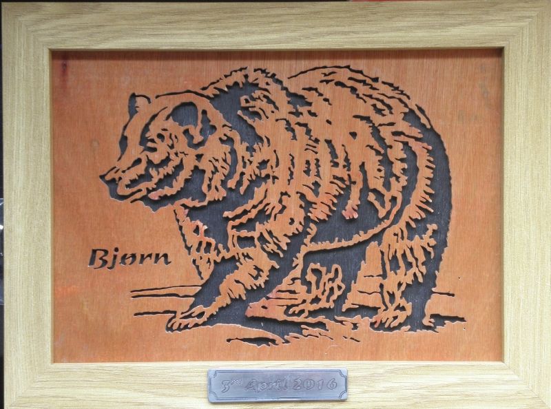

                bjorn-final.jpgPosted by XD 351 on 02/01/2018 19:22:16:
                Colin ,Joseph and Neil thanls for the reples !
                Colin , i have just had a look at those engravers and for around $700 au they would do 99 % of what i will ever need which is mostly pc boards and plastic lables do you think they are capable enough to make brass name plates using a small 1.5 a- 2mm end mill?
                With the router i was thinking more along the lines of being able to machine holes in plastic and alloy up to 2mm thick for plastic and 1 mm for alloy to make front panels for some projects and carving out recesses in timber engine mounting boards etc , i currently do all this on my mill so not something i'm dsperate for !
                Ian.

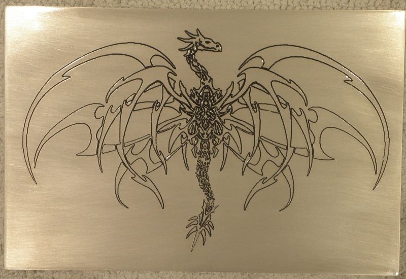

                Hi Ian, – yes they will easily do PC boards and brass name plates – not sure about the plastic lables – depends on how hard it is – the tool may tend to melt lesser plastics. Just to show the capability of these machines, see attached "dragon" engraved on mild steel plate and a scroll-saw picture with a name label in stainless steel made for a Danish friend's son (Bjorn). I went against my previous recommendation to start off simple with the "dragon" this was one of my first attempts. I'm currently trying to do copies of old-time engravings with interrupted horizontal lines defining the image – the problem I have is trying to get the G-code to just do a single line rather than the outline of the line – this is more a design problem rather than a CNC machine problem.
                Colin

                  Will do both of these – just need to apply same techniques as for small mill machines – don't try to do too much at once – the router/engraver motor is not built for strenuous loads – neither are the engraver bits and end-mills that you can use with these machines. But this can all be set up in the design and operating CNC software – then just leave the machine to get on with the work while you go and have a cup of tea. I've found it easier to work with steel than aluminium – latter tends to soften and clog both the path of the machine and the tool-bits. Coolant can help but difficult to apply to flat sheets without constant supervision. Wood is no problem and you can make some impressive 3D pictures in wood with these machines.
                  Colin
