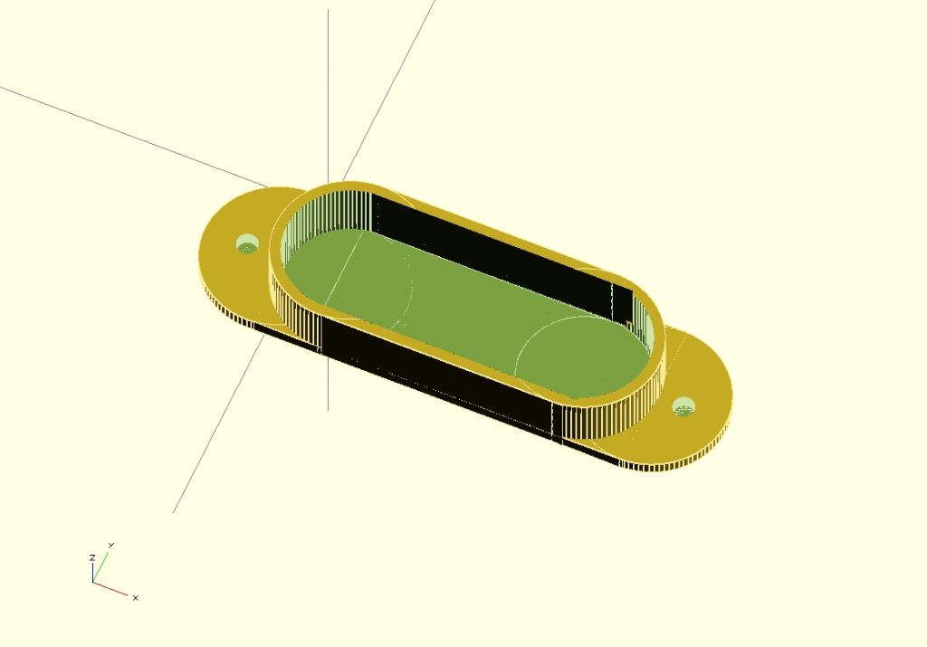

                                                  Just an update on recent 3D printing experience. I thought I was doing very well with my ABS printing until I tried to make an open guitar Pickup Cover for a Uketele project (It's a Ukelele with a solid Telecaster body for a friend's young son). All seemed to go well with my normal hairspray adhesive coating to the heated bed at 100 deg C and extruder at 230 deg C. First few layers all OK – but as the sides built up, the ends were beginning to curl away from the heated bed – eventually the whole build detached from the bed and followed the nozzle around the table in a sort of Viennese Waltz. My conclusion is that the bottom layer was lacking in material to adhere to the bed. My solution (although I haven't yet tried it) is to infill the bottom layer with a thin but extensive rgion to provide the adhesion – this infill will then be cut out afterwards. The photo shows my OpenSCAD drawing of the pickup cover with the infill region (the light green region at the bottom of the "walled" area). I'm also waiting for some Kapton tape to arrive – will give that a try as also the diluted PVA glue approach. I'm told that "Purple" glue Sticks also work as a bed adhesive – anyone know what these are?uketele_pickup_open_cover.jpg

                                                    Hi Colin, the geometry of your part may have contributed to the peel-away. All thermoplastics shrink on cooling, whether 3D printed or injection moulded. The oblong ring may have shrunk inward as every layer was added, which will distort the ends upward since there is more "pull" from shrinkage along the straight sides. This might be mitigated by using a raft outboard of the main part. What I mean by raft is a ring of sacrificial material a few layers thick spaced away from the part, following the outside contour, but with a gap to the main part and joined to the main part only by a few narrow spokes of material. The raft will stay attached to the bed well since it has little shrink to induce it to peel away, and as the build continues the spokes will hold the main part in place even if main part peels away a bit.
                                                    Other strategies to help reduce warp and shrink effects with 3D prints:
                                                    -thinner vertical walls
                                                    -slots in vert walls if designs permit
                                                    -if you have control over 'honeycombing' density of the walls, make honeycomb less dense
                                                    -pause printing for more cooling / stress stabilization between layers
                                                    Hope these ideas help. Merry Christmas to all forum members.

                                                      Colin – if using Cura tell it to provide a 'brim' – it's exactly what you have done, a single layer all round the part (inside and outside), you decide how many rings. Easily peeled of and tidied with a craft knife (I use a deburrer).
                                                      I now use a brim whenever I do a print with the slightest risk of peeling or coming loose. A few minutes more print time, far fewer failures.
                                                      I find the dilute PVA is much, much better than hairspray. If you have trouble releasing, let the part cool fully, then wait another 20-30 minutes and a blade under one corner will make it pop off.
                                                      Purple glue sticks are Pritt with a dye so you can see where you have put it that dries transparent. Ordinary glue sticks work fine.
                                                      Edited By Neil Wyatt on 22/12/2017 14:25:57
